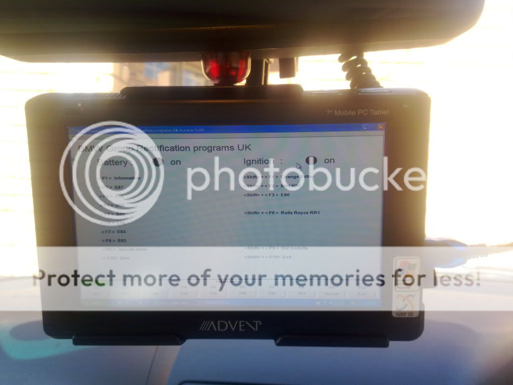

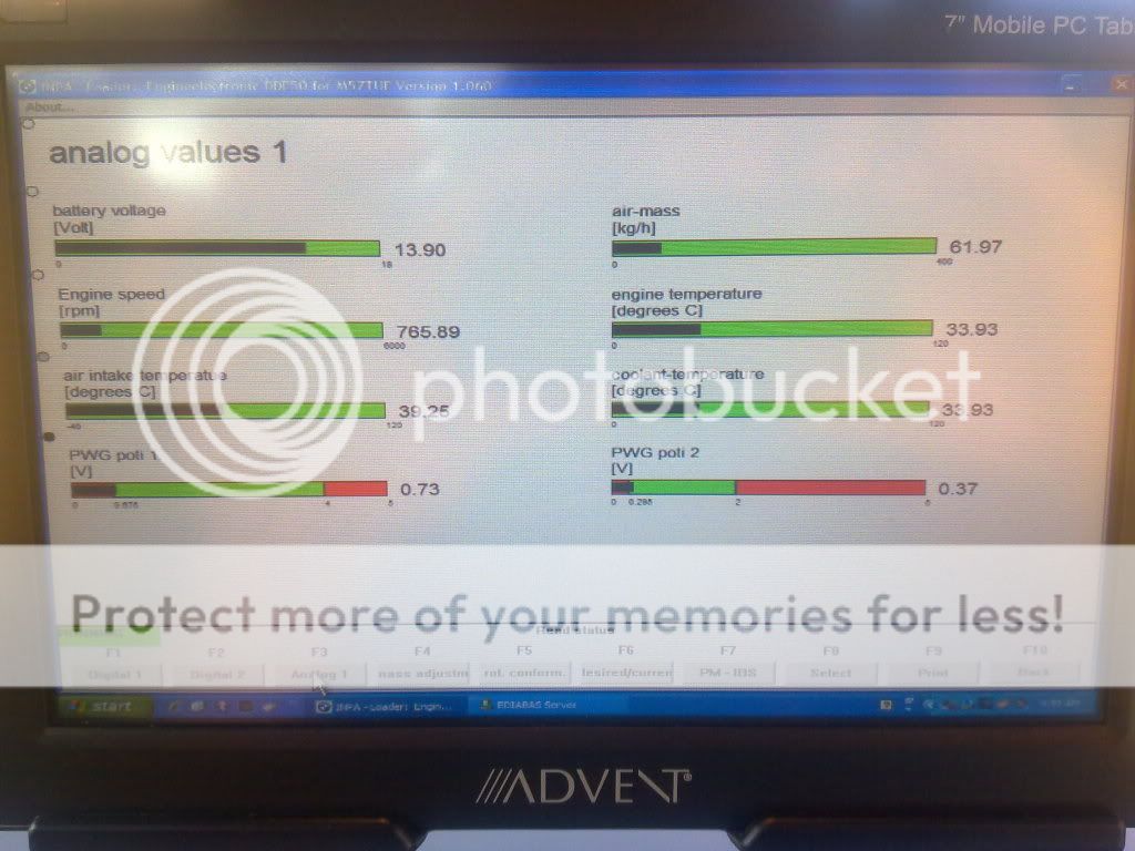

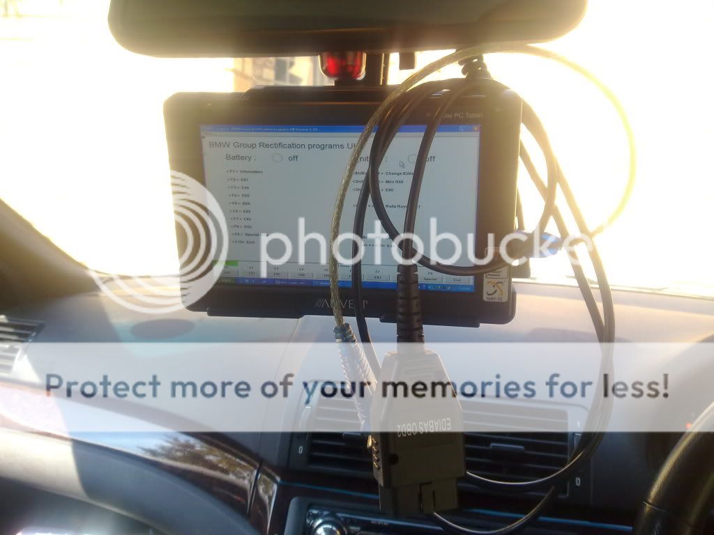

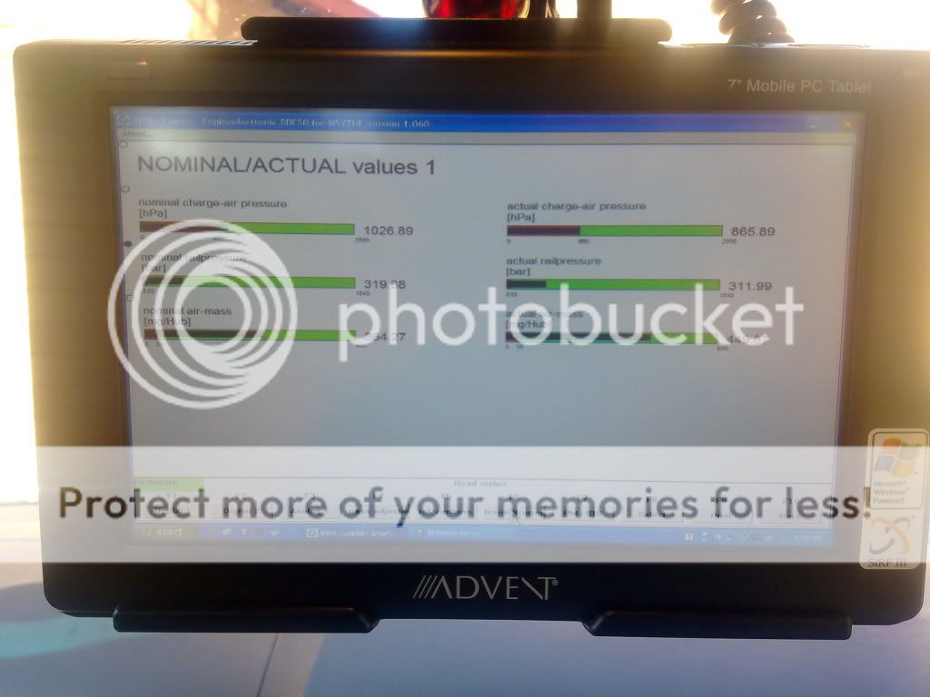

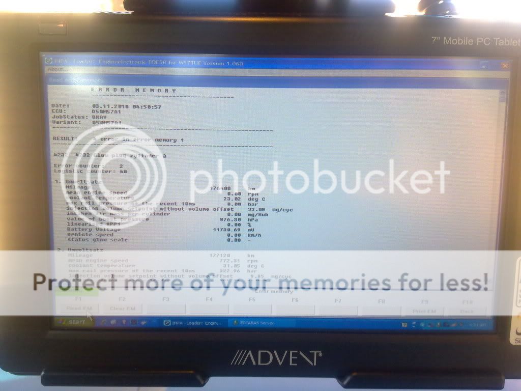

was bored, so i thought i would post a little example of how INPA can be implemented for referance..
i have the working version off the net running on a car-pc , using a usb to serial converter, together with a 30$ ebay INPA interface.. brilliant for on the move or home diagnostics
