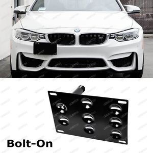

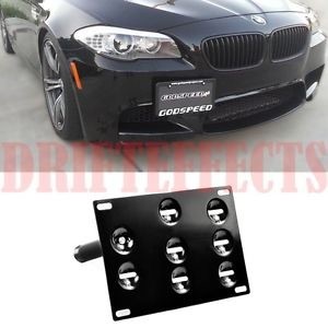

buy a jdm number plate adapter, it fits into the tow hook adapter
Tow hook adqpter?
