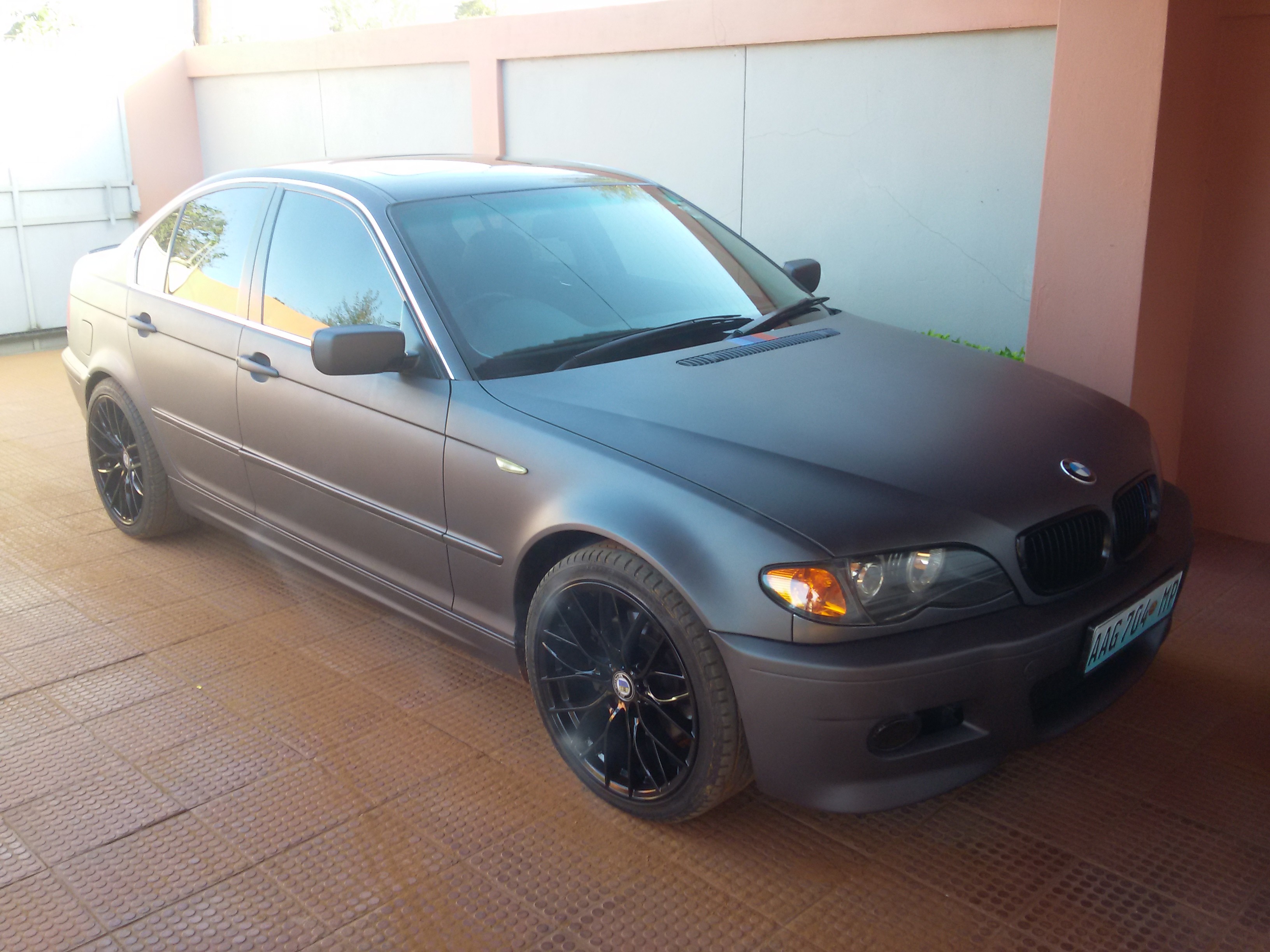

Here she is btw.

That key does not belong to a facelift e46. What year is your car as I suspect it maybe a 1999 model that had a front end smash and facelift parts were used to fix it.

It's a 2002 model but imported to Mozambique because that is where I am currently staying and working. Most of the writing on all the covers are in Japanese etc.
This is the info from the VIN number:
VIN long xxxxxxx
Type code ET36
Type 325I (EUR)
Dev. series E46 (4FL)
Line 3
Body type LIM
Steering RL
Door count 4
Engine M54
Cubical capacity 2.50
Power 141
Transmision HECK
Gearbox AUT
Colour TITANSILBER METALLIC (354)
Upholstery STOFF JACQUARD/ANTHRAZIT (H9AT)
Prod. date 2002-08-22
