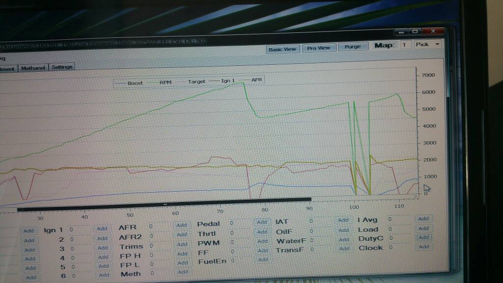

Ran some logs last night. Not sure what to look for but boost target is normal and boost is flat 0. Pwm is flat on 7500.
Is there any place I can take the car to check except dealers. I am based in the east rand.

hoosain
Sent from my SM-N915F using Tapatalk
please post log
maybe we can assist in reading it for you

So I replaced the vacuum pipes that runs over the motor and also the manifold vacuum pipes, still no boost.
I then bypassed both solenoids and manage to get 4psi boost with target at 12psi.
Could not export the log but will try again tonight.
Could only take a picture for now.
