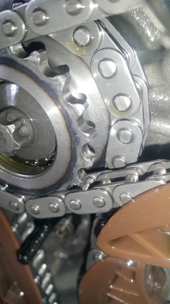

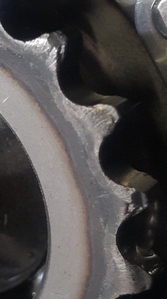

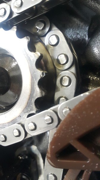

This past week, I had the engine removed ONCE AGAIN to see what was going on and found the high pressure oil pump sprocket was out of alignment, convinced this was the issue, re-torqued the pump bolt, aligning the sprocket and chain, but NOPE, still the same issue,
Anywhere else I can look?

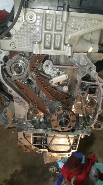

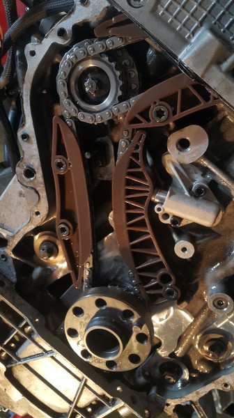

Some pictures of the engine and the most recent chain alignment issue.
