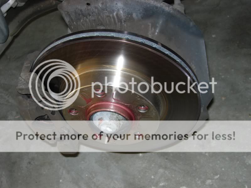

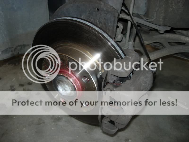

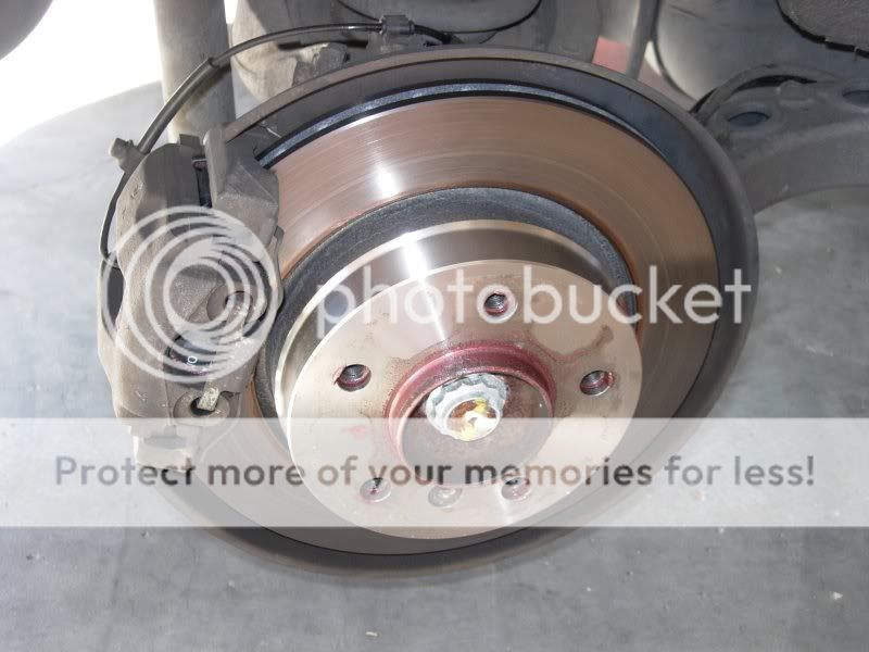

2.) Okay, back to the brakes. Wanted to stick with ATE disks and pads and eventually got a very good price from Midas. Paid R2670 for front and rear disks, pads and brake wear sensors! Agents wanted almost R3000 just to do the rear brakes! And they also use ATE as far as I know...

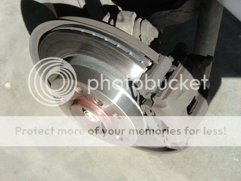

All done, now just a bit of a clean up. Had to used loads of "gentle persuasion" with the hammer and penetrating lubricant to get the first disk off - the rest were the same process.
So, all four disks replaced and new pads all around, new brake wear sensors, copper slip on the backs of the pads and wherever some lubricating is needed, bolts etc.
Took the car for a drive to get the disks and pads to gently agree with each other, then went to my personal testing stretch and gave it a few up to 100 km/h and then hard braking until I smelt hot brakes, then gave them a cool off without allowing the car to be stationary, so no chances of heat soak.
Can already see that the cross-hash on the disks are practically gone, although there is still the rougher sounding noise when braking, so I reckon a few days and it will settle.

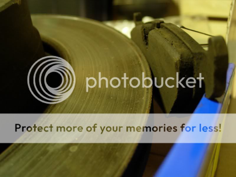

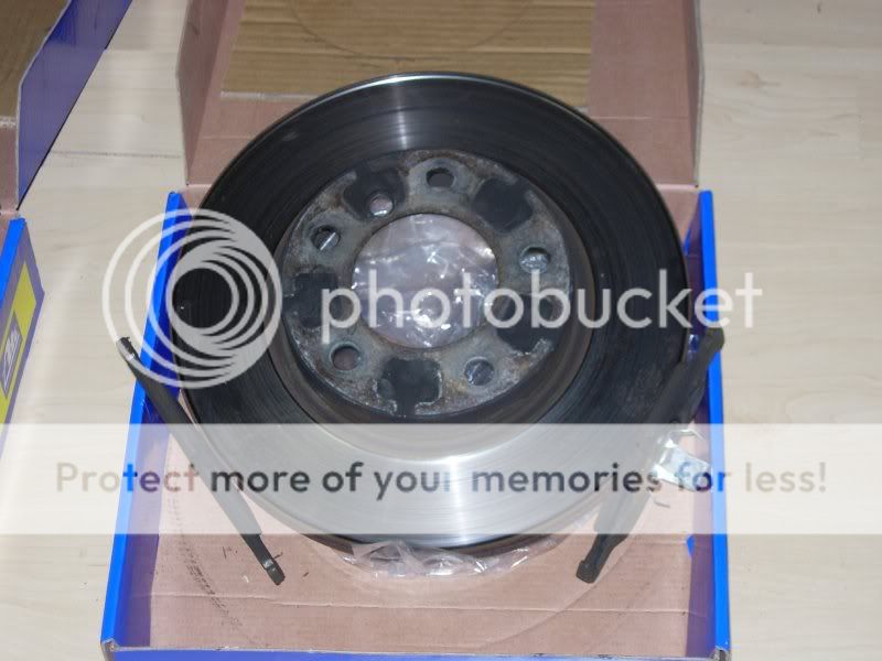

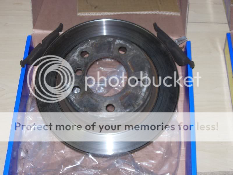

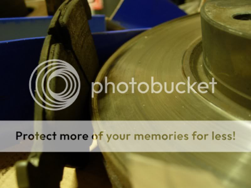

Will take some pic, more specifically of the old disks and pads - the rear disks were very worn, but the front pads were particularly worn and the disks too, so made sense to do all four in one go!
