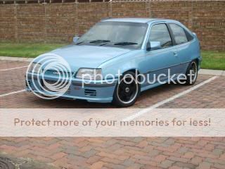

So Oct marked 11 years that I own the car, its a 1992 superboss, estoril blue. I am the 3rd Owner of the car.
Since owning the car its been through a lot of changes.

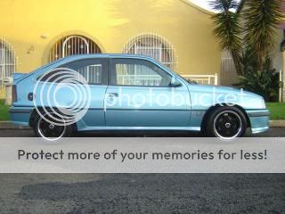

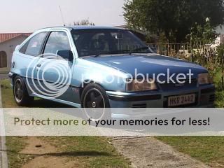

This was the car when I got it.
The car was stock standard, it just had a branch and exhaust, car ran well, but after 3 weeks, it ran bearings and that's when the nightmares started, had a mechanic in Ladysmith that worked on the car, and it was just issue after issue, and in the process I went through 2 GM heads, one was from OPEL ASAP and that head was over skimmed, bought another head and that lasted around 3months before that head broke.

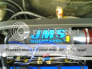

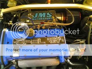

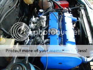

It was then that I decided to scrap this whole idea of fixing there car in ladysmith and towed the car up to JHB where I had JMS re-do the entire motor, new head, re-bored the block, new pistons, M3 Throttle bodies, 4Fogger Nitrous with a NOS RPM Activator, Found a CosCast head that was flowed ported and match ported to the adaptor plate, changed the cams to 288Shricks, high rev kit(titanium retainers etc etc), 63MM TNT exhaust one box(it roared like a lion lol), a custom plenum was made for the throttle bodies, a MR Turbo fuel management took care of the fueling and a full MSD Ignition 6AL was installed.
This was the end result
Stevens workmanship and attention to detail is amazing.

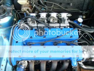

It wasn't long after that when I decided to relocate to JHB and found myself at Turbo Boost Tech (Dion Kitchenbrand) where we fiddled a bit and decided to remove the plenum and fit the Original M3 trumpets which left us with this
the car got much louder and the throttles screamed like a bike..

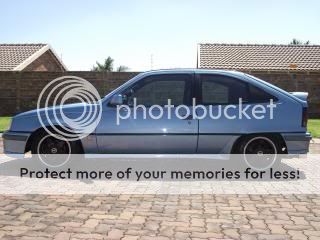

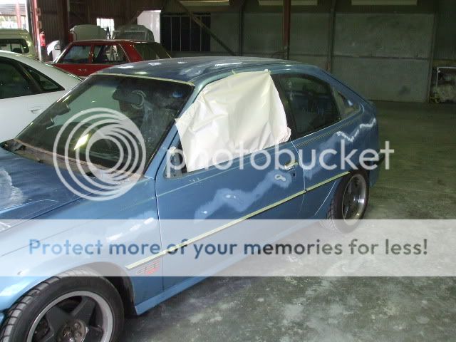

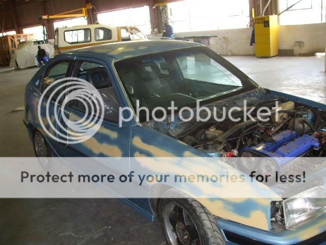

Not too long after all of this, some retard decided to key the car and I was forced to re-spray the entire car, was really disappointed as the car was never sprayed.
this was the car after been sprayed, just a few odds and ends were left to put onto the car before I picked it up..

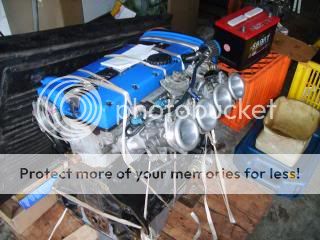

The car went well, much louder than the M3 throttles, but I didn't even get the opportunity to run this setup on the dyno when I had a sweet deal to swop the existing motor for a turbo setup, so this was the motor before been shipped off..
So I needed to buy a lot of stuff as the motor was only coming with the forged block, head, intake and a few side parts, I still needed to buy the normal stuff, intercooler, turbo, waste gate etc etc..

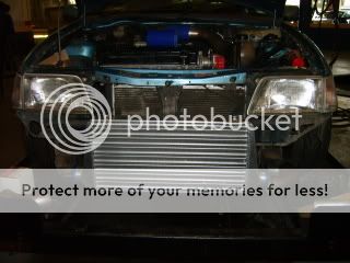

so off it went for the intercooler and boost pipes, this was done on a real tight budget at the time to accommodate the turbo that I wanted.. The turbo was bought from Fastec, a hybrid T3T4 turbonectics/Garrett
Jans branch manifold with my excel wastegate
76mm boost pipes

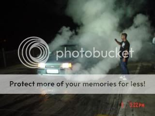

On street tyres with no LSD at Tarlton the car ran 14.1 @ 169km

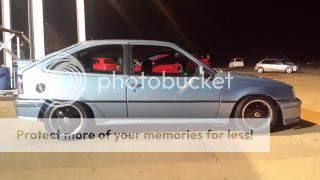

Since the pix I have done a few upgrades, I have removed the Xcel Waste gate and fitted a Turbonetics Waste Gate, fitted a set of 1000cc injectors, Warlbo Fuel pump, AutoMeter Boost Gauge...
Still have loads to do on the car
So I had the car tuned some time ago, made a 290wkw on the wheels at 1bar with 476nm...

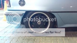

I have replaced springs and shocks all round and replaced front wheel bearings and hubs..
I have fitted HnR springs(really soft spring, will be replacing it) and went to tarlton this fri..
Car ran a 12.9 @ 183km/h
the clutch is in its moer and the tyres were completely DEAD...

here are a few pix of what it looks like with the HnR spring

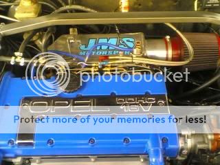

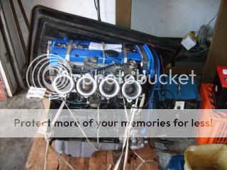

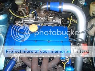

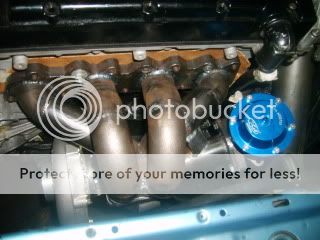

76mm boost pipes

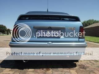

after the 76mm exhaust from power pipes
