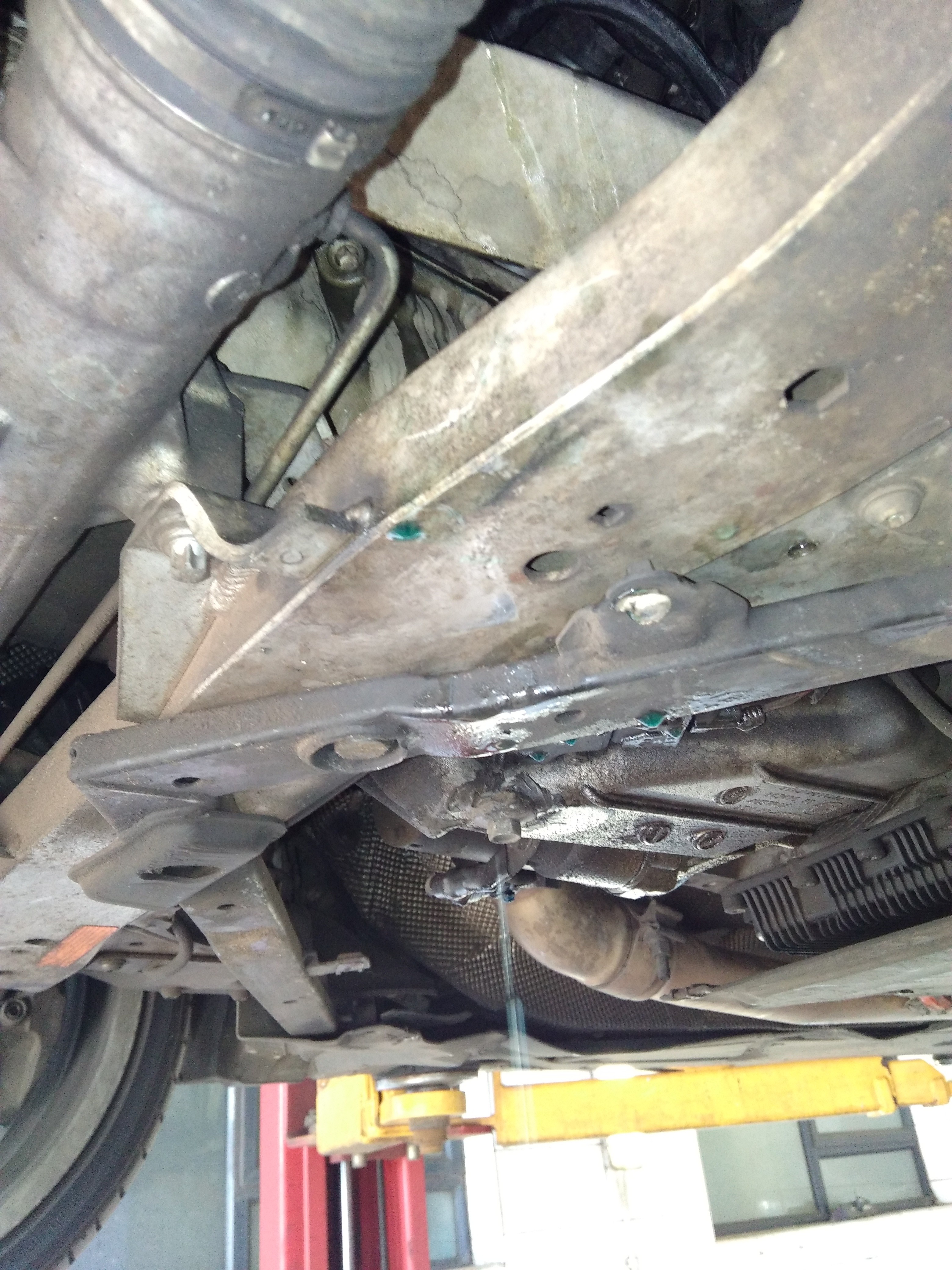

So due to a breakdown. I managed to do a coolant flush that had no plan on doing any time soon.
Last weekend I was greeted by a coolant leak, from my investigations I noticed that the housing for the heater return pipe that connect to the engine block was cracked and which also looked like the pipe that connects to the housing was also leaking.
I got my hands dirty and tried to remove the pipe from the housing with hopes to temp fix it with some good old faithful epoxy and silicone. This sadly did not go according to plan, I removed the pipe only to find that the connector piece of the housing was broken inside of the pipe. I knew at that point that expert touch was needed. Got the car towed to the local mechanic, order the housing and pipe that was required. The housing I received the next day, unfortunately the pipe needed to be shipped in from Germany. Long story short, the mechanic installed the housing to the block and removed the broken part from the pipe and used the old pipe as a temporary measure until i receive the new pipe, hopefully this coming Friday :rollsmile:
I am hoping on getting the engine steam cleansed this weekend and have an inception for the oil leaks i previously mentioned while the new pipe gets fitted at the mechanic.
This whole ordeal left me without wheels for an entire week and i cant begin to explain how much i missed my car during this time .

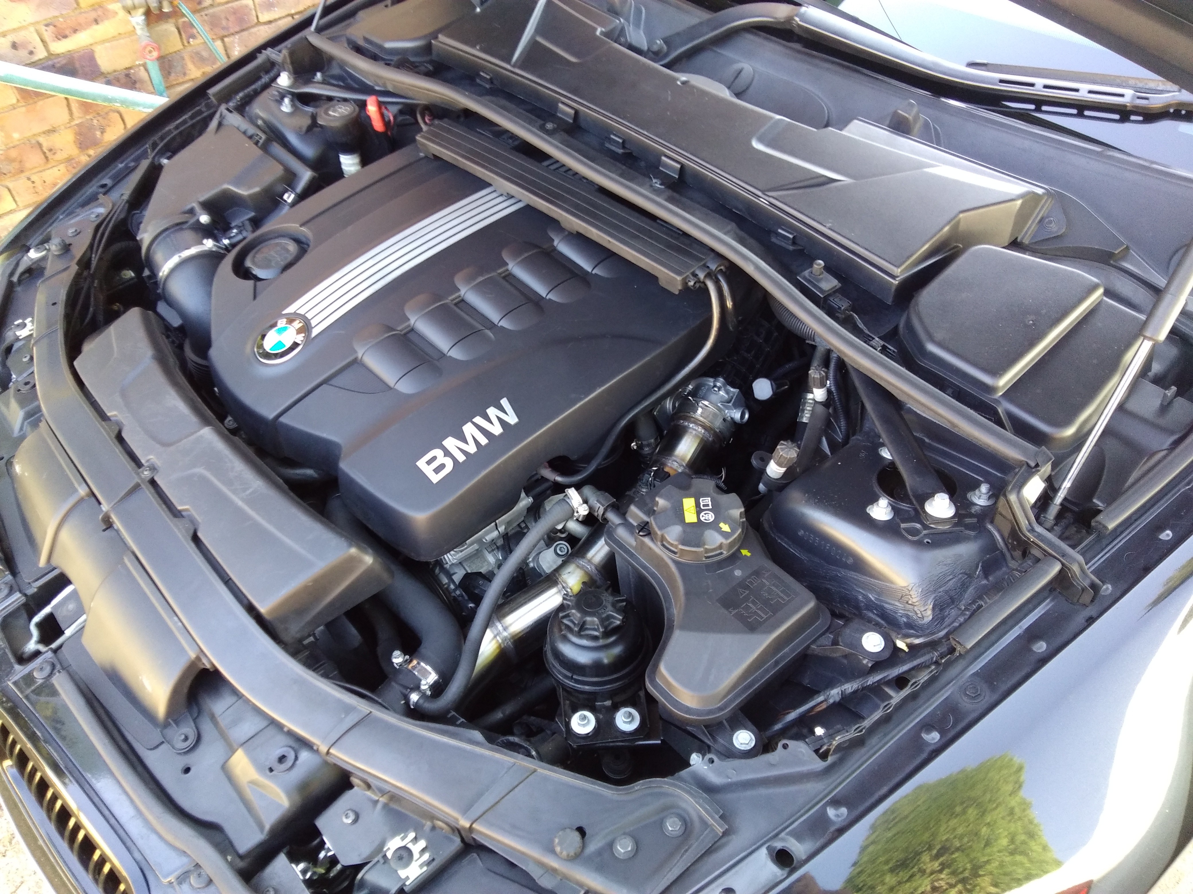

Another late update, but better late than never I guess.

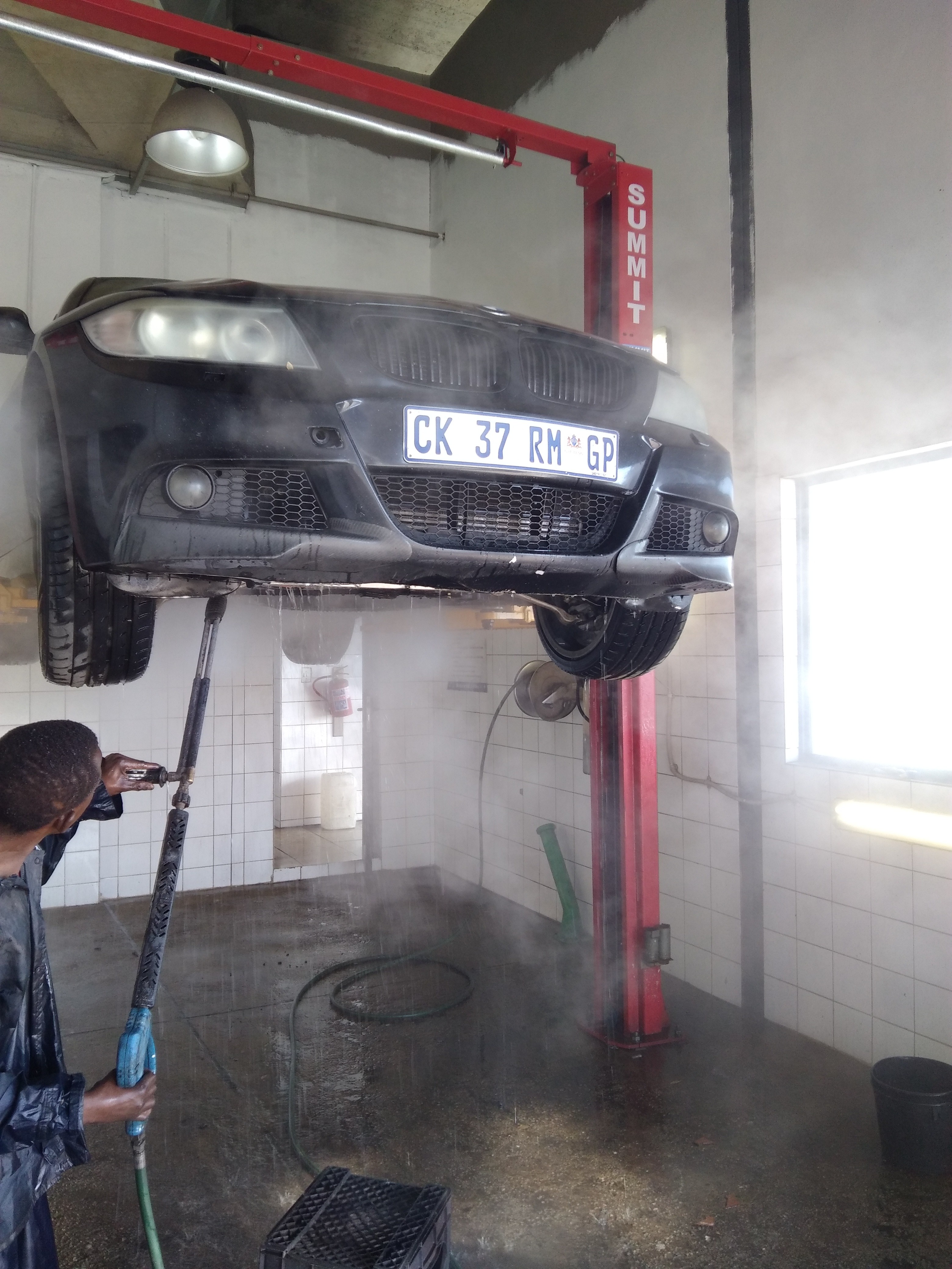

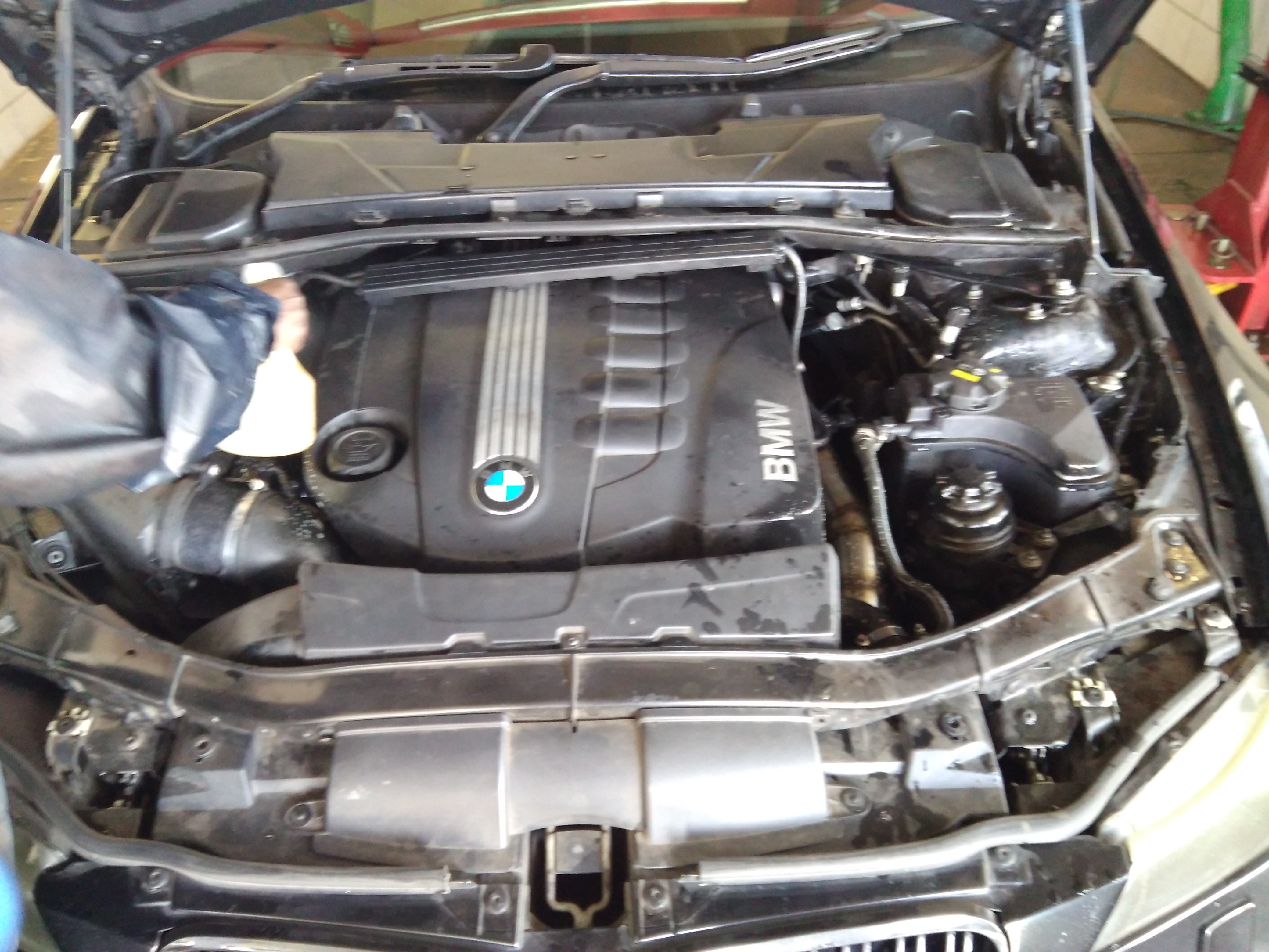

In June I got the engine bay steam cleaned. Took the car back to the mechanic and there was no visible oil leaks found.
In July she clocked 270k km :rollsmile:
August, she went to John for an oil change and I fitted a new oil level sensor as my old one was starting to act up. Yes I know that the car has a dip stick but I could not leave it as is, knowing something was not working the way it should bothered the crap out of me.

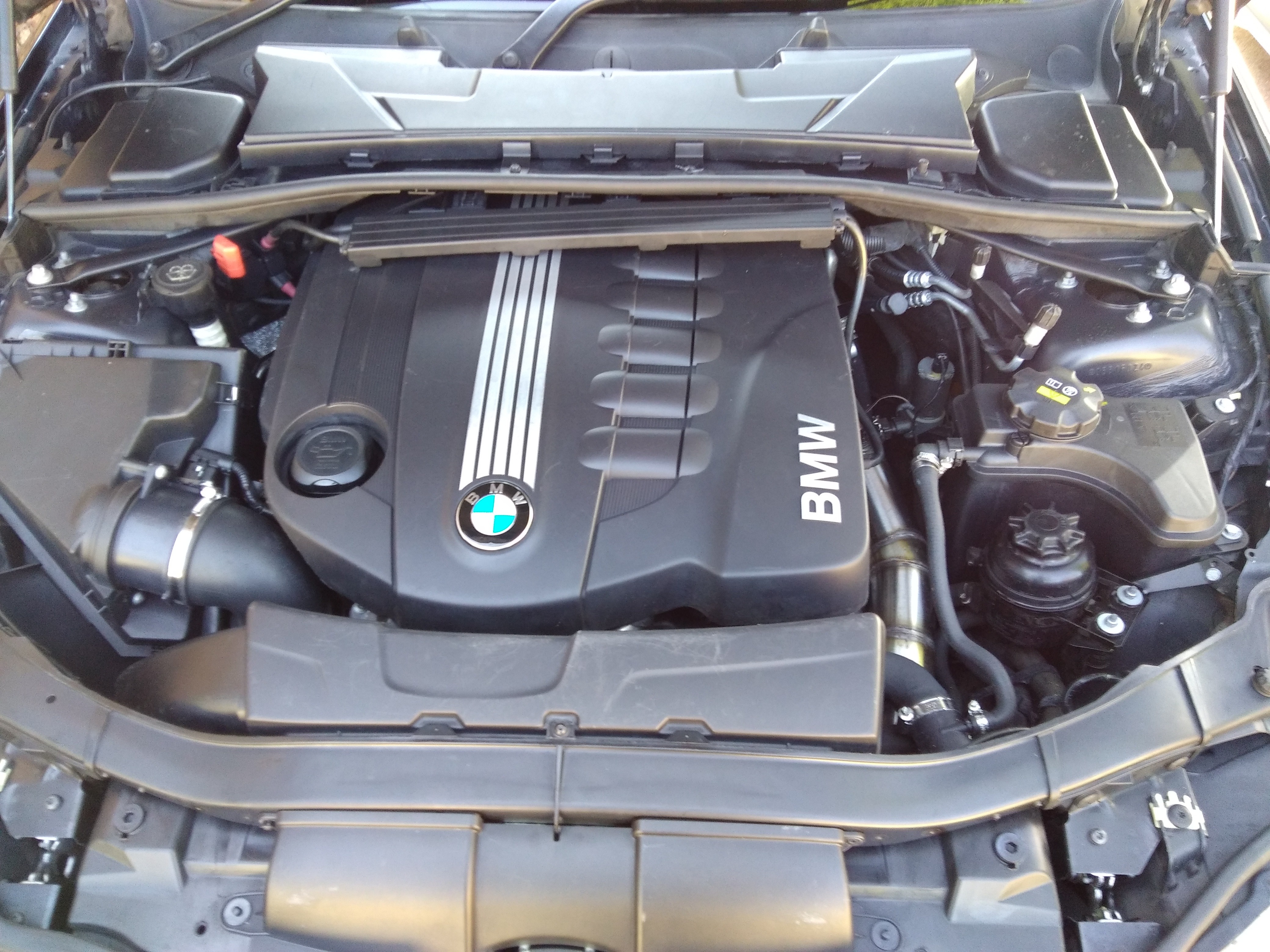

Here are some before and after pics of the steam clean :ty:

I did not cover anything up, just steamed and drove off.
I supplied the sensor and John fitted it when i did the oil service, Im sure he will be able to assist you with the pricing, just pop him a PM :thumbs:

I wonder if they used the steam cleaner from above or only from below , @Rayzor ?
I am really considering this, but might just take off the covers and driver there.
Rayzor
They used it from below and top. No issues, was done a few months back already. Also remember it's pressured steam not hosed with water

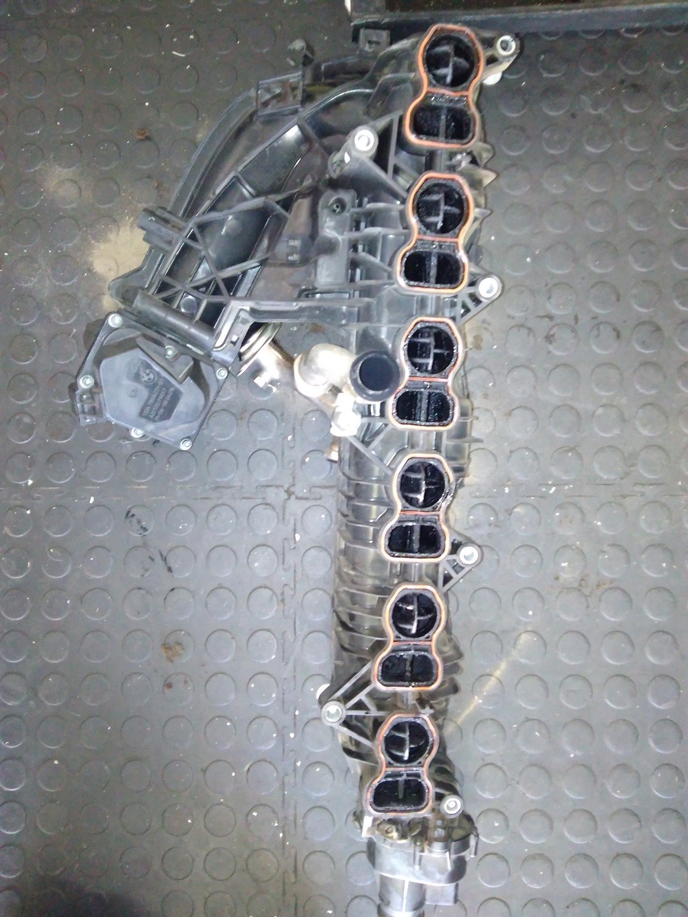

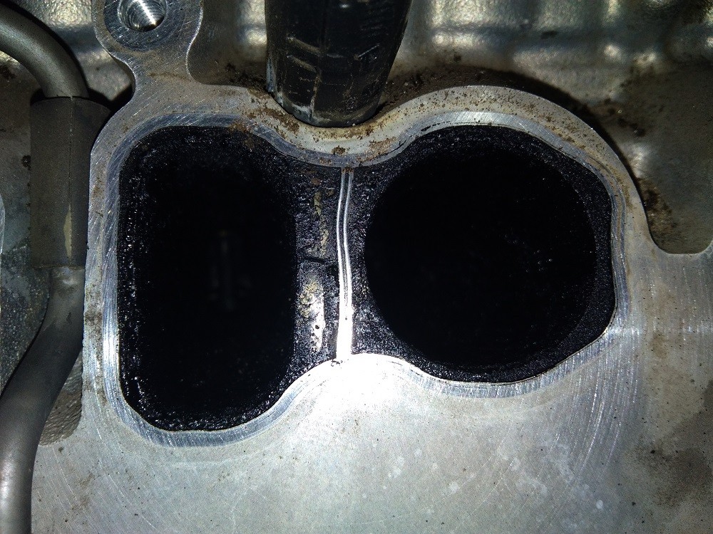

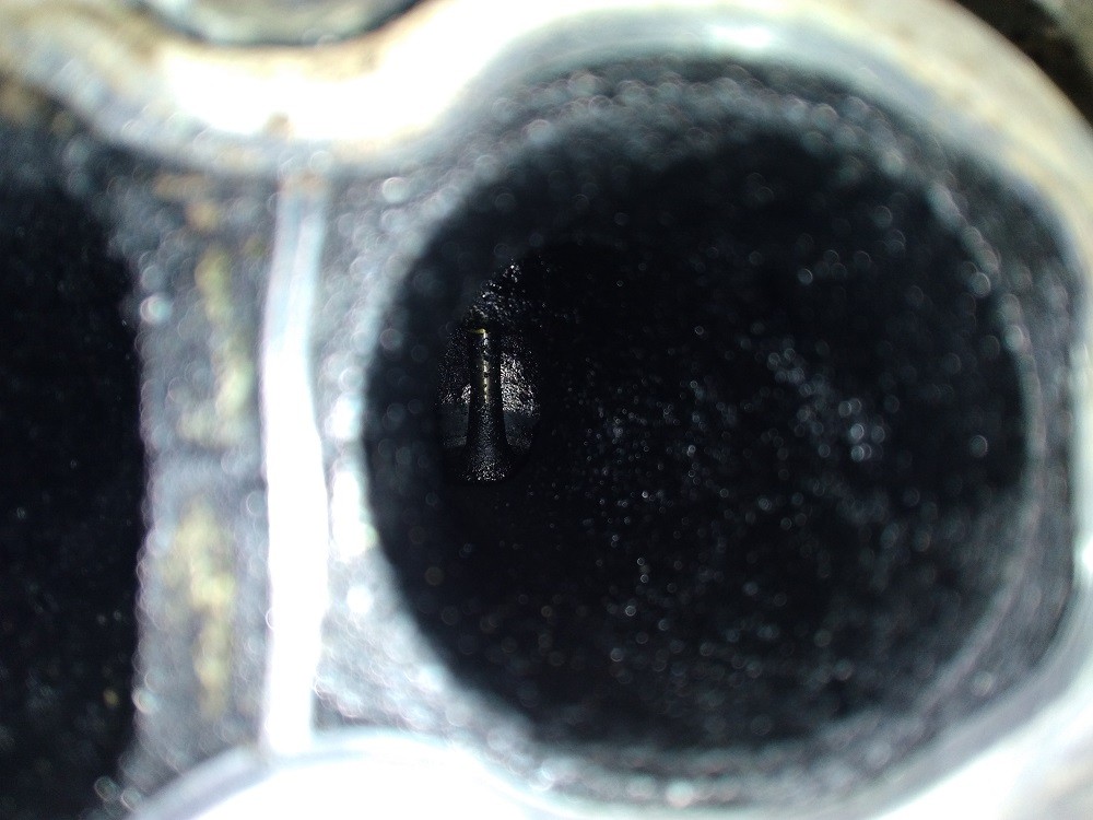

So last week Friday I made a booking to take the car in for a Carbon Clean to Marchand@CarbonDoctor, I was really curious to see what those ports looked like after 276k km.
So before I get started I would like to say thank you to Marchand, the guy is more than accommodating and offered me some solid advice which I really appreciate. I opted to work at his office while waiting for the car, so I could pop in to the workshop and take a few before and after pics.
So while waiting, I received some good and bad news.
The Bad: Marchand explained that the ports on the N57s are almost twice the length of the N54/55 and if he started with the carbon cleaning process I could potentially risk having a fair amount of shavings left behind in the chamber. He advised that he is not comfortable doing the cleaning but left the decision for me to make. I agreed with him and decided to rather just clean the intake manifold seen that it was already out.
The Good: Marchand told that the build-up on my car was really not that bad as it actually looks(pics below), he went on to explain the build-up on my car wasn’t hard and clumpy like what you would find on the n54/55s and explained that with water/meth injection together with the high boost that my car produces will actually aid in a safer cleaning process with the benefit of added power of course :smilebounce:.
Once everything was reassembled and I made my journey home.
So the question, "Was there a difference with the car after the intake was cleaned"? The answer is no, I couldn't feel any major difference.

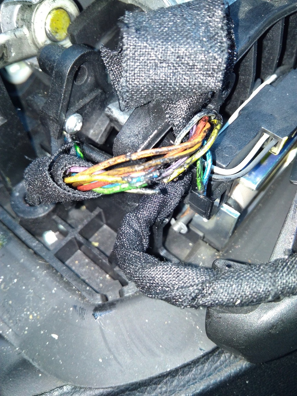

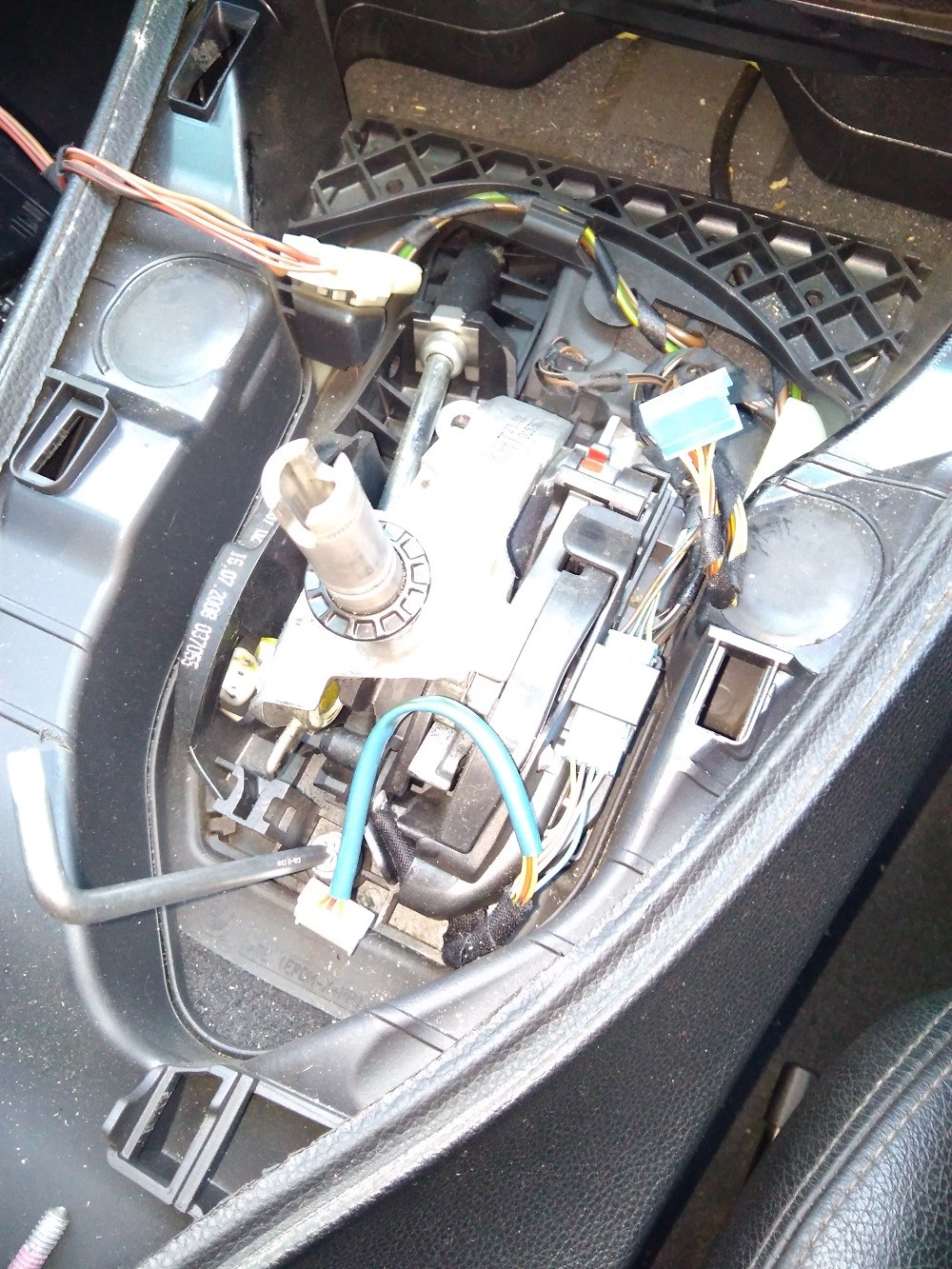

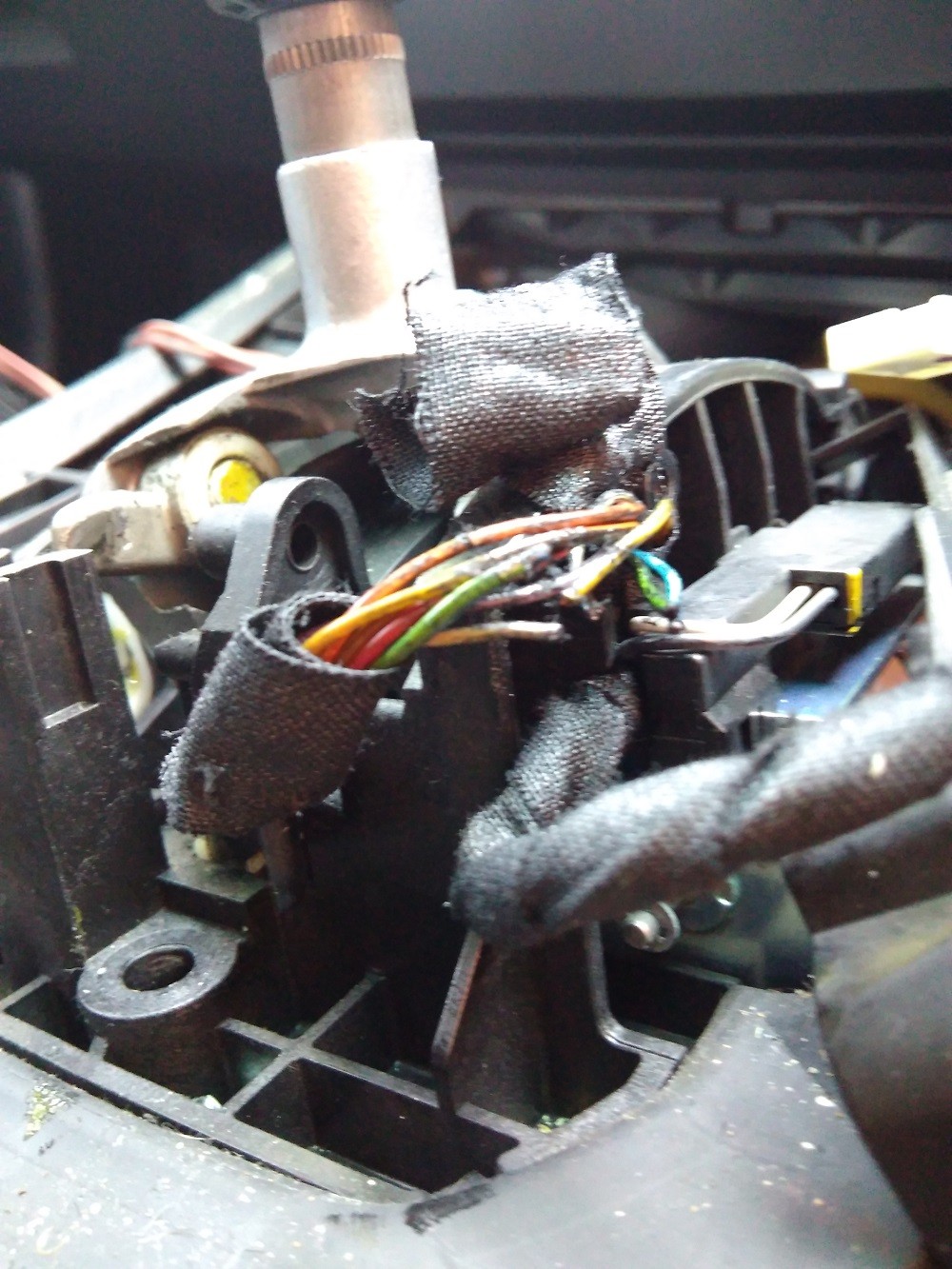

Seen that I had some time on my hands I decided to tackle an annoying issue I picked up with my Gear Selector.
Up-shifts in Manual mode were completely gone, sometimes not even engaging sport mode.
I did some research on the issue, It is caused by the wiring on the gear selector that is fitted to tightly and over time wears out due to the friction cause when moving the lever to sports mode.
DIY steps if anyone needs it:
1. Removed the gear lever, Placed it in neutral and pulled up, lots of force needed.
2. Remove the trim from between arm rest to ashtray.
3. Remove two connectors(one blue, one white) from selector to the trimming.
4. Remove 3 T30 bolts that hold down the selector.
5. Remove 3 screws to the bracket that sit on the right above an actuator.
6. Investigate the wiring, you would need to remove the factory insulation tape as the damage is hidden.
7. Reconnect the broken wires.
8. Place the wires in a place where it will have some slack, (does not need to be put back to OEM setup).
9. Test to see if everything works
10. Re-assemble and enjoy manual mode again.

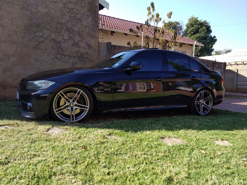

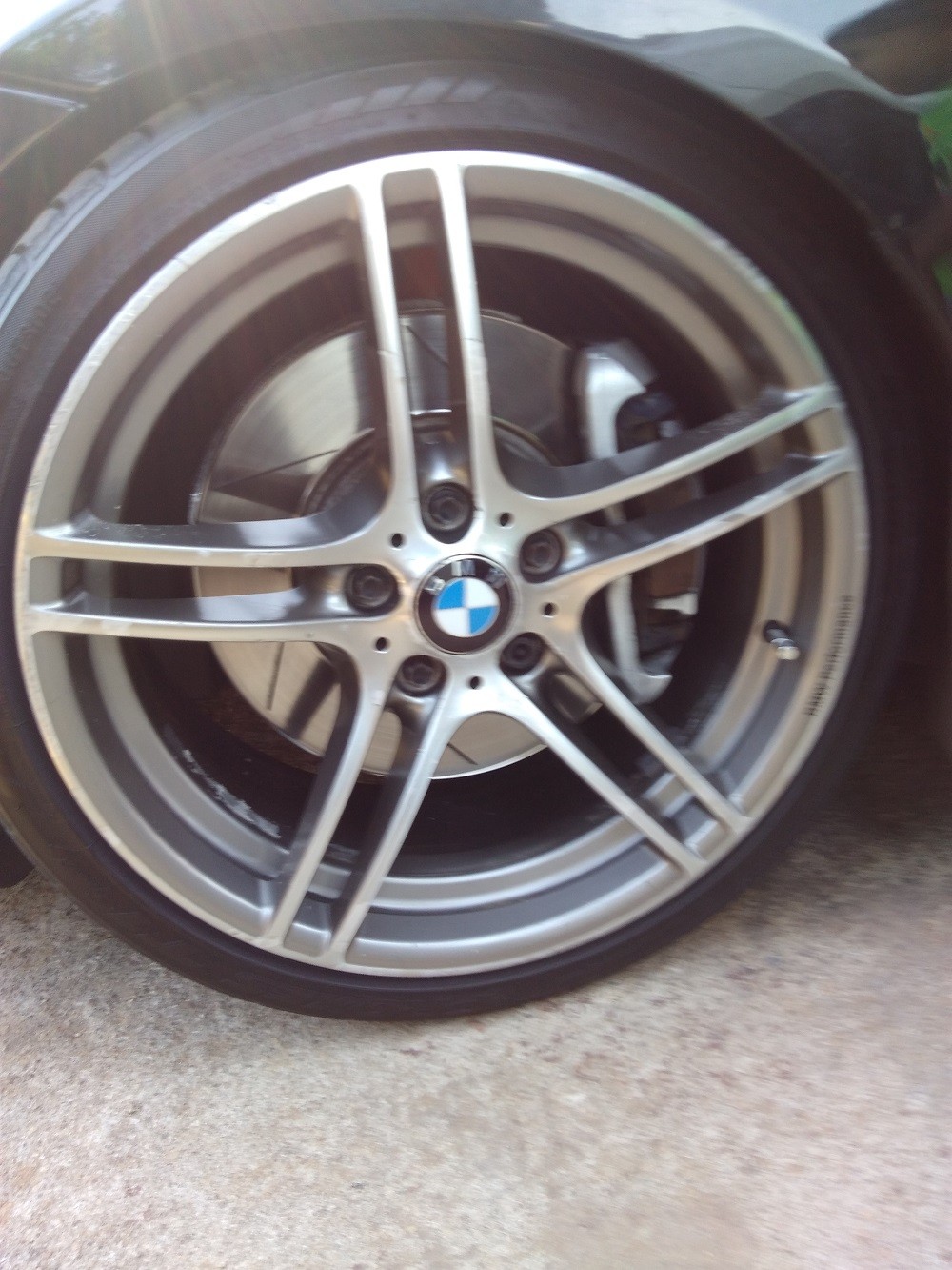

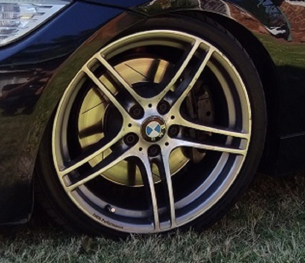

Once done, I gave the car a nice clean up at the local carwash :tiptoe: which included my dirty calipers. i must say I was blown away by the results.
BEFORE:
AFTER:
corp
That gear selector issue is an easy fix. Cost me about R100 for parts, including a tool I was missing, plus an hour of my time. Much cheaper than the thousands of rands everyone wanted to charge.
