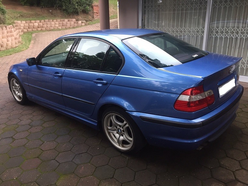

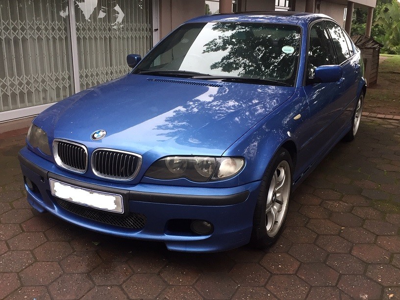

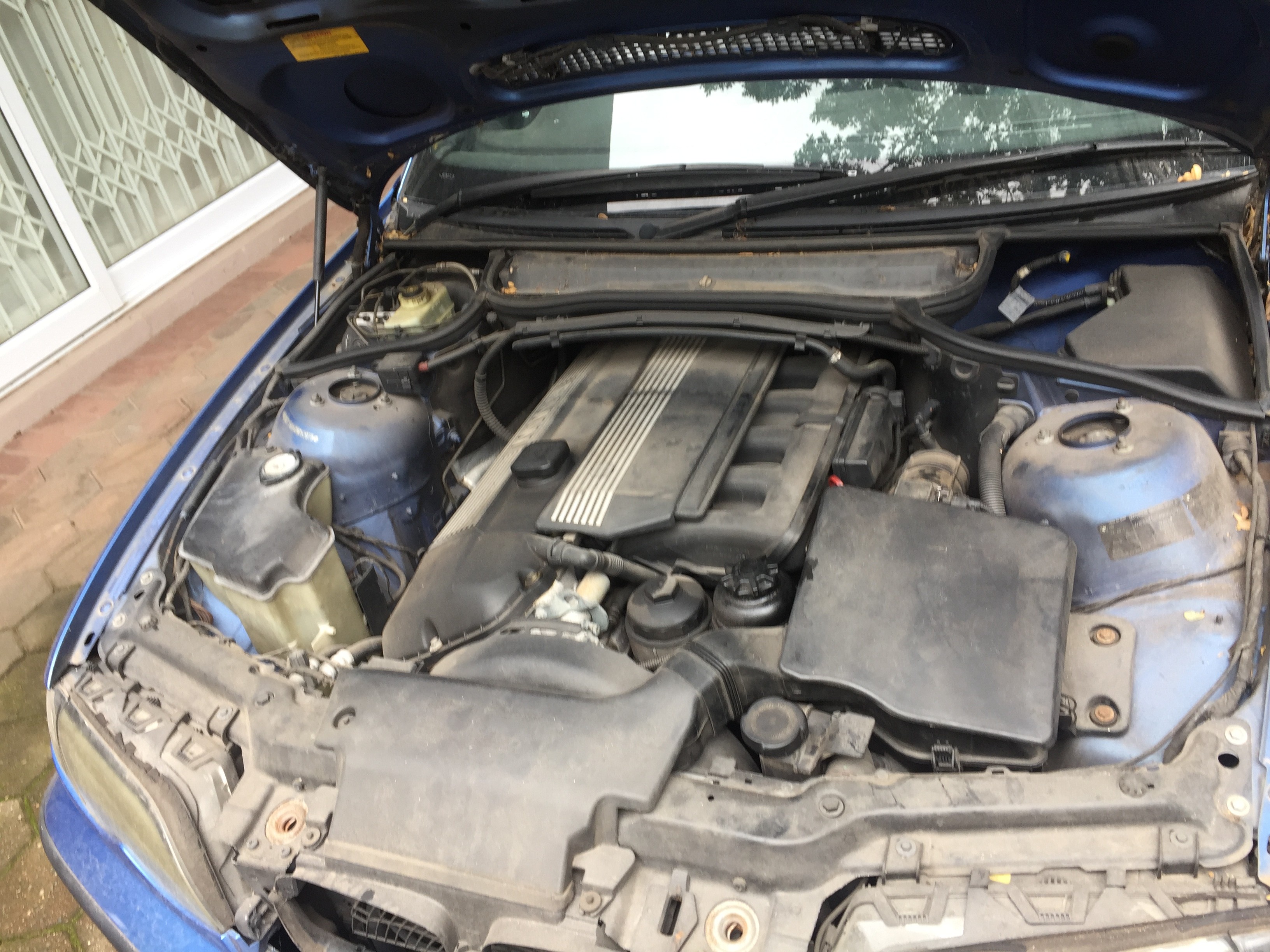

As promised , this is the car :) It may look ok in the pics but up close its ugh a mess . This is the pic of the engine bay before I washed it . These are pictures of the car , after I washed the body to see what I was dealing with , Didn't take a pic after I washed the engine bay . Will take one after its working . I couldn't work on it in this filthy state lol

The exterior doesn't look bad at all,
The engine bay seems complete too.

Looks beautiful in the pics! Lol...
But that engine bay does look kind of uhm... dirty...
