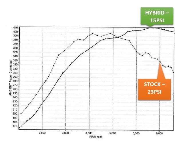

KrS24
Stock twins Vs Hybrid
The stock turbo car's dyno shown, is a FBO car running the BMS race flash and targeting 24psi
The delay in the power build up on the Z4: The rear wheels lost traction on the dyno. When adding someone to the boot the wheels began to rub. Hence I had to feed the power in. Will have to look for a way around this considering the plans for the car. Baring in mind there should be a minor loss in spool due to the bigger wheels and shaft.
gavsadler
That's a strong graph, well done on the developments.
It will be interesting to see the graph if you can get all the power down properly on the dyno, I would think being a hybrid that it will be similar to stock, but continue to climb on the same trajectory up to red line.

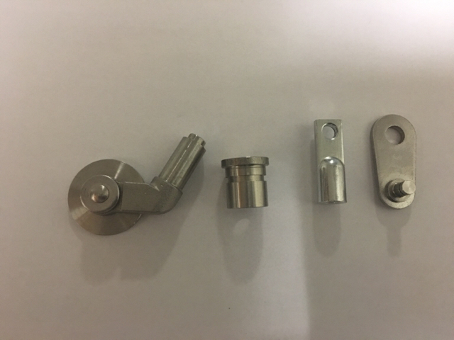

KrS24
I have been exceedingly busy lately. Spending most of my time at various mines around the country. So no time to continue with the hybrids. The turbos were removed from the car and inspected. I am happy to report all is well. No shaft play. No damage to the wheels. The turbos were given to a second turbo builder to inspect. He gave us the all clear. Soo it looks like we have a good product. The turbos have since been fitted on another Z4. The owner is loving the new power. He is enjoying 430whp @ 17psi daily. We are waiting for a few supporting mods to crank up the boost. The car is currently on run flats and is a challenge to keep in a straight line. We are busy getting the wastegate flapper pieces machined and will start taking orders soon.

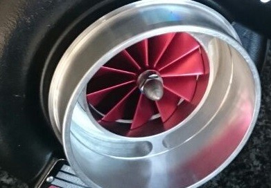

KrS24
Now that I have a little time on my hands, the development continues with my Z.
I will just leave this here
KrS24
You missed a 1.
This turbo is rated 110kw more than my previous iteration. Hopefully the dual ball bearing will help the spool up time. My goal is to get it as close to the twins spool as possible.
