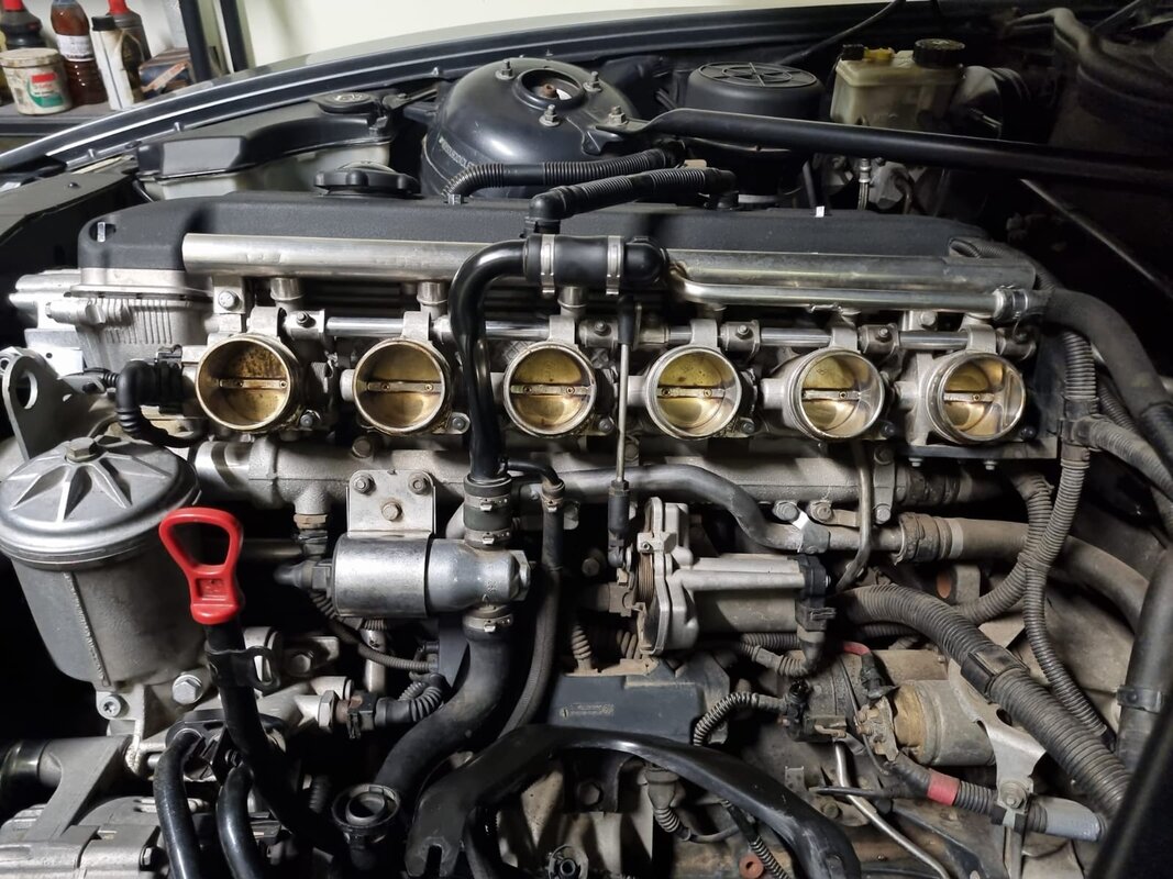

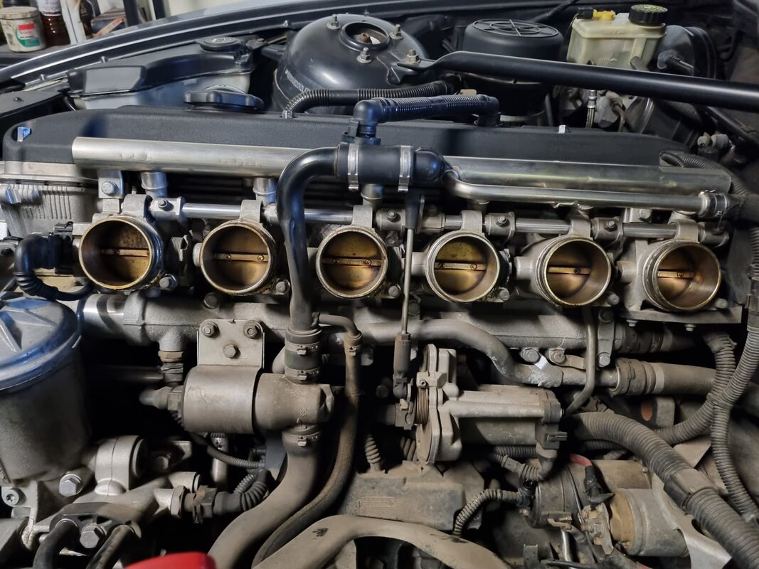

I have half-heartedly been chasing the stumble off idle issue. Replaced the rear TPS with a new one (the store only had stock of one) and gave the ICV and throttles a quick clean while I was in there. It did not solve the stumble issue, but I will replace the second TPS before giving up. I have noticed a few other S54s doing the same thing, so maybe I need my mental TPS reset.
Grubby:
Clean (-ish, could not get those stains off the brass). Bonus side effect: I need to buy a new crank vent hose as mine broke in twain 😠

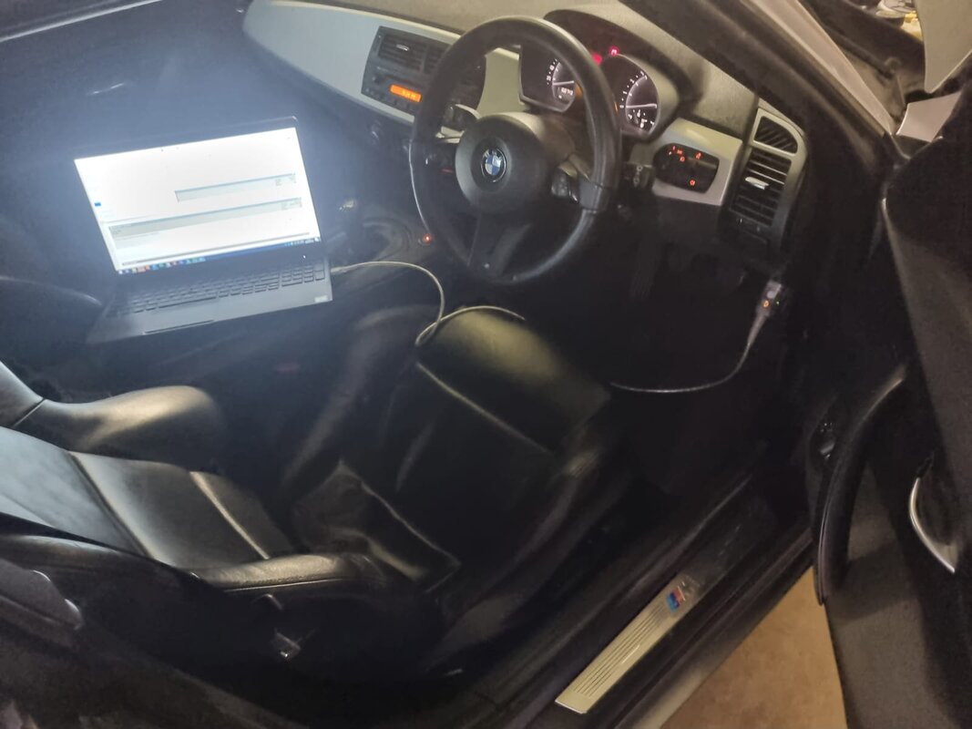

Figured I'd update the ECU, this definetely made the car feel more responsive, but that may be due to the adaptations being reset and the ECU learning all taking place on the skidpan. Break them in hard, I say! It still stumbles tho 🤷‍♂️
Was slightly scary, took about 3 beers to update, started worrying if I had maybe bricked the car. Deffos have the car plugged into a beefy charger as the fuel pump remains running through the whole process!

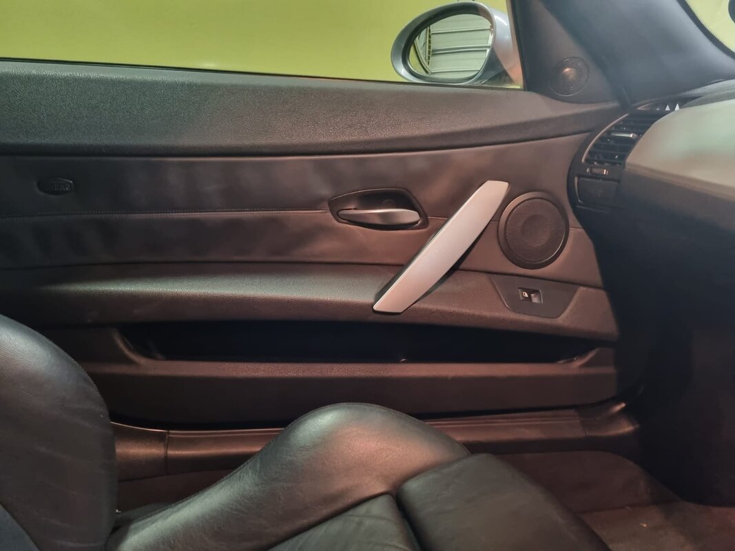

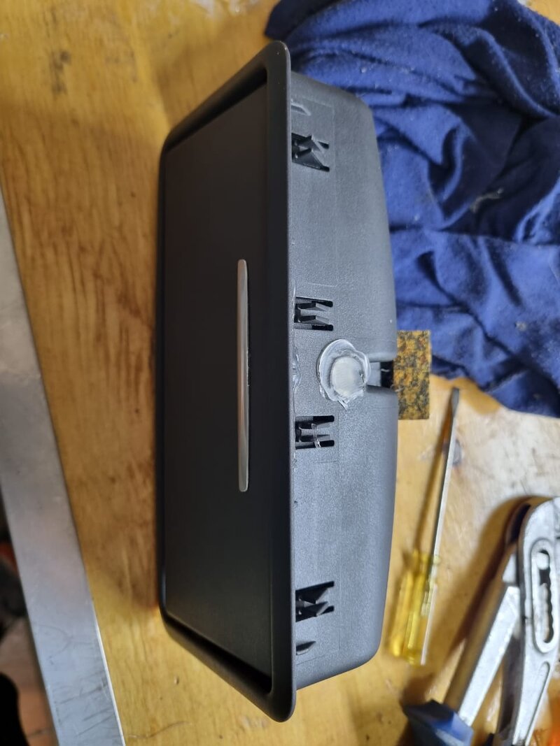

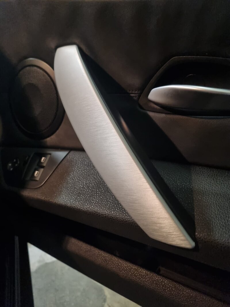

I covered my door handles with a brushed aluminium wrap to match the dashboard. Nicely lifted the interior vibe a bit

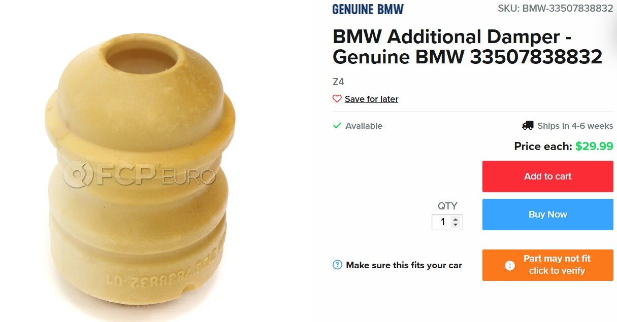

Z4M bump stops:
"Normal" Z4 M-sport bump stops:
I ordered them both, but will install the shorter M-sport bumps stops since the car is sitting a bit lower now, will be interesting to see if it softens the ride somewhat. Interestingly, the H&R rear springs are made of noticeably thinner steel than the original springs but with the same number of coils. This should translate to a lower spring rate and softer ride. The stock Z4 rear springs are a lot beefier than the E46 touring springs...weird since it weighs 200kg less and cant carry passengers or doggos in the back. An example of an obvious design fuckup, BMW?

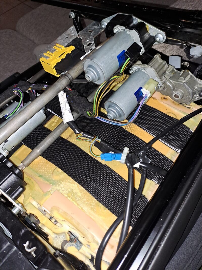

Finally got around to repairing the collapsed drivers seat cushion with some straps. Kinda weird not sitting on the floor now 🤷‍♂️ Used the opportunity to clean up under the seat and in the boot area where there seemed to have been a chemical spill of sorts. The jury is still out on if it was molasses or some cheap coffee that spilled and got wet, soaking into and under the carpet. Yuck. Car smells noticeably better now :ROFLMAO:

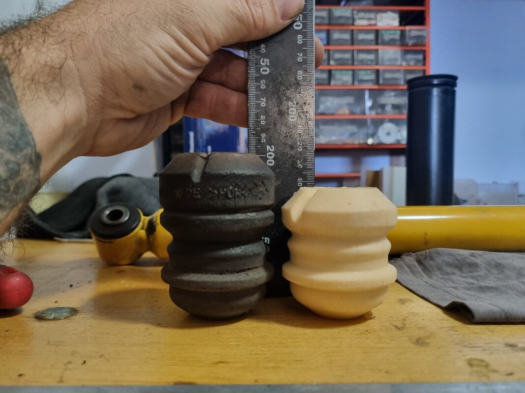

Finally received and installed the M-sport Z4 rear bump stops. Wow! It no longer feels like going for a ride in a wheelbarrow. I have said it before, but I'll say it again, this is how the Z4 should have come from factory, slightly lower ride height, softer springs, better dampers, shorter bump stops. While still a stiff ride (sport car - duh), the suspension now has fluidity to it, absorbing bumps instead of bouncing off them. The stock Z4 suspension was the single biggest thorn in the side when it came to Z4 ownership, how BMW got it so wrong when the solution is so straightforward, even a nincompoop like me can figure it out, remains a mystery.
Comparison of M vs M-sport bump stops, M-sport is 17mm shorter. Now, 17mm might not sound like much, but it makes all the difference. At least, thats what she said. From precision use of my eyeballs, I estimate that I now have about 35mm of rear suspension travel before hitting the bump stops. Lovely

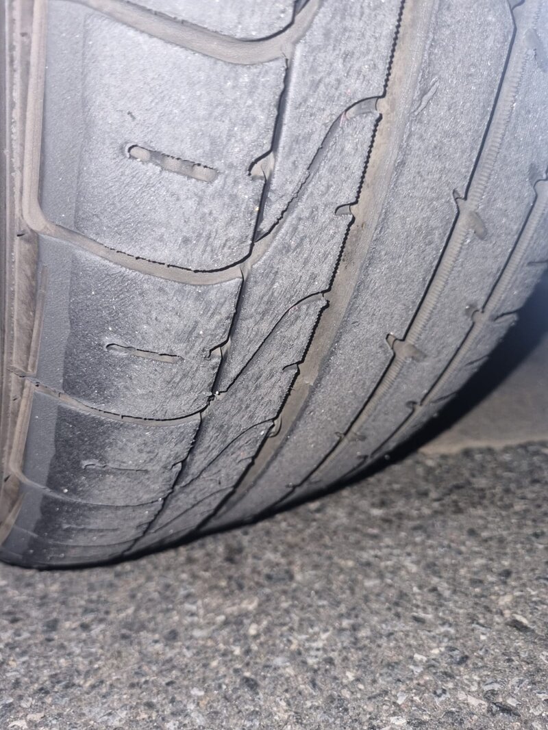

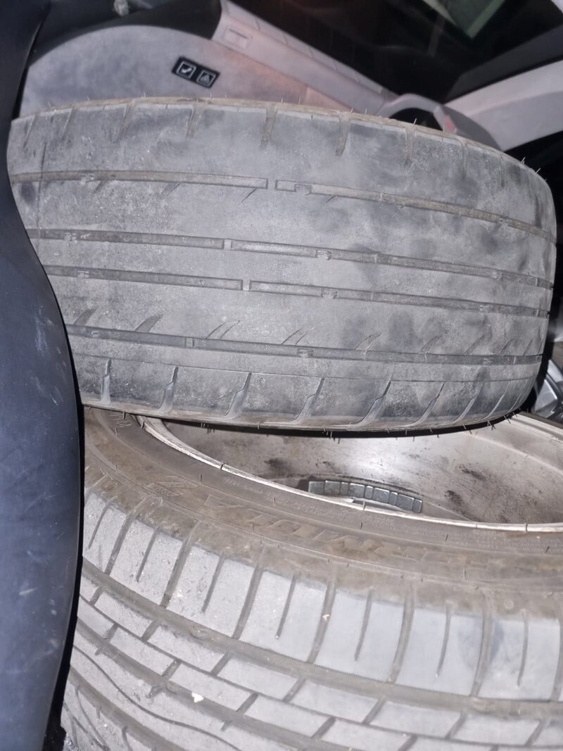

Rear tyres successfully and deservedly killed. Front tyres are putting up a strong resistance. MUST. TRY. HARDER. Got my wheels refurbished and, perhaps stupidly, threw on a new set of Easgle F1s on the rear only... Love how "bulbous" the Eagle F1s are compared to the Chinesium that was on there.
Maybe less oversteer and more understeer will kill the fronts...off to Redstar on a mission...

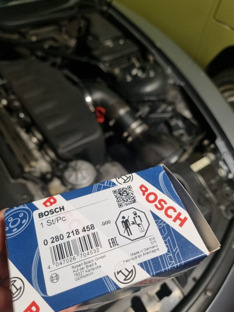

New MAF finally arrived. According to Bosch, I need to wear a hardhat when fitting a MAF...fair enough, I need new bonnet shocks
Old Bremi MAF went directly to the bin. It did not pass begin. I used this opportunity to clean out the air filter, I think I found where my rear tyre tread ended up! Last filter clean was about 3000km ago.

I am happy to report that the car feels much better with the new MAF, more responsive at low revs, the power delivery is more linear and predictable. I feel it pulls a bit harder now and the revs also dont drop below idle anymore, however, the slight stumble off-idle is still there. But, after hearing Gavs roadster stumble, I figure mine is very acceptable. The last potential culprit could be the throttle actuator, but I figure I shall put this saga to bed and be happy with my lot.

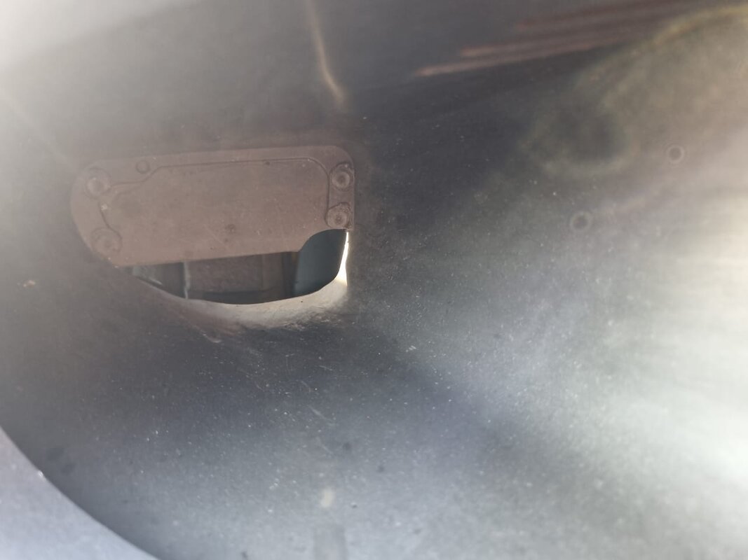

In a desperate attempt to provide more cooling air to the brakes, I cut the smallest little slot into the front "tyre cooling" ducts to direct more air to the brakes. Not very effective I'd say

Front tyres after about 100 laps...I am out of ideas on destroying these. Short of installing them on the rear and doing burnouts, does anyone have any pointers on how to punish front tyres? Asking for a friend...
