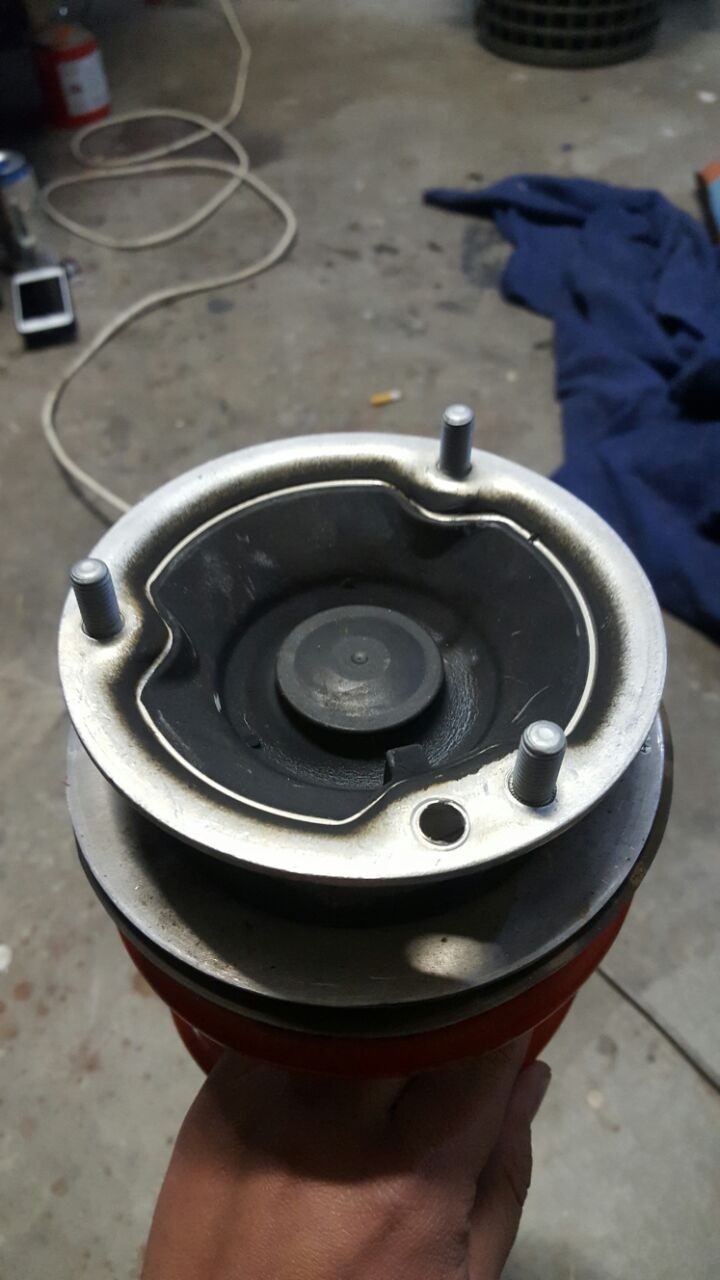

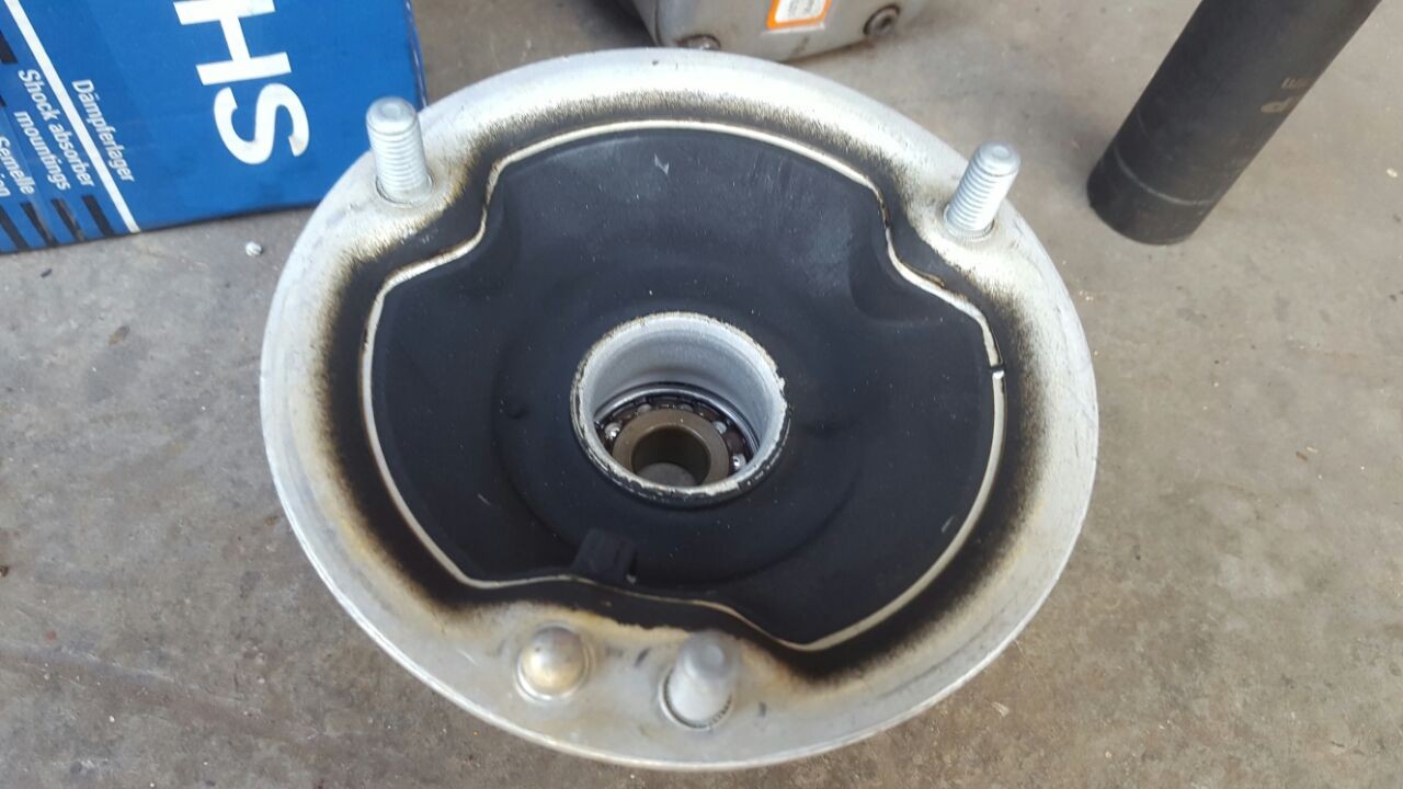

Replaced the top shock mounts with Sachs items. Removed the alignment pin to get some more positive camber on the front wheels as the inside of the tyre is wearing very quickly.
Hopefully this fixes the noises I have been getting from the front over rough roads, as the bearings on the OEM mounts were stuffed.

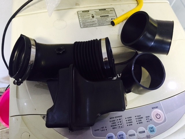

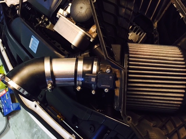

This long weekend had some time to spend on the 1'er.
Found a hole in the intake pipe, the previous owner said it was for a air temp sensor:hammerhead:. Do decided to built a new intake and delete the sound resonator on it.

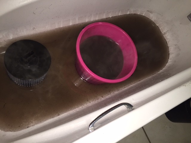

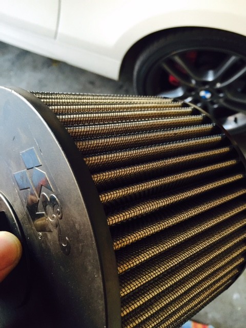

Found out the Car had a Filthy K&N fitted, so that was given a clean and oiled.

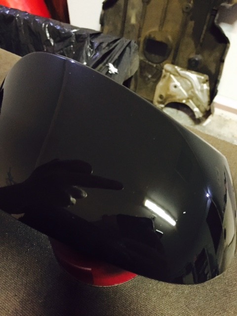

Carrying on with the pink theme the wife wants.
Removed the Mirrors and Grill surrounds and added it some custom touches.
