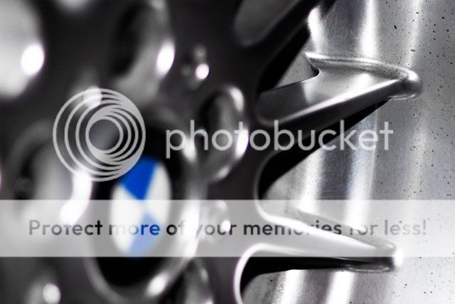

ChefDJ@TheFanatics said:Stunning shots.
Awesome car for an awesome long trip :=):
Thanks man. We were contemplating whether to take the wife's Jetta V 2.0 or the 5er.
Cruise control and overtaking prowess beat fuel economy.

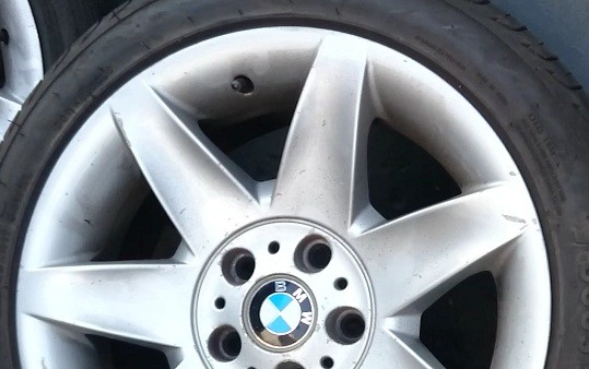

sash said:restoration or refurb...?
if the one is the pic is the worst then i assume it needs a good clean up.
