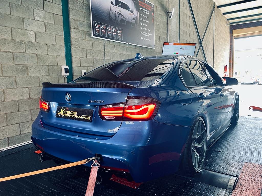

Vargas GC Turbo done by Xcede and Xflow Performance
Stage 3 Software by Xcede Performance
Amazing reliable power, Drives like a stock car when needed but gets like an animal very quickly if you put your foot down.
Massive shout out to the team at Xflow and Xcede for always providing me with the best service.

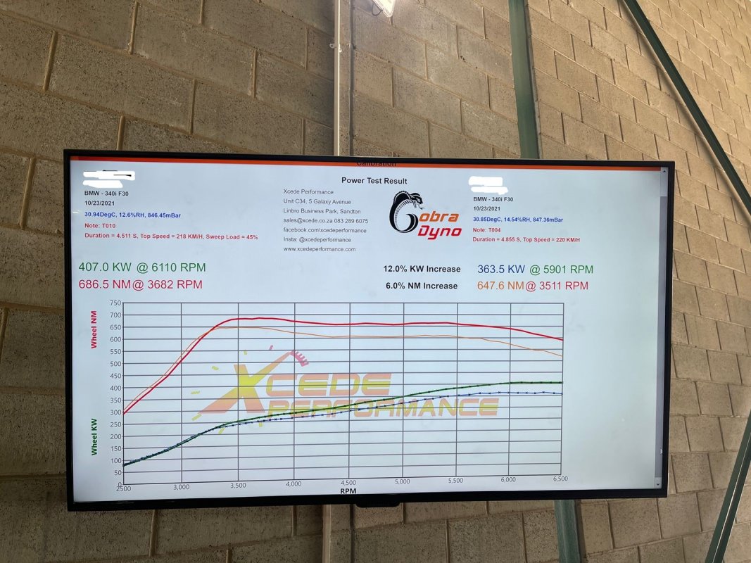

After the Stage 3 the car made 363Wkw 647nm on pump fuel and 407Wkw 686nm on E Blend
It ran a 11.84 @ 199km on the 1/4 mile at Rhino Park on an unprepped track and in full street trim with a 2.15 60ft
Lots more to be had from this car but happy with the first time out

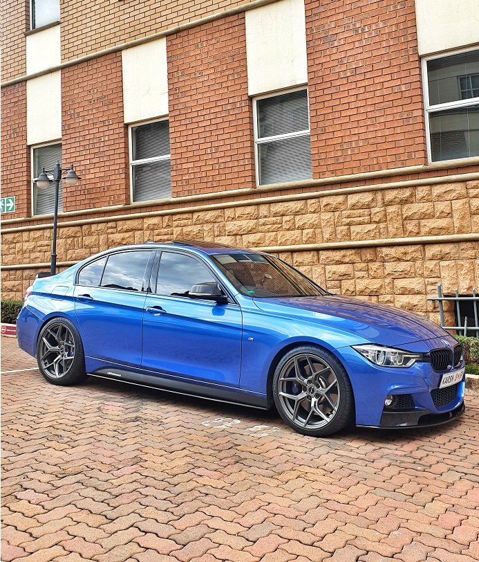

Eibach pro kit
Any Reviews on this?
Are you still on stock Dampeners, and approximately how mm drop did it give?
Ride Comfort and handling ?
Not much info on Eibach for f30s as compared to H&R, so keen to hear what you have to say(y)
KarshS
to be honest i havnt sat in a car that has H&R. From what i have read the Eibach offers better stance without compromising on comfort. To be honest the car feels exactly how it felt with the oem springs which is what i wanted. It did improve the front roll i was experiencing around corners. It handles much better. I also did not want it to drop as low as the H&R. For me the stance is perfect and i dont need to go sideways over bumps (Well most of the time)
Unfortunately i dint measure how much it dropped by but from an eye perspective it did drop significantly
