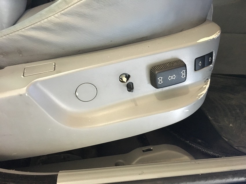

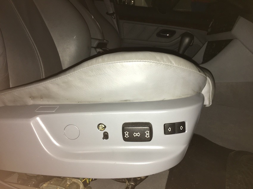

Resprayed the plastic on the side of the drivers seat this weekend. A quick before and after pic:
Excuse the dirty leather. Also need to find the missing adjustment knob.
msm
ChrisBrand@TheFanatics said:
Nice! What products did you use?
Used Rustoleum products from Builders Warehouse.
Was initially going to primer, then go with a separate grey colour. However, the grey primer was almost the right colour..
I then covered with a thin coat of clear semi gloss for protection. Wanted it to remain as matt as possible.
