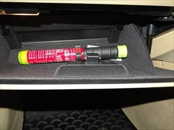

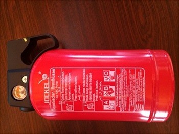

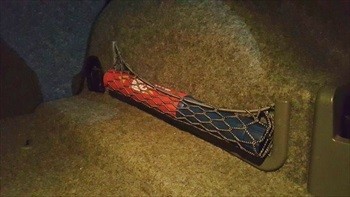

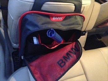

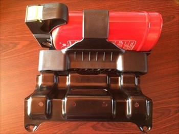

Anyway here are some pix of the kinds of extinguishers installed in my cars:
First the BMW OEM extinguisher:
The one we probably all have at our offices and homes:

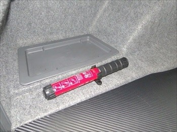

The fire-stryker which I prefer: Its light, portable and can be stored in various places in the car; its maintenance free and has an unlimited shelf life. BUT you have to practice with one (yourself) to know how it works. A video will only help a little. Best is to strike it up and see how it works.

I recently bought the fire stryker and it's very small and compact. Glad to hear that it is also MSA approved as this was one of the things I still wanted to find out.

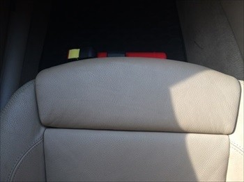

I have also done the underseat one in my e39.
About a year or so ago I was traveling on the N1, the were bags of cut grass that blew onto the highway and got caught under another guys car. It ignited from the heat of the exhaust luckily I stopped just in time to put it out without any serious damage to his car
Will see if I have any pics of the e39 install

Pics of the extinguisher in my e39, was like R100 on special at builders and the bracket is fixed using cable ties.
Barely noticable from the top
Even less so when the front seat support is extended
