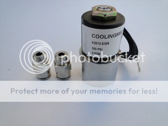

Sherwin...Excellent output and dyno confirmation of a modification that has become essential when running high boost levels. Our octane is just not up to it. Your meth/water mix also works best at the coast, without any issues for cooling benefit, safety and octane boost as well as protecting the sensitive flow sensor.
Ps....I found adding a coolingmist solenoid between the checkvalve filter and flow sensor (in that order), keeps the meth flow consistent and strong without pressure drops or flow delays. I am sure this is not new to you, just thought I would throw it in.
