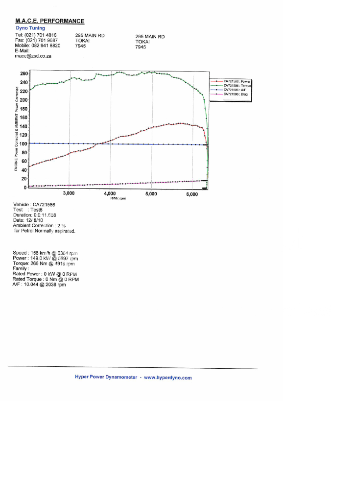

zabbo
This is mine after M50, chip and filter.
(this was surprisingly with a bit of an engine niggle)
