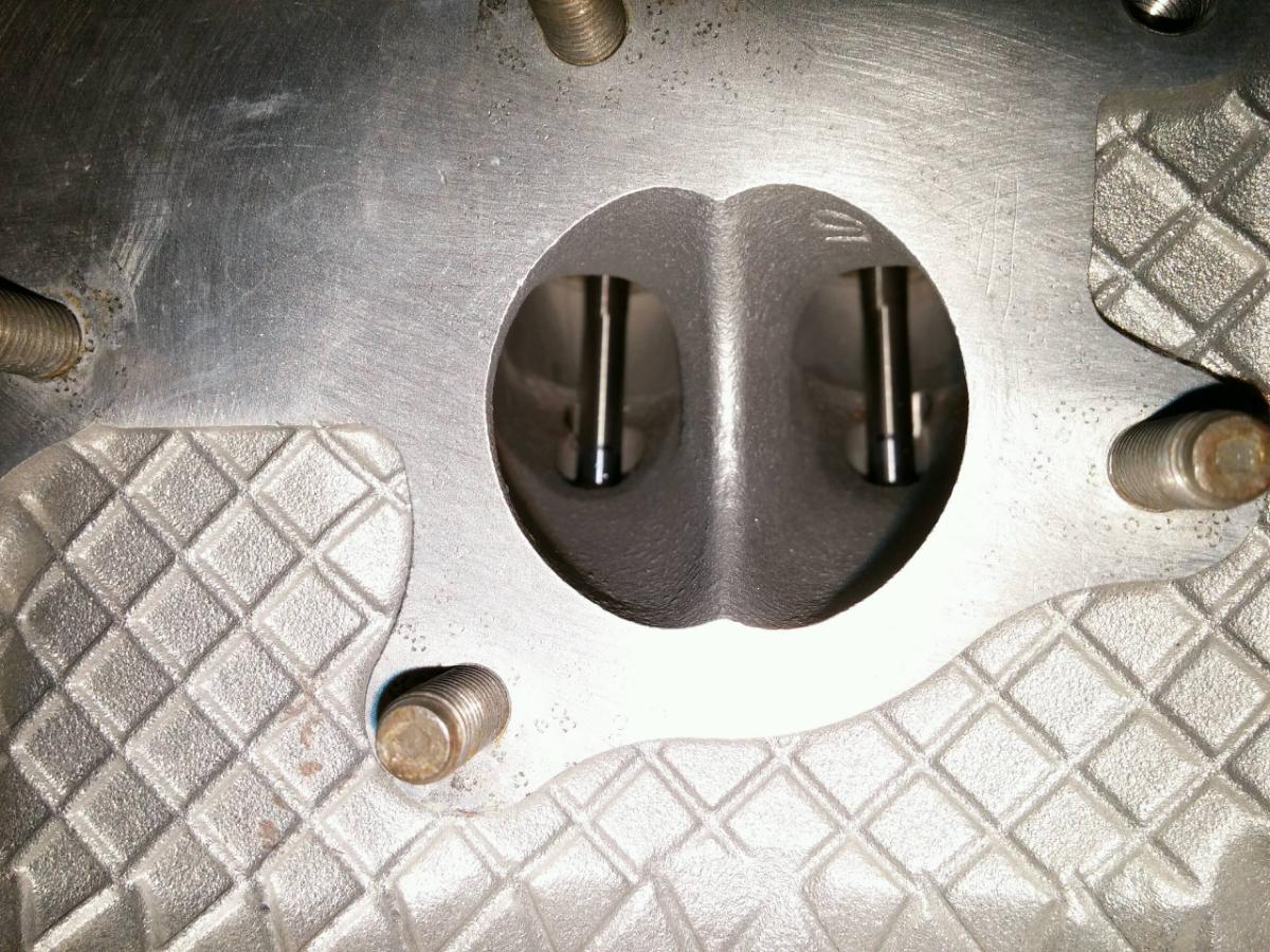

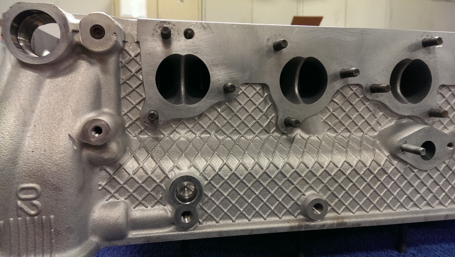

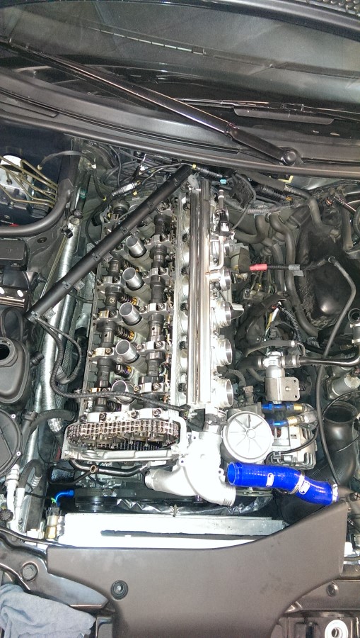

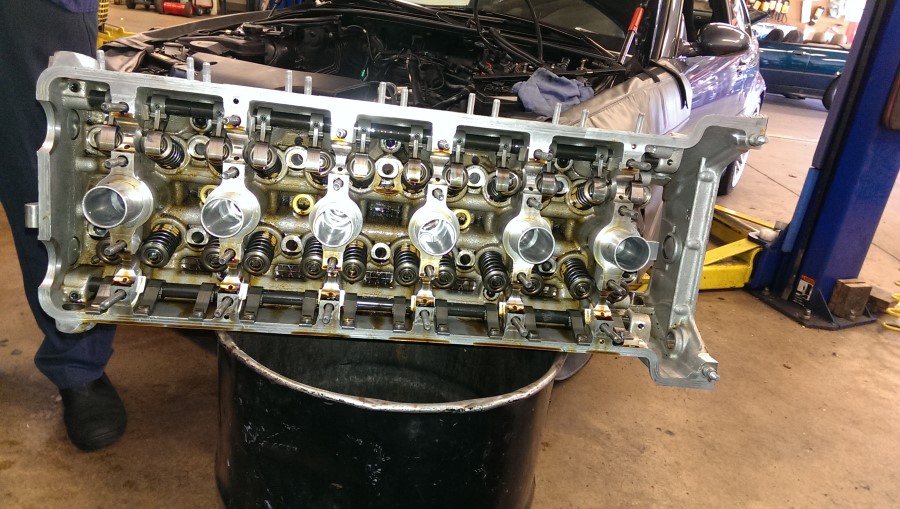

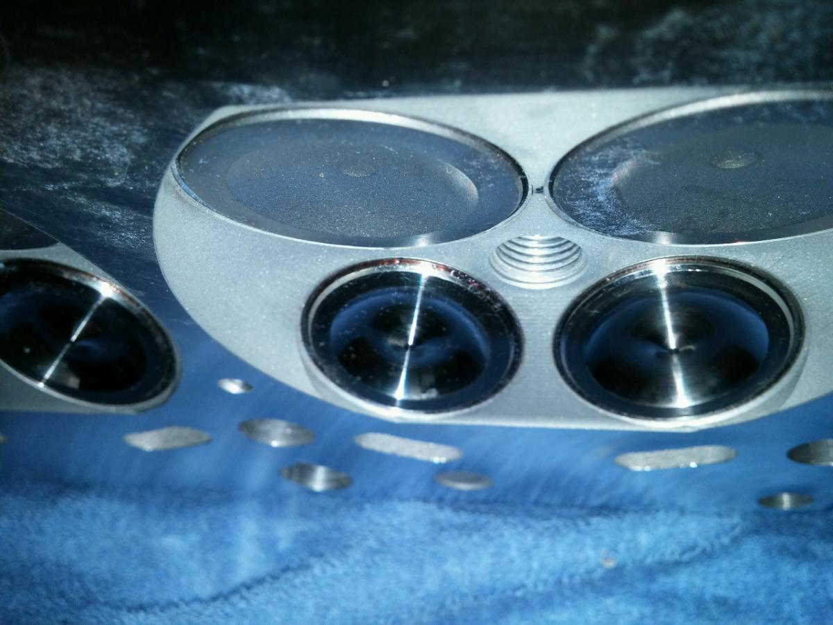

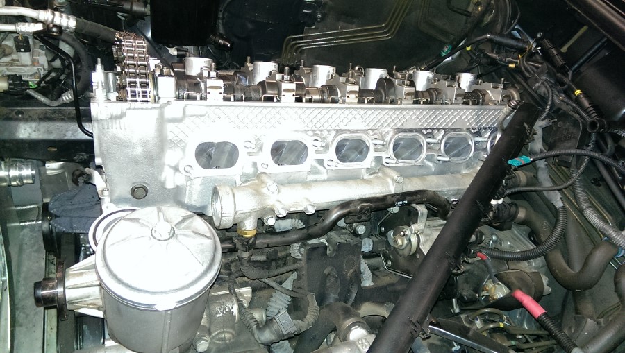

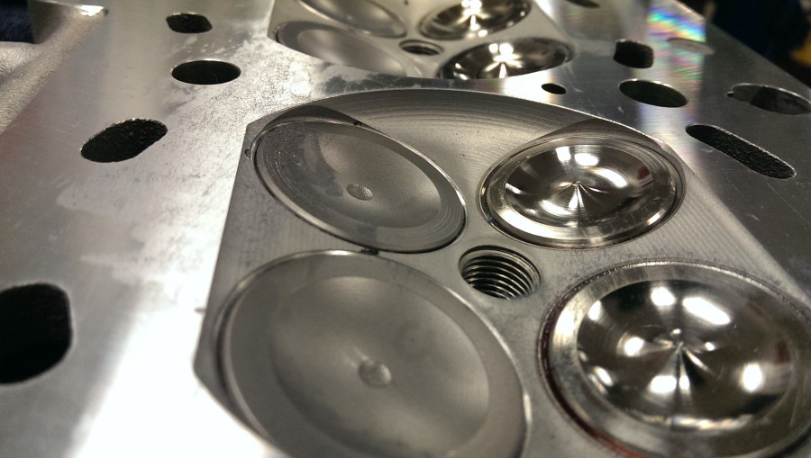

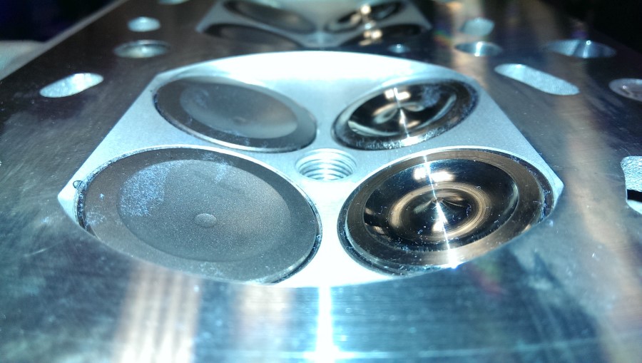

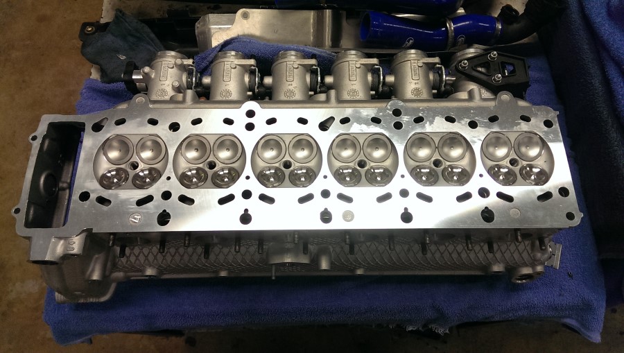

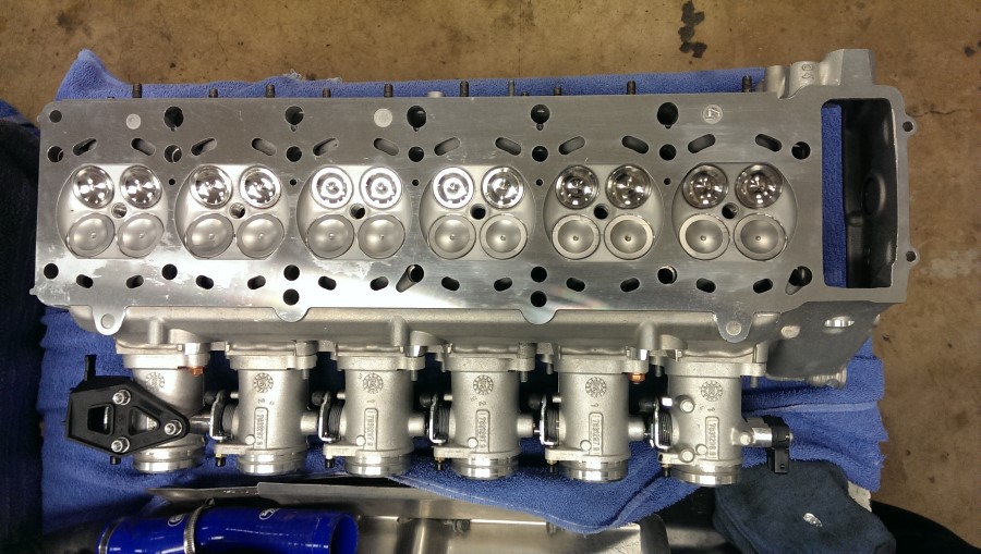

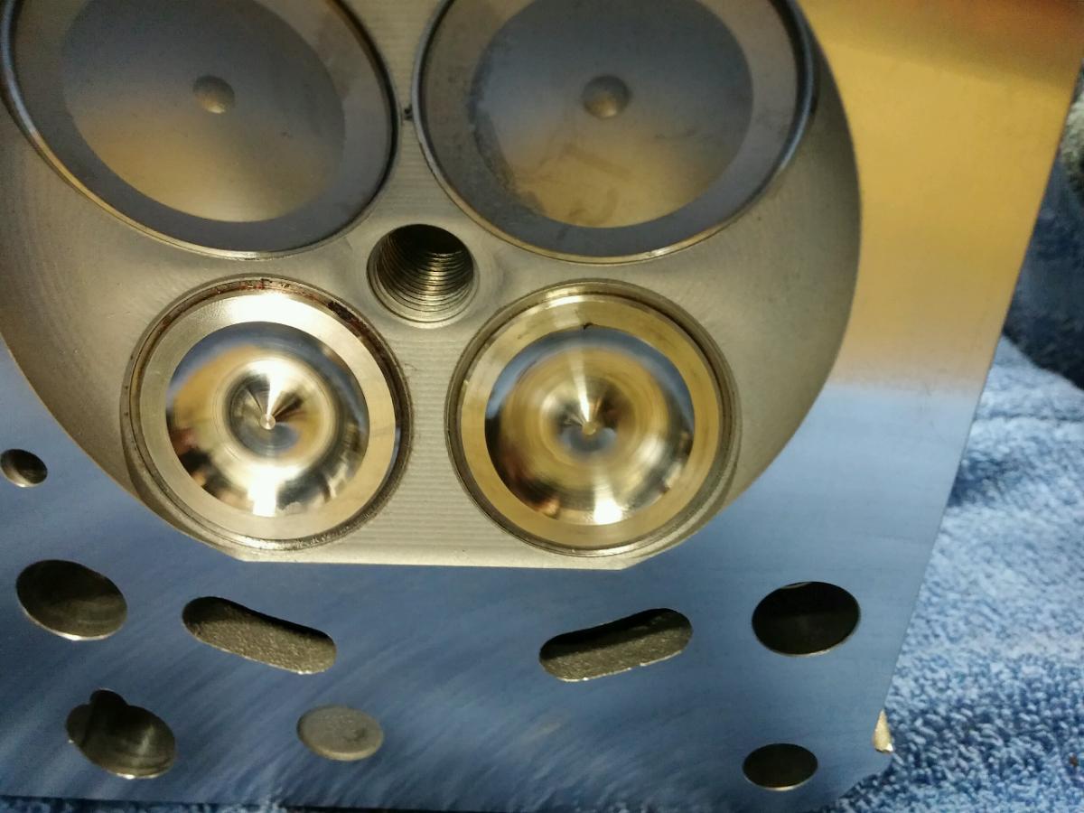

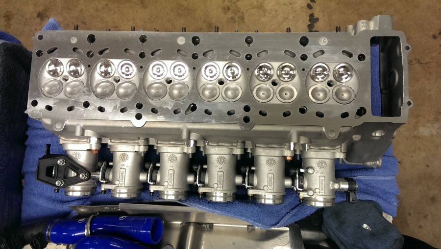

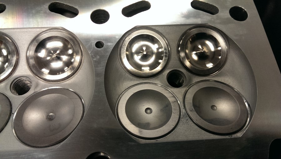

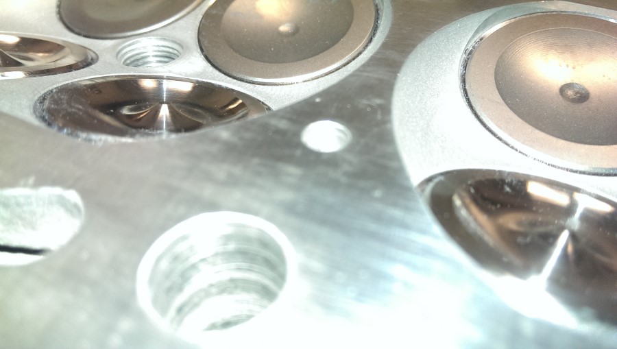

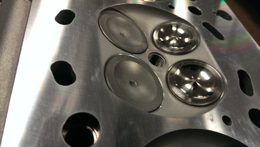

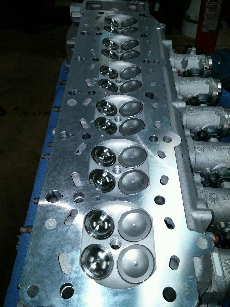

Head is finally back from Lang Racing. All first look at what a CSL head actually looks like with the shiny pointy valves installed. Can't wait to drive the car with all the changes and rock solid VANOS.

The car was dropped off to my old show to finish all the head and selected items. Below is what was to be completed this time around:
  • Remove head to be sent to machine shop / reinstall head upon return
  • Head word done by Lang Racing
  • Install CSL Valves
  • Supertech Valve Spring Kit
  • Supertech Stainless Steel Intake and Exhaust Valves
  • Complete Disassembly & Cleaning
  • Comprehensive Leak, Crack & Pressure Test
  • Inspect All Components For Irregular Wear
  • Our High performance Five Angle Valve Job
  • New Valve Seals
  • Trueness Checked & Resurfaced Mating Surface

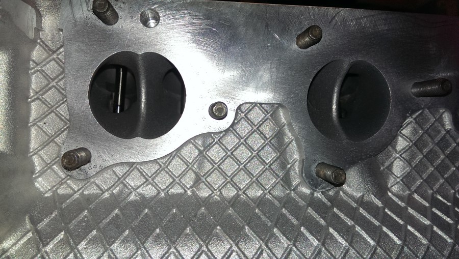

  • Unshrouding of Valves

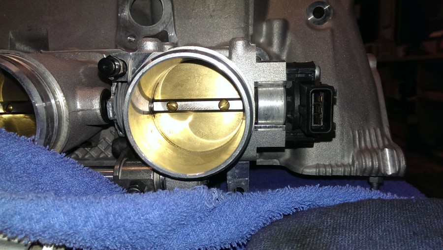

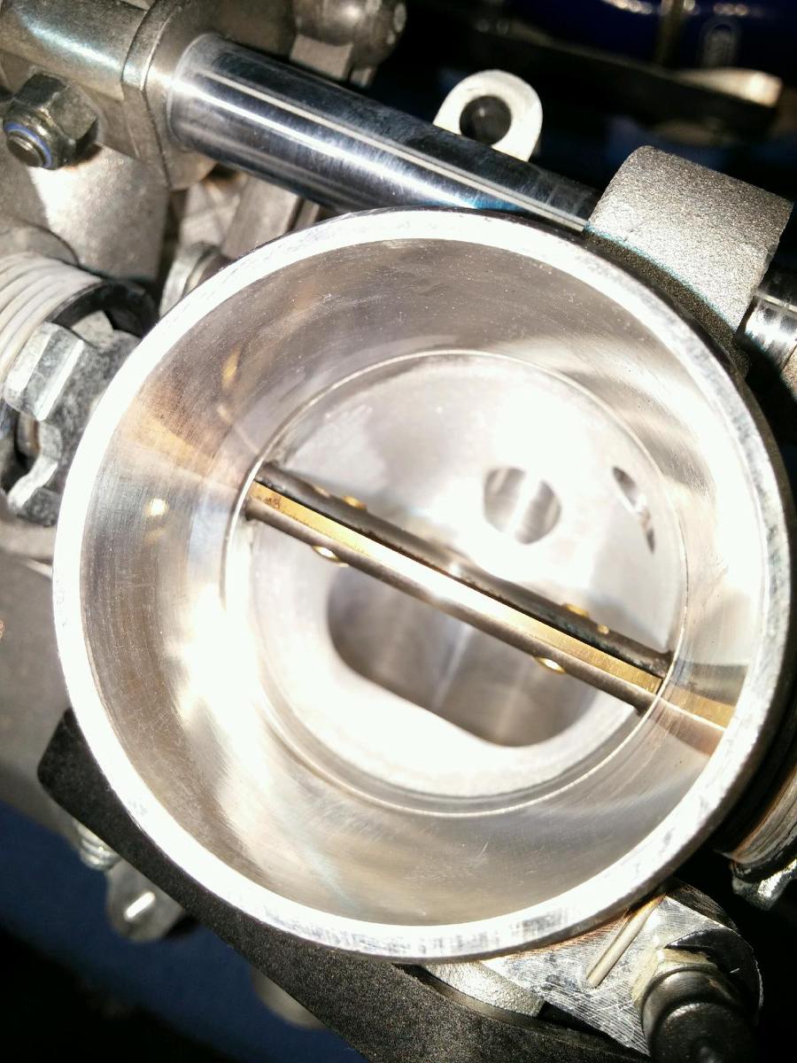

  • Blend the throttle body ports to the intake valves and smooth out the CNC cuts on the intake side of the cylinder head.

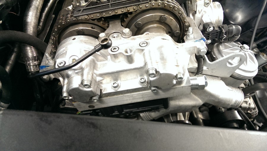

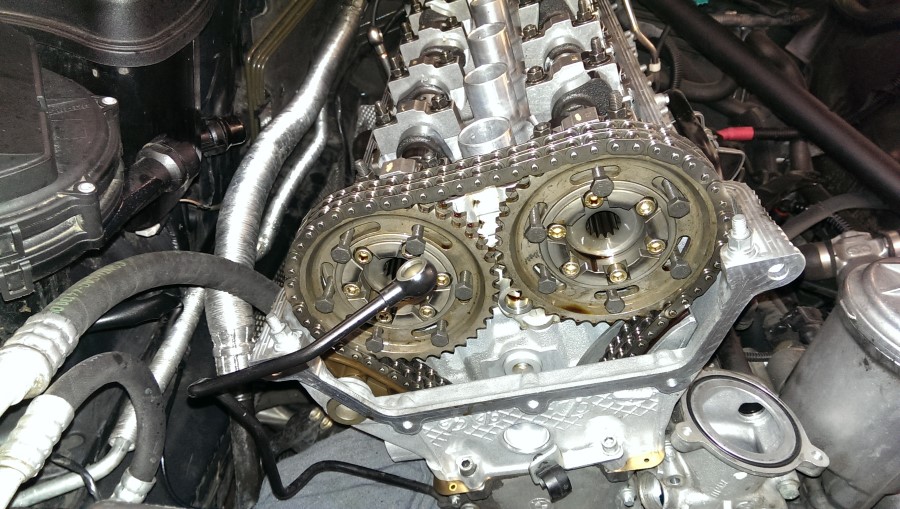

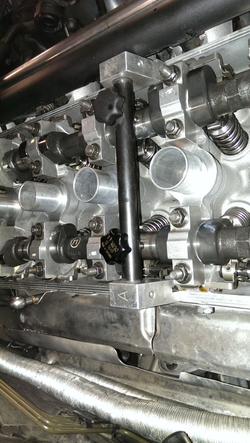

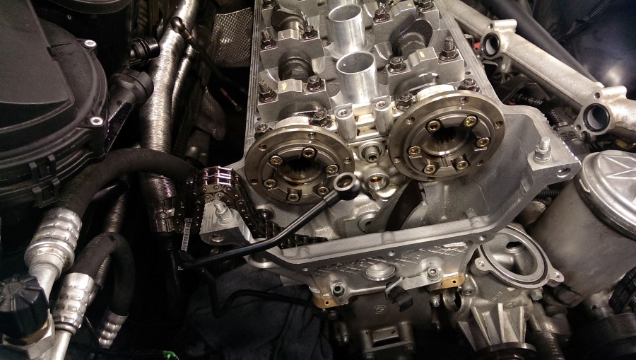

  • Beisan Vanos install – (I did the Vanos work , they just reinstalled the Vanos into the car once the head came back)

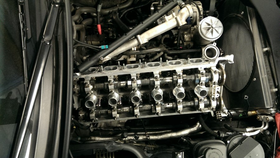

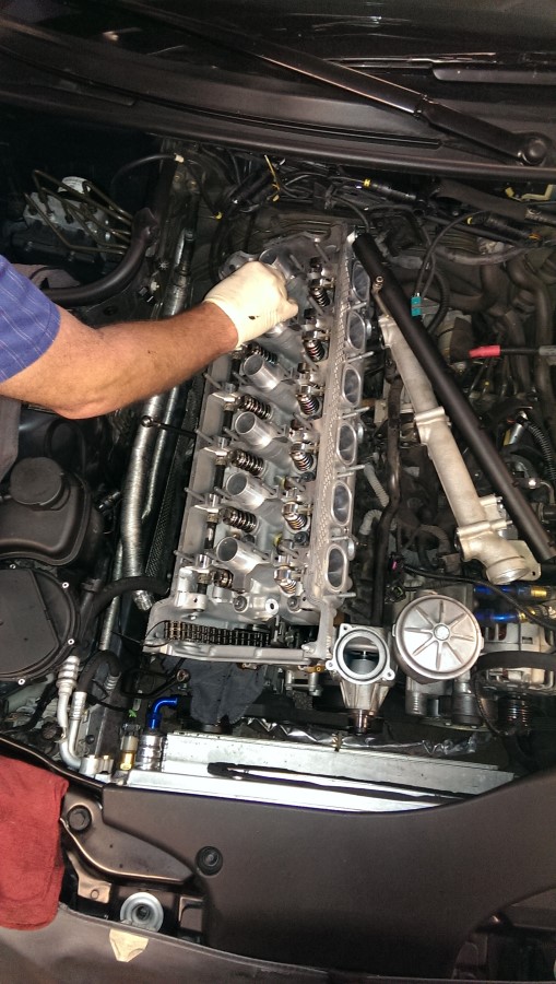

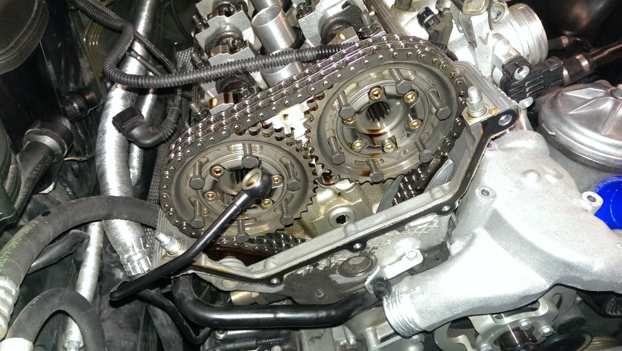

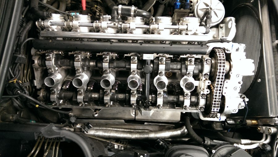

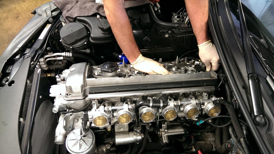

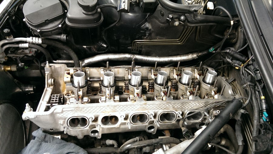

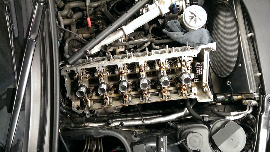

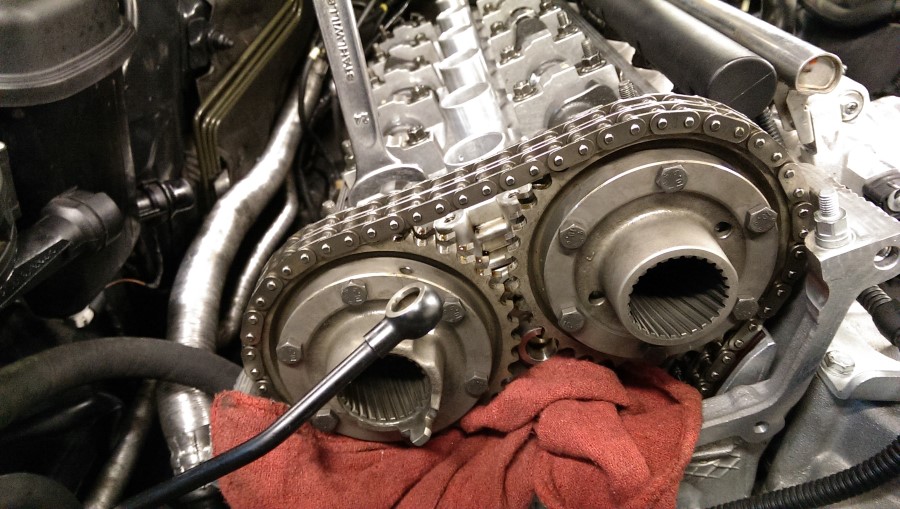

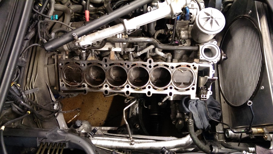

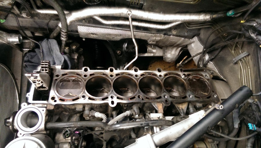

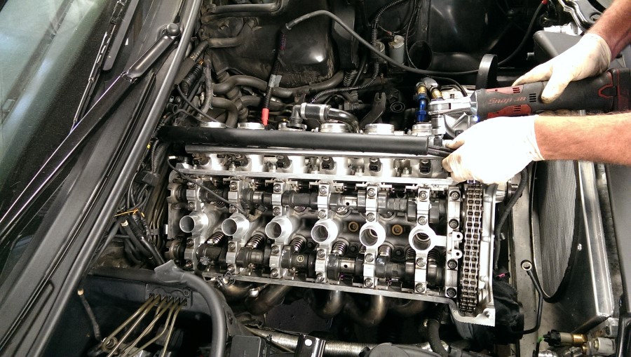

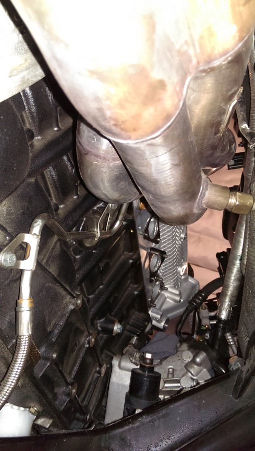

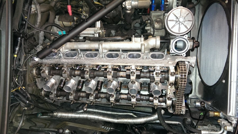

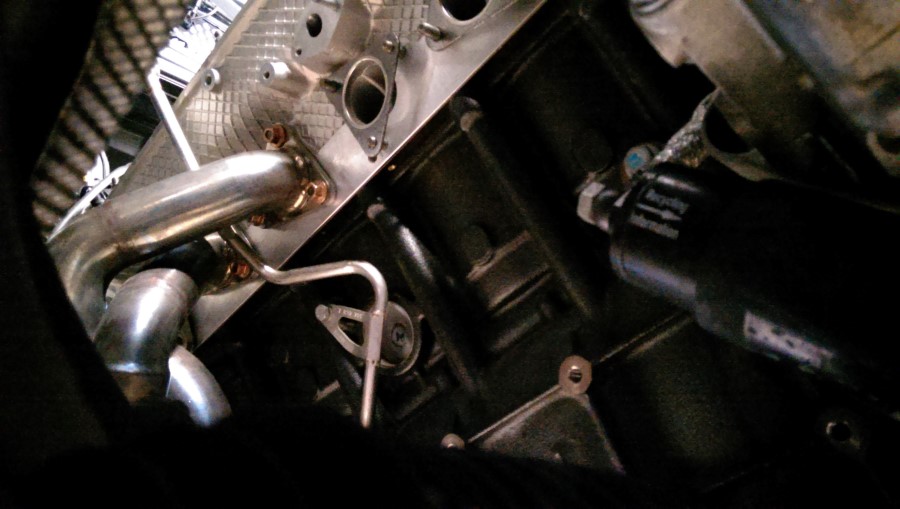

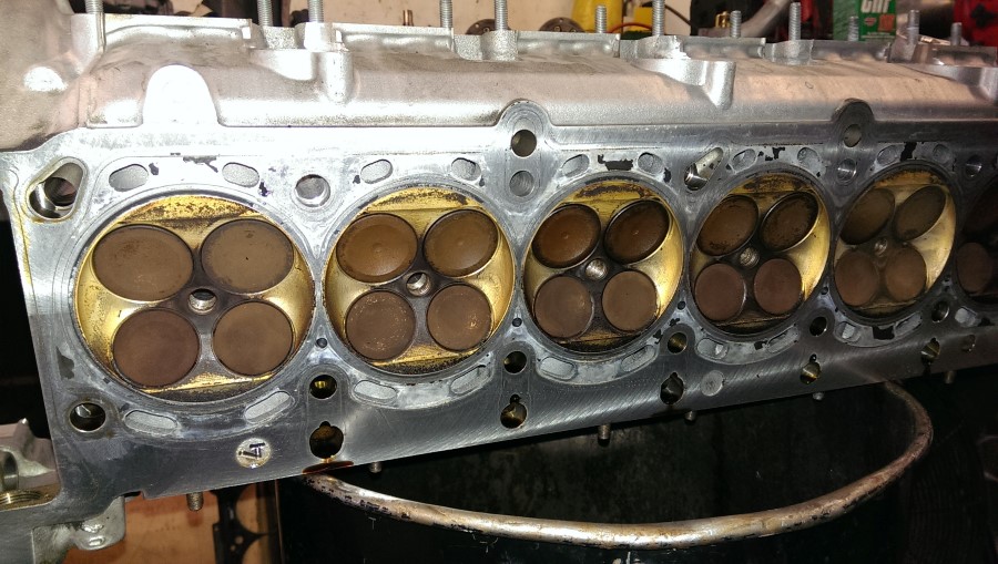

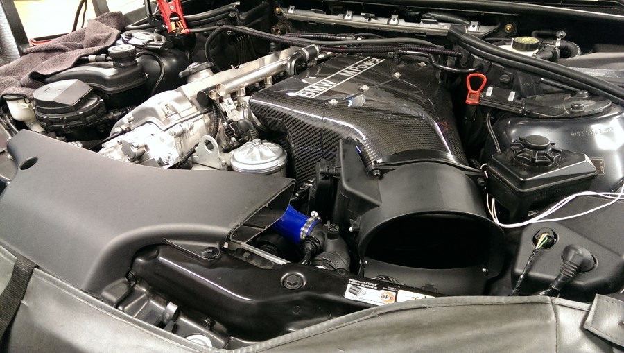

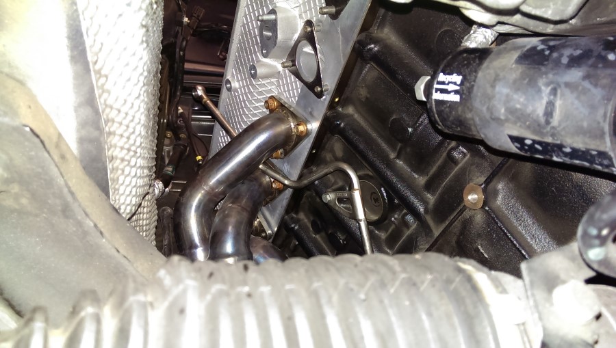

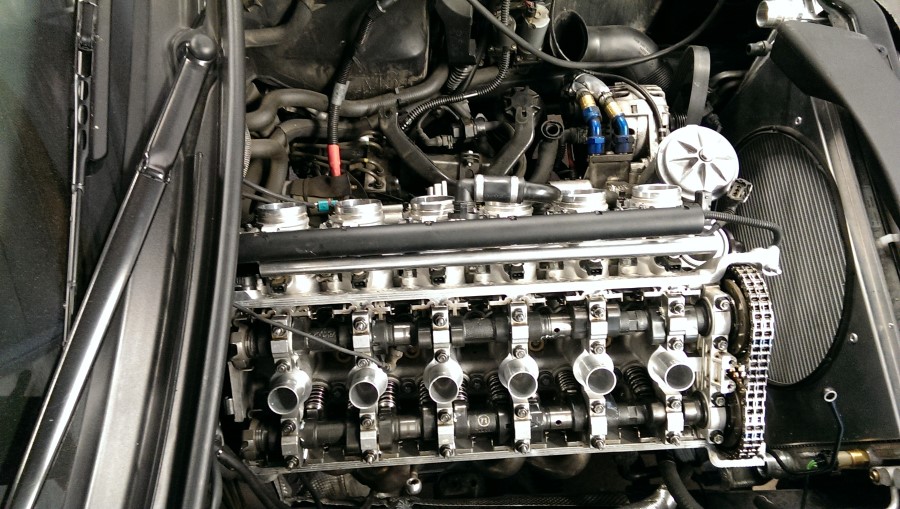

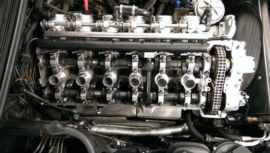

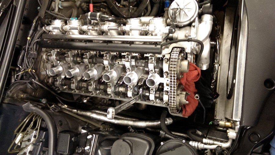

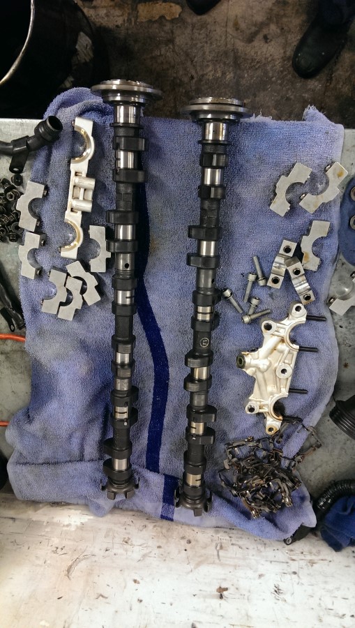

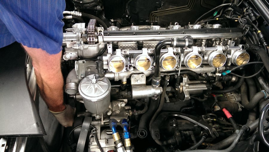

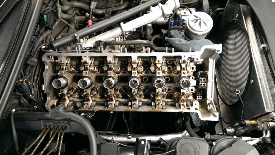

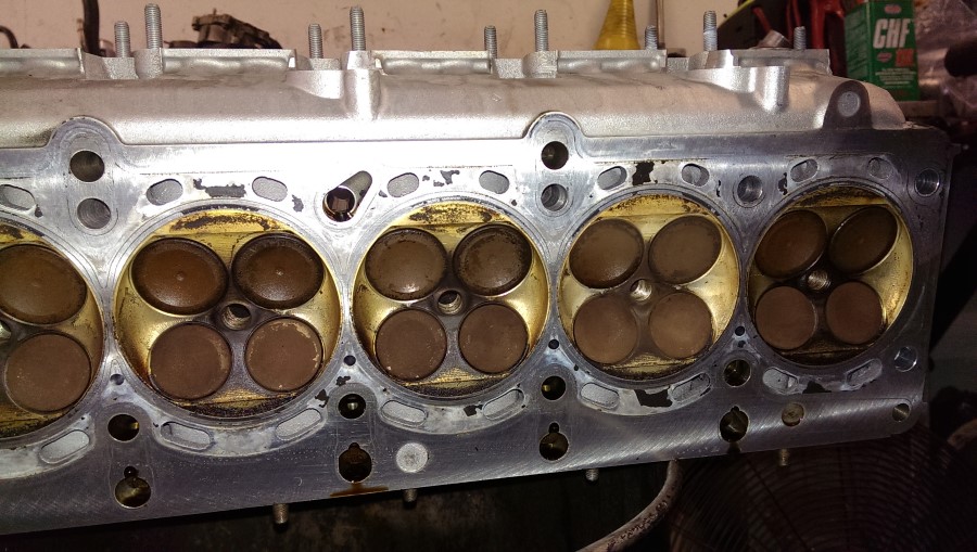

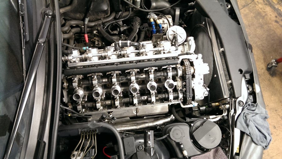

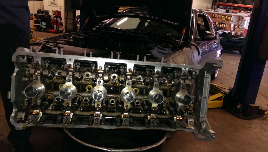

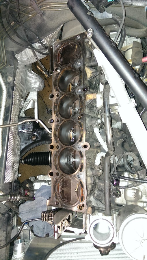

Head tear down and removal
Head tear down and removal part 2
Not a pretty sight to see her in so many parts and pieces =(

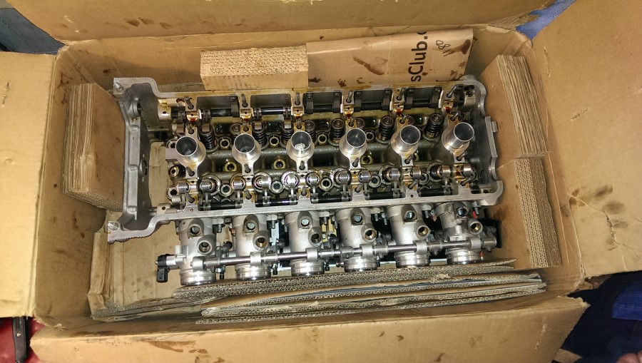

All boxed up and ready to go to LA.
m3dragon

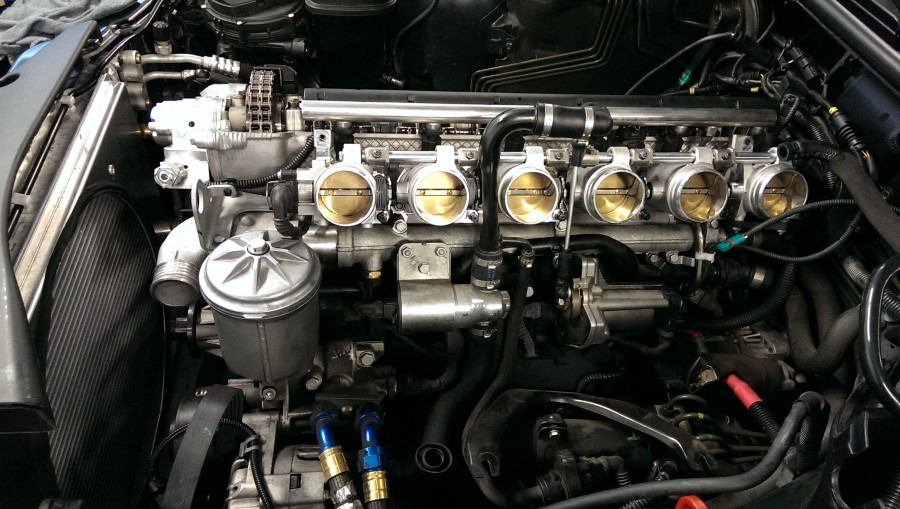

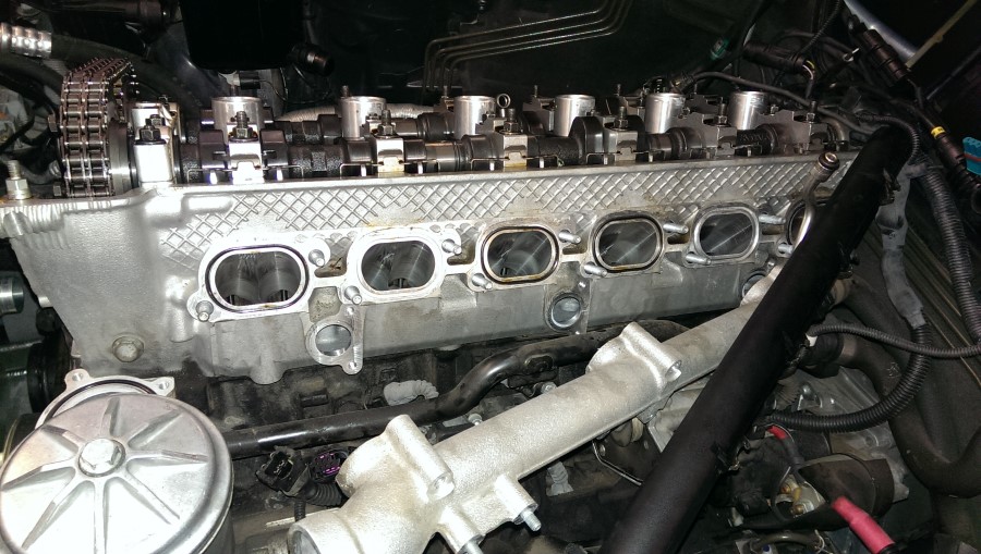

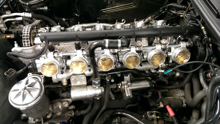

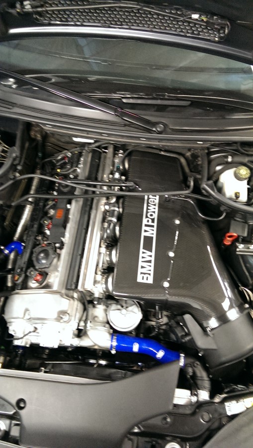

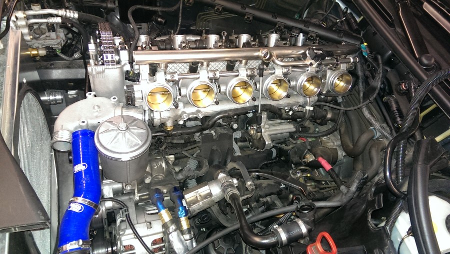

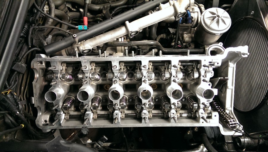

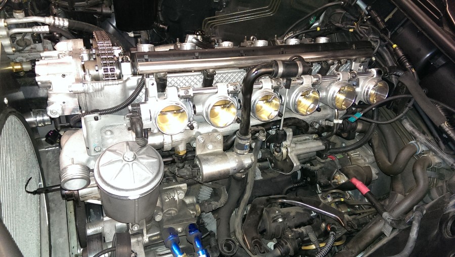

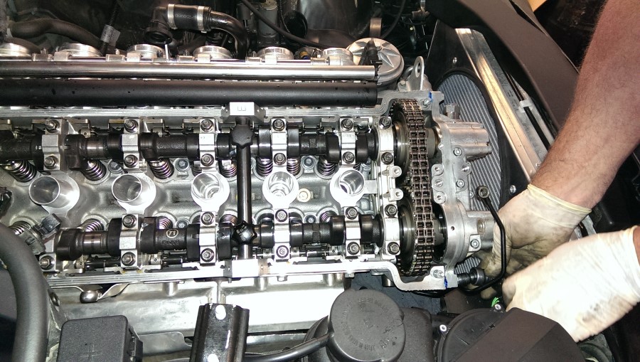

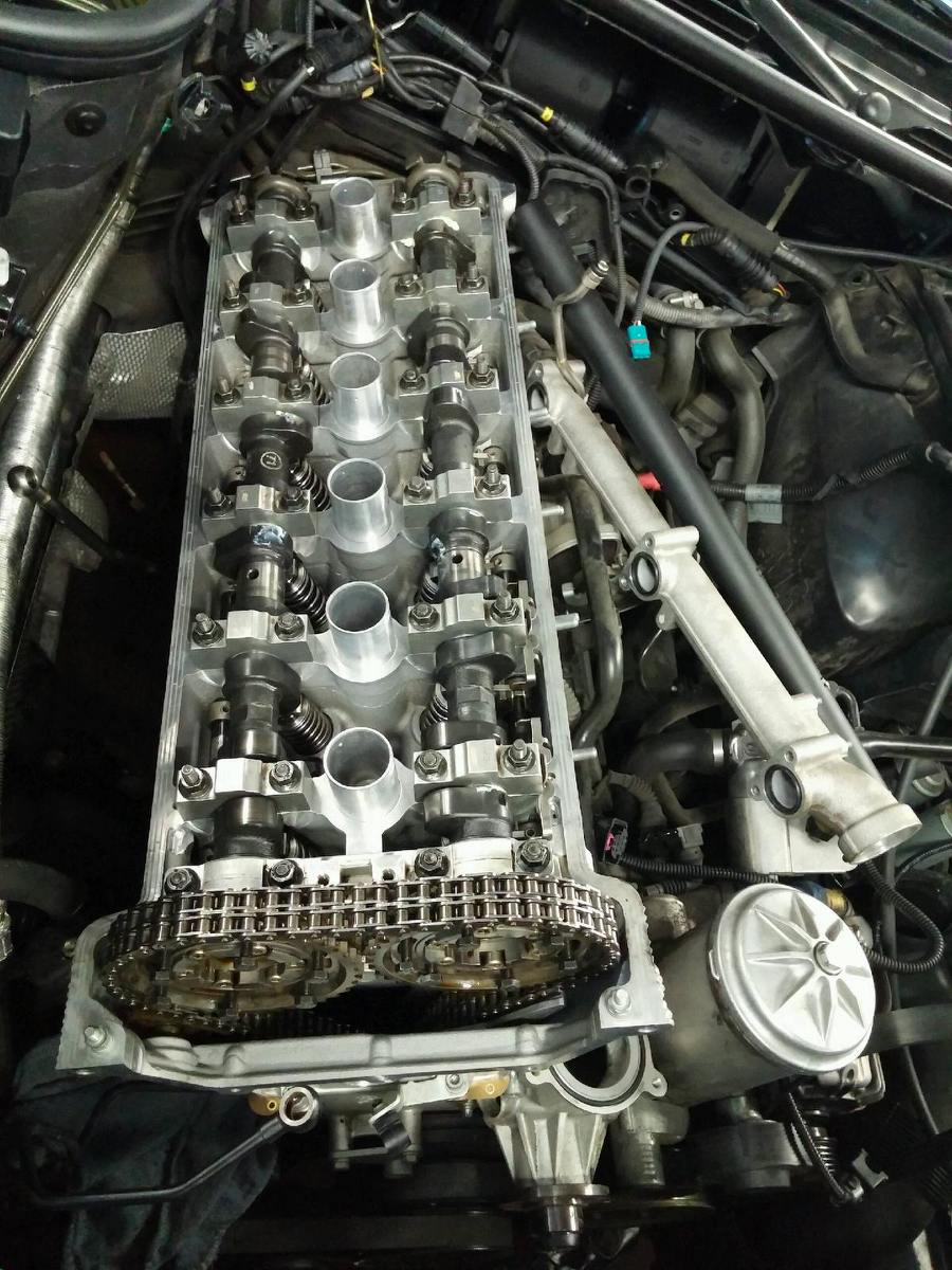

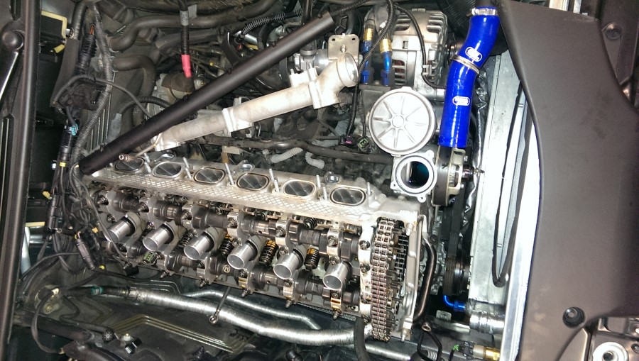

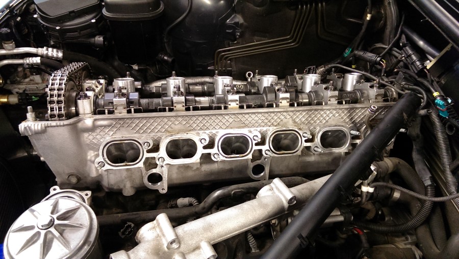

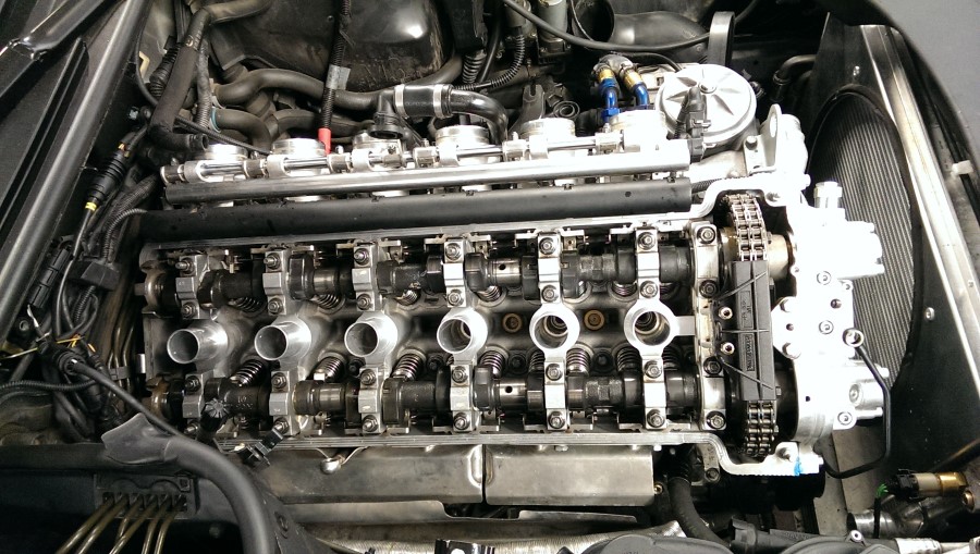

Head back now and now the rebuilding can begin WOOTTT.

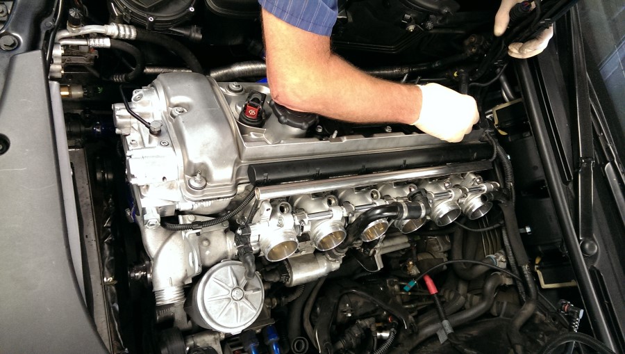

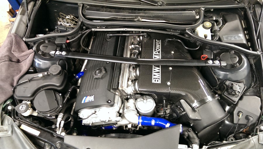

Took about two weeks for all the head work to be completed and another two to have it reinstalled along with all the other work.

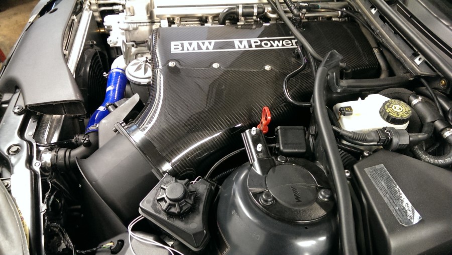

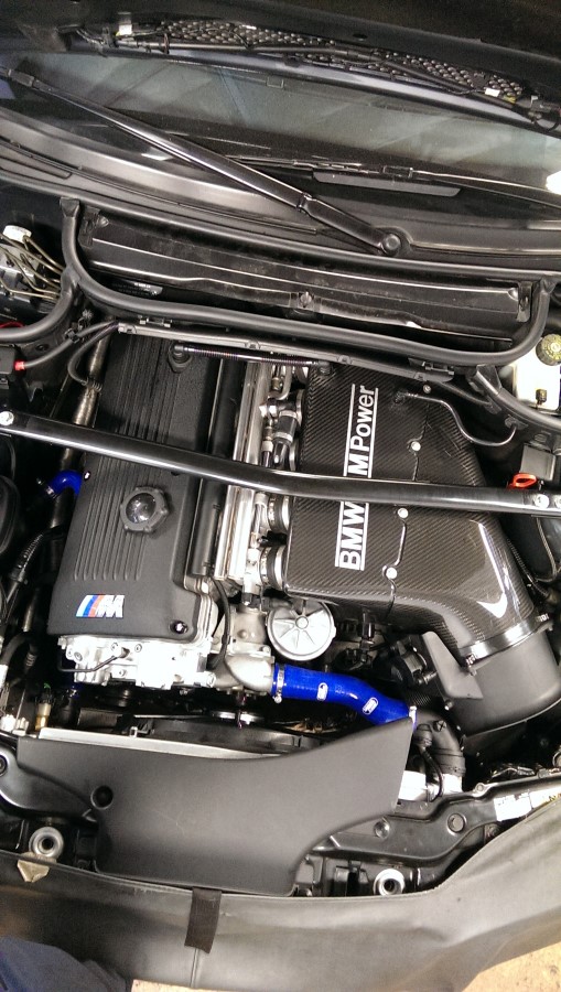

SHE LIVESSSS AGAIN

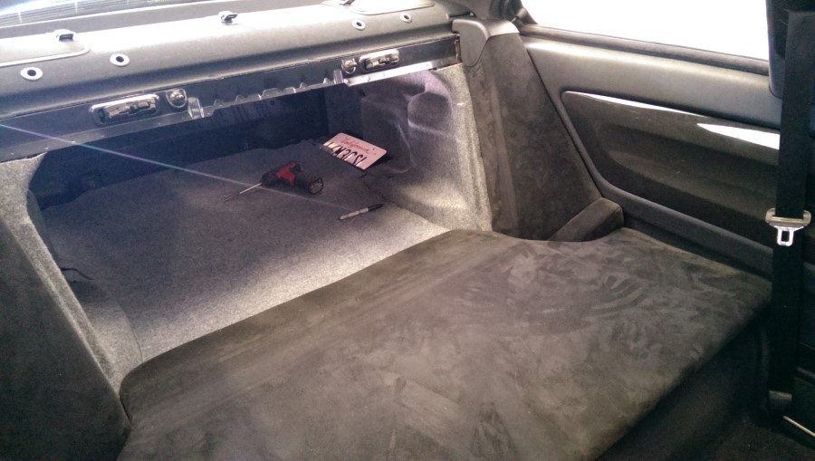

CSL Cabin filter goes in to save a WHOPING 8LB...
m3dragon

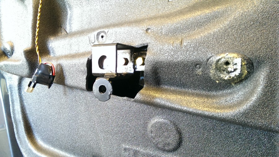

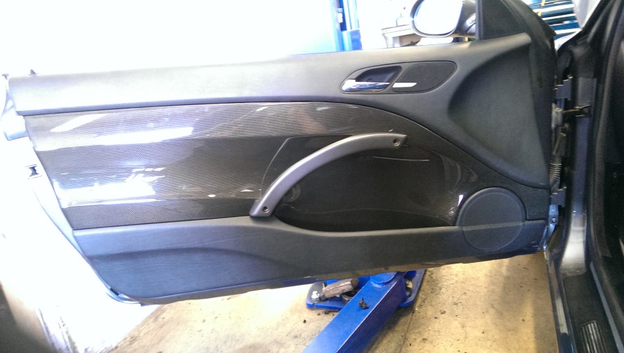

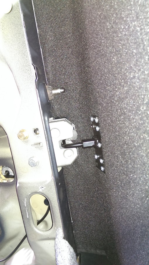

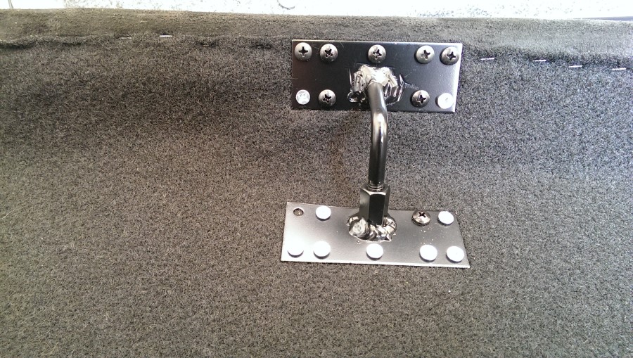

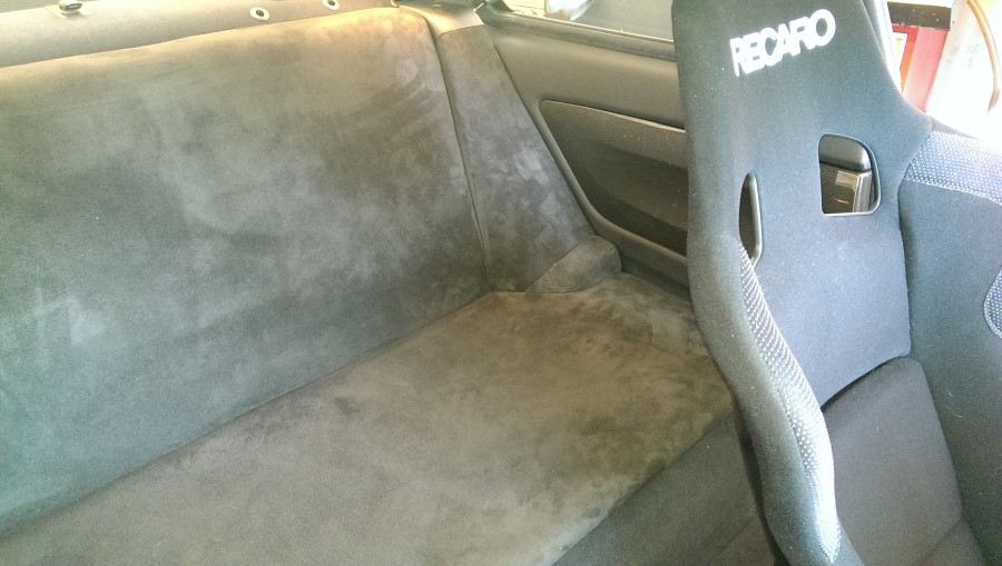

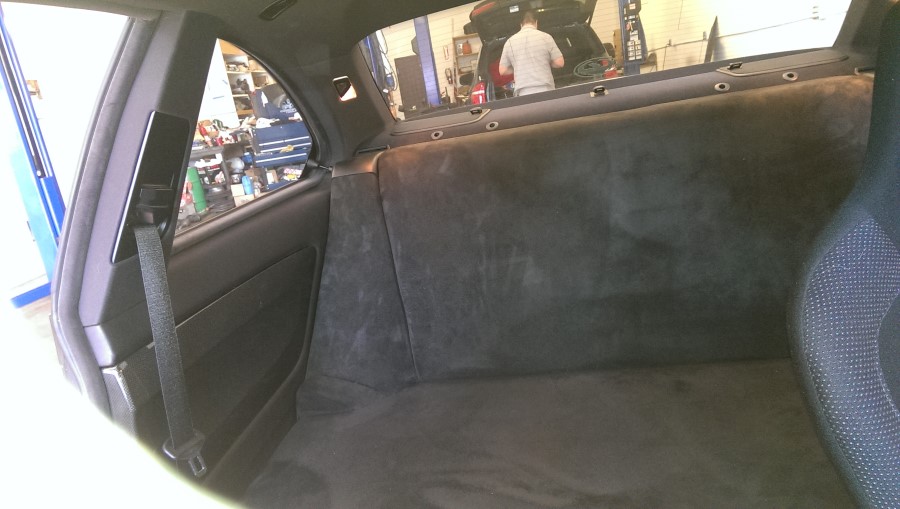

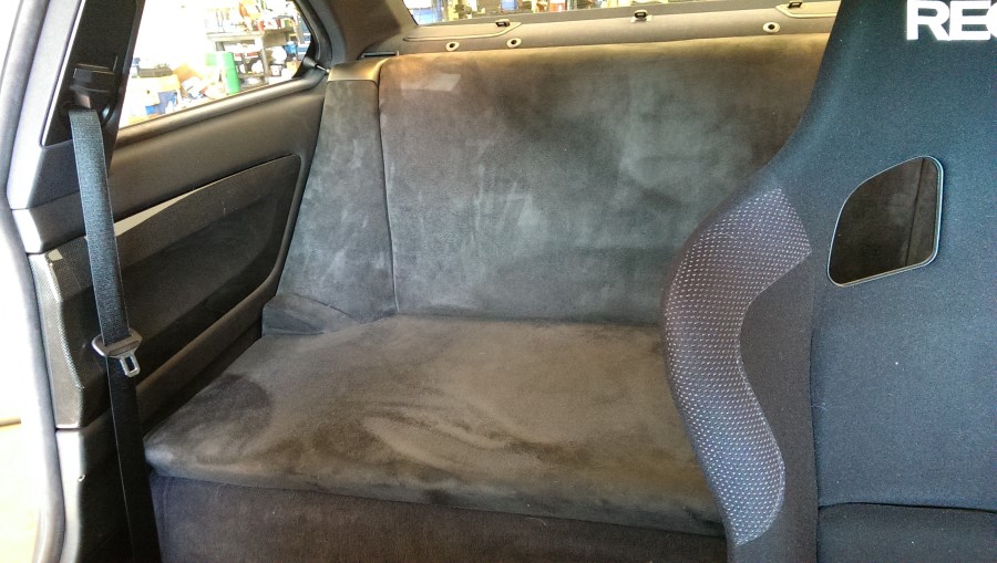

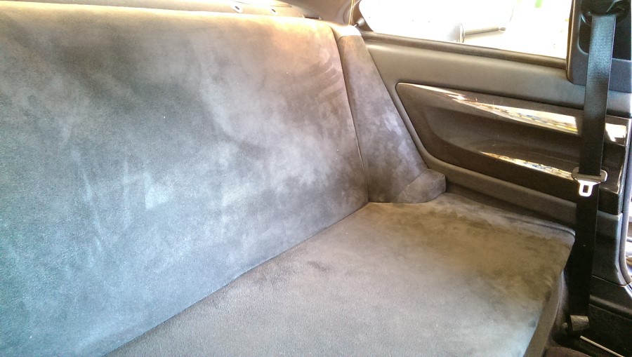

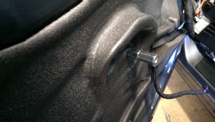

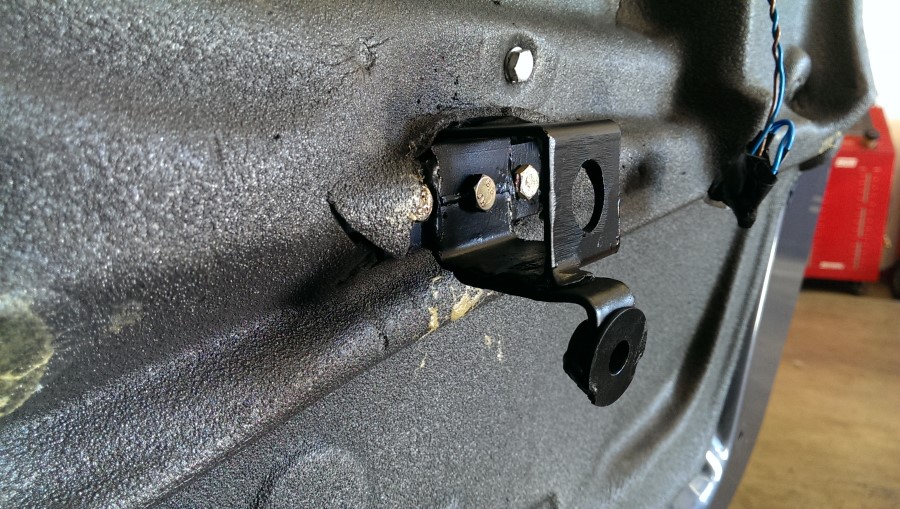

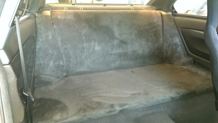

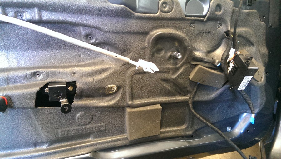

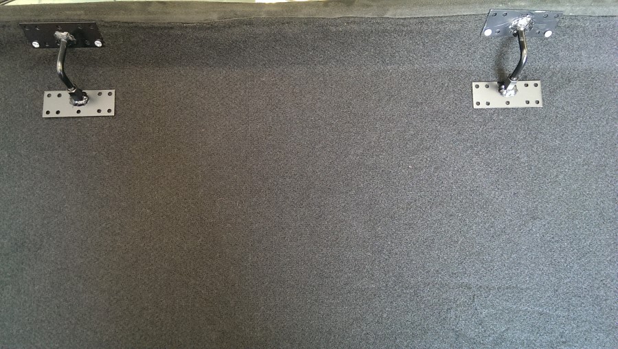

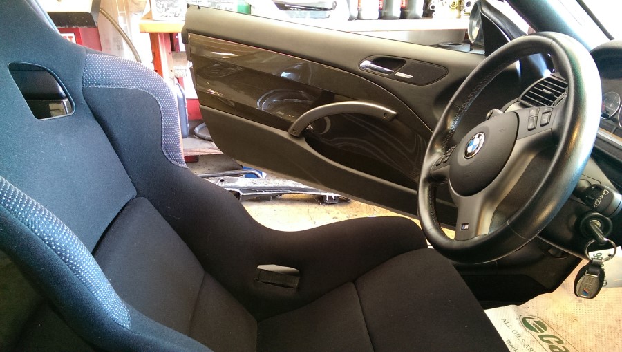

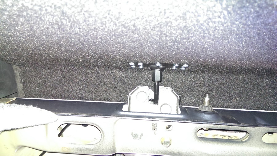

Last set of images of the brackets that were fabricated to make the CSL door panels and seat delete fit correctly. Amazing work was done to get it all tight and locked down.
Last update for the day. I picked up the car and fired her up and notice that she has a slight growl now, almost V8-esk. This is not bad but as it has been a while the only thing I can think of is it might be the valves giving it more GRRRR. Driving the whole 15 miles home the car felt very dialed in, very responsive and just happy. Now keep in mind I still have no tune installed and am running all CSL software. When I accelerated on to the freeway the car on the freeway just kept going like a freight train as I hit 80 and then slowed down.

CSL Valves:
As we all know the CSL had different exhaust valves. What I have noticed after putting on about 280 miles is the car has a deeper idle note. As mentioned in m build thread, almost has a V8 tone to the exhaust now. This of course could all be in my head but that is what it sounds like. As for performance I could not tell you a difference as the car goes like a scolded cat. On the drive the car pulled hard out of the corners and was not lacking in power. One of the cars behind me was a 1M and I could keep a good lead on him out of the corners.
Conclusion: increase in power is unknown but the sound note has a definite change.
