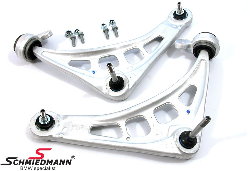

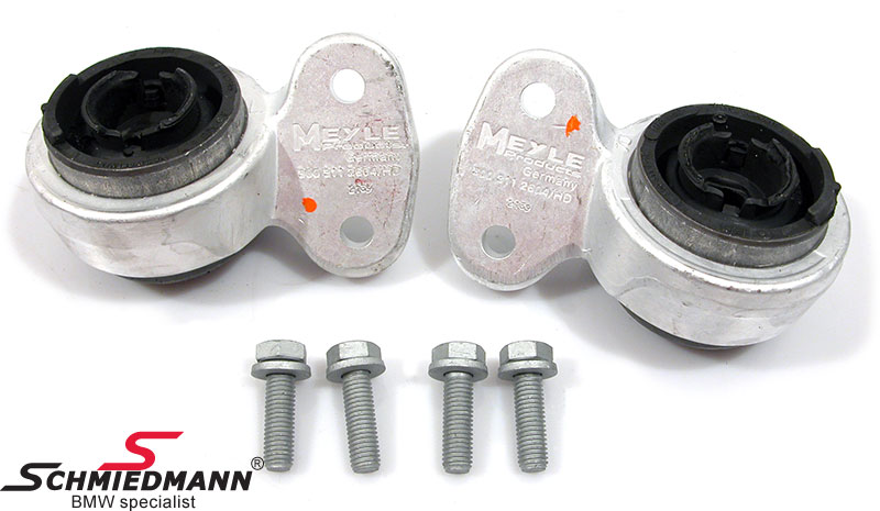

I settled for the Meyle because I wanted my car to be as close to stock as possible, and I didn't want to compromise on comfort, or run the risk of breaking anything on the suspension. And the Meyle Ball Joints are better then the OEM ones. Also the Meyle Control Arms are the only ones where you can actually replace the ball joints, and not have to replace the whole arm. You can buy the ball Joints from Meyle and they sell the replacement tools too. BTW, I read somewhere that the Meyle bushes are 30% stiffer than OEM.
I bought a full set (both sides) of Meyle HD Control Arms and Bushes (they come in their brackets so there's no press fitting to be done.)

The Meyle HD parts are more robust that the OEM stuff. Bigger and thicker, which allow the ball joints to be refitted, something that is definitely not recommended for the OEM parts.
Replacement is quick and easy too. A pickle fork makes it really easy and I would say a neccessity to do a neat job.
You can save some time by not removing the thick brace/bracket (can't remember what it's called) from the bottom of the car but just loosening it sufficiently to allow you to remove and replace the bushes.
