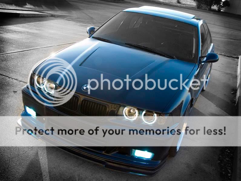

that sounds awsome, I have noticed that the projectors in the E36 are open projectors and the ones in an E46 are closed projectors with much bigger magnifying glasses, the ones that you would put in the E36 would they have larger magnifying glasses as that looks awsome. I have attached a pic of what I mean.
If thats what you can do to my headlights then I will become a customer very soon :) I dont care about the angel eyes that I can do myself, but those insane projectors with massive magnifying glasses is what I am after.
Let me know if this is what you can do. :)
osiris
That is AWSOME, and you say the xenons are 6000k colour temp? my last xenons were 8000k, loved the colour but if your putting a proper closed projector unit in there thats actually built for a xenon capsule then I rather go that route as it will give far better light output and wont blind other drivers!
