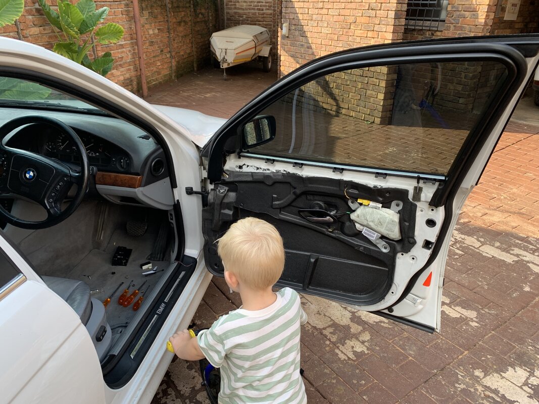

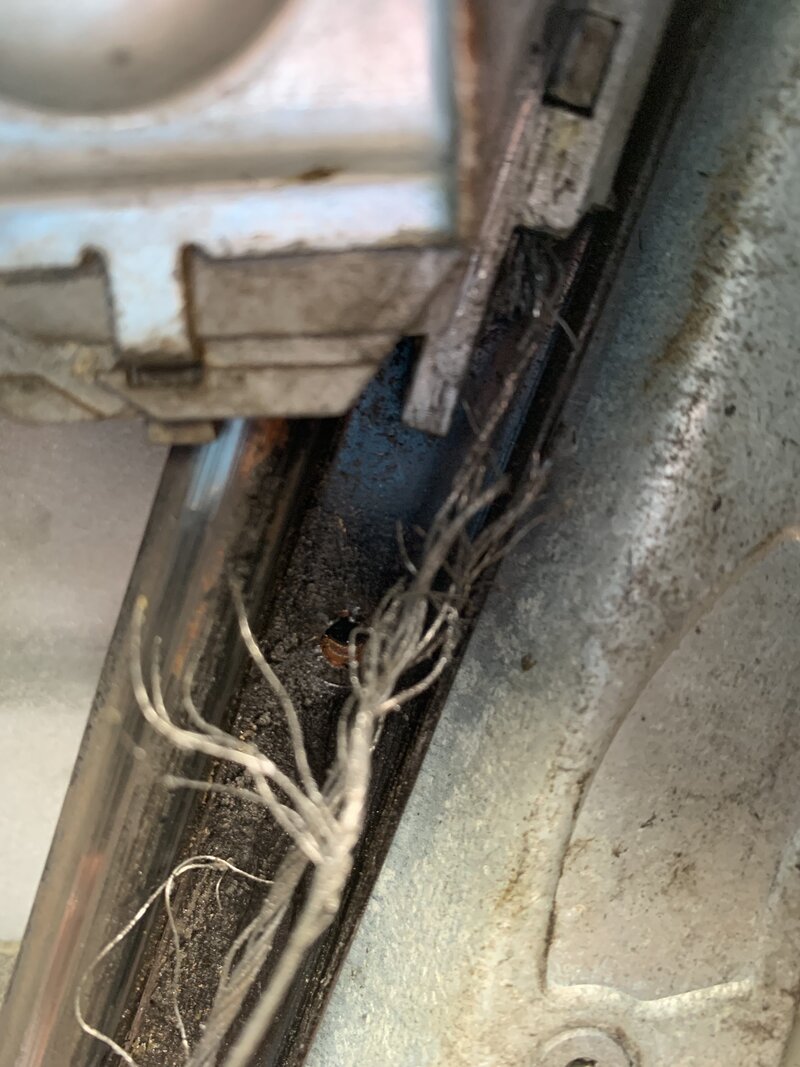

On Monday my drivers side window decided would only go down 5cm or so, at least I could close it again. Had a look on Youtube and removed the panel and cover to have a look at the inside. Time was limited so I did not remove the airbag.

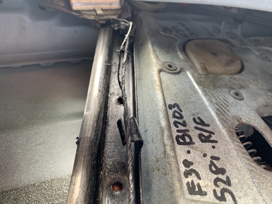

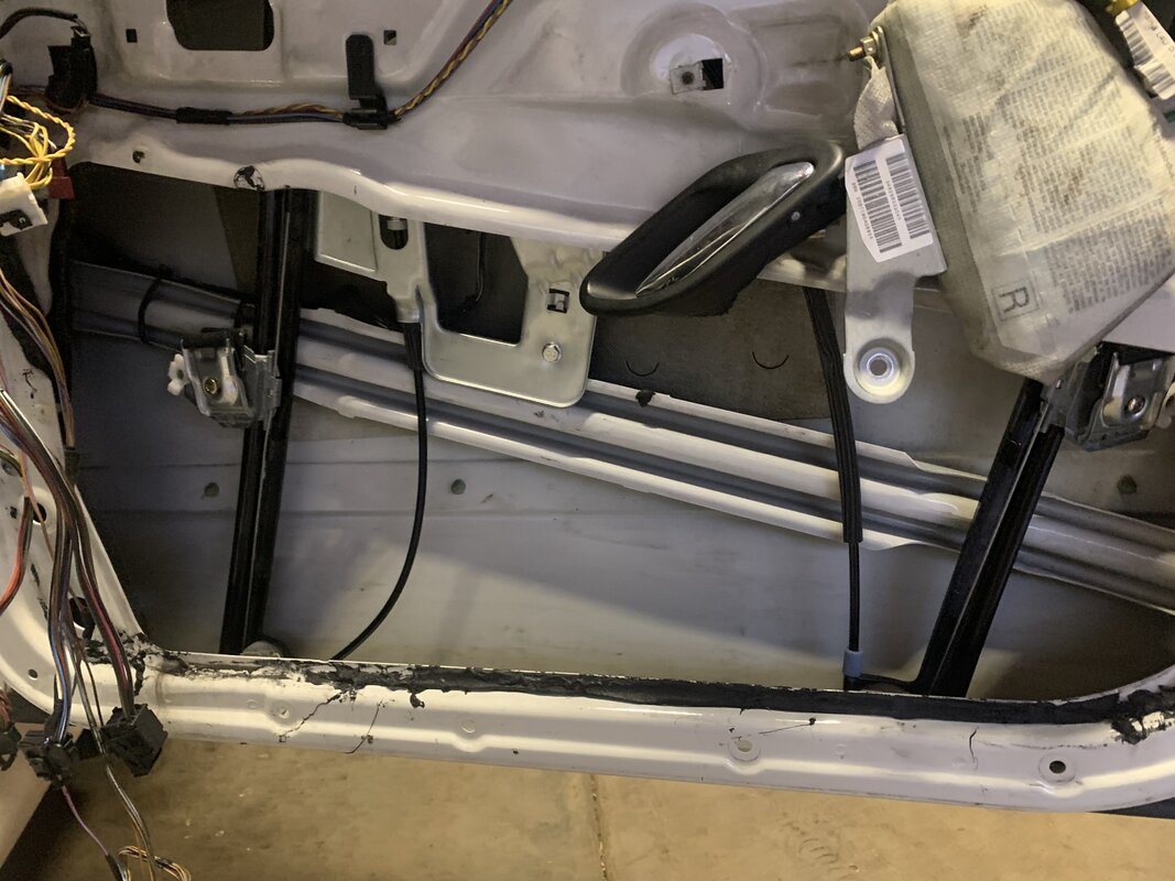

Seems like the cable is moeg. When I have more time perhaps Ill try and remove the entire regulator and see if its only the cable that need replacing, but if a new unit aint too much I might just get a new one.
Do I go Goldwagen or would OEM be the best bet? Two of the clips on the bottom that clicks the panel back into place also broke so I would need to replace those also.
Benji
Doesnt look like it is the first time it has been changed...Might be worth buying from GW since they have Febi which is not the worst quality
Mytfine
Alot of people do not clean all the channels when putting in the new regulator, which picks up all that debris and fails again, buy a couple cans of brake cleaner and its quick work.
