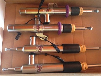

I bought this kit in November 2013 and have had an absolute blast with it.
KW DDC coilover kit:
According to KW: "The KW DDC (Dynamic Damping Control) coilover kit with ECU (Electronic Control Unit) was developed for individual lowering and installation of an electronic damping control system. The scope of delivery contains a KW inox-line coilover kit with electronically controlled dampers, a high-performance control unit, the car specific cable set with control switch and a detailed manual for an easy installation. The KW DDC coilover kit has three car specific developed damper settings. By the push of a button the driver can choose between the sport basic setup, a very sporty and performance-oriented Sport+ setup and the comfort mode for uneven/ poor road surfaces. The height adjustment of KW coilover kits also allow an individual lowering within the TÜV-tested adjustment range."

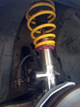

Also swopped out the 335 spring strut (right) for the e92 M3 strut (left):

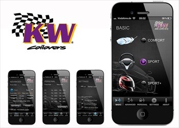

KW DDC ECU W-LAN Modul / App-Control:
"With the KW DDC W-LAN module you can control and configure the KW DDC ECU Coilovers via the KW DCC App with your iPhone, iPad and iPod touch! The App allows you to program in easy steps five personal damper setups and you also can share them with your friends via e-mail. With the app each axle can be adjusted steplessy between 0% (maximum comfort setting) and 100% (maximum sport+ setting). The communication between Smartphone, KW DDC control device and KW DDC W-LAN module works with a secure WiFi connection."

The iphone app and the KW suspension works very well together. Changing settings on the app with a push of a button is instantly conveyed to the suspension. However, you cannot change the individual suspension settings on your own. It only works while the car is in motion above 30km/ph. Someone has to tweak the settings while you drive the car until you find the desired setup.
