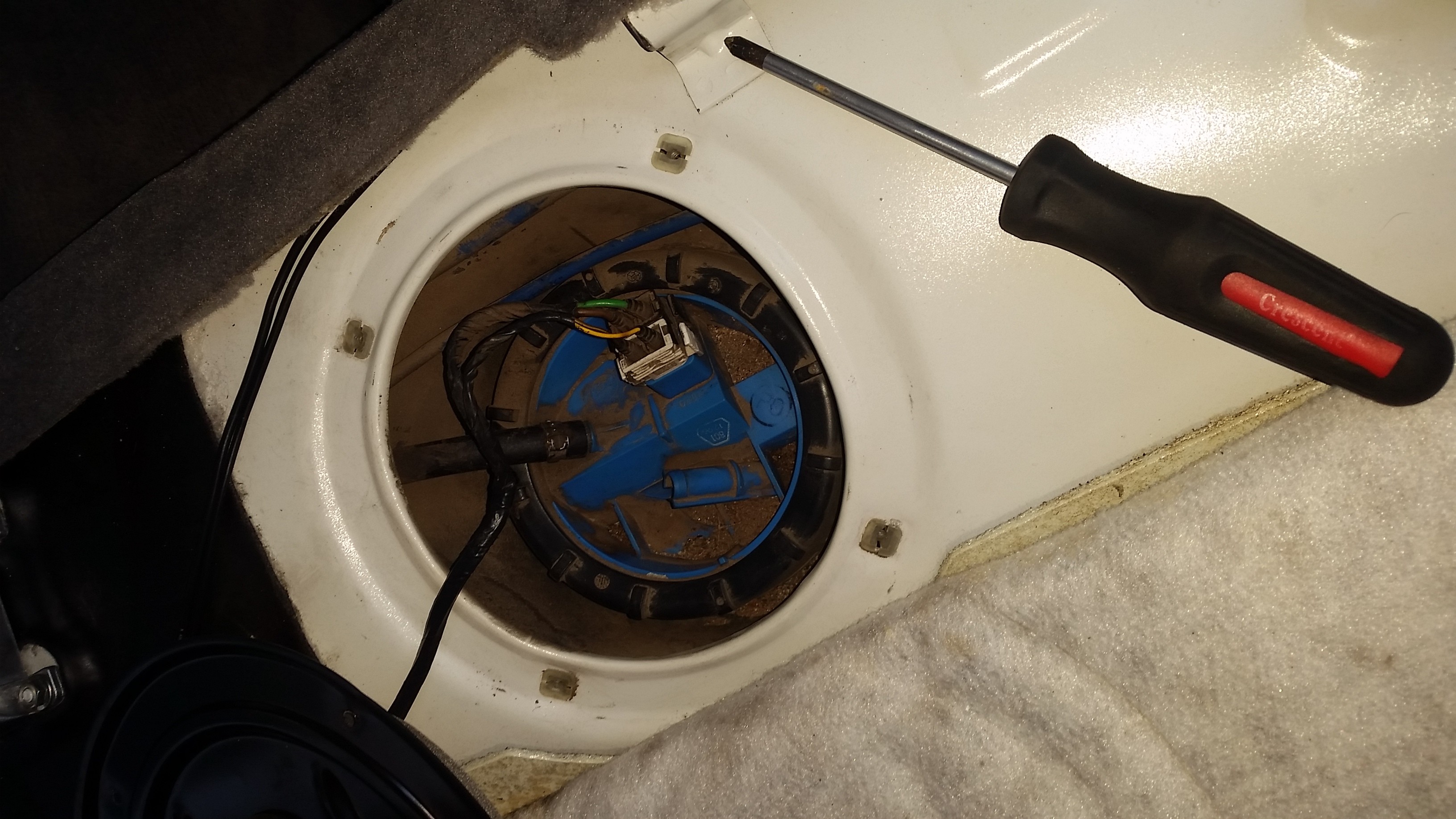

So Nikz replaced the fuel level sender in the Tank but the fuel gauge still does not work.
So i will have to buy the level sensor on the fuel pump.
Do i buy the complete pump or can i get the Housing separate with the sensor?
Gizmo
Banned
He replace the LHS one, the RHS one is the one that goes to the cluster gauge.
The fuel pump/sender unit is one piece unfortunately.
Sometimes its just a case of the wire inside has broken off and just needs to be soldered back on.

I checked the impedance on the LHS unit and it was reading 2 Ohms when moving the float from full to empty so that side was also shot:hammerhead:. I had a look at the RHS unit and wiring and all the wires and solder joints are intact. :coolShake:
But did you measure impedance on the RHS sensor?

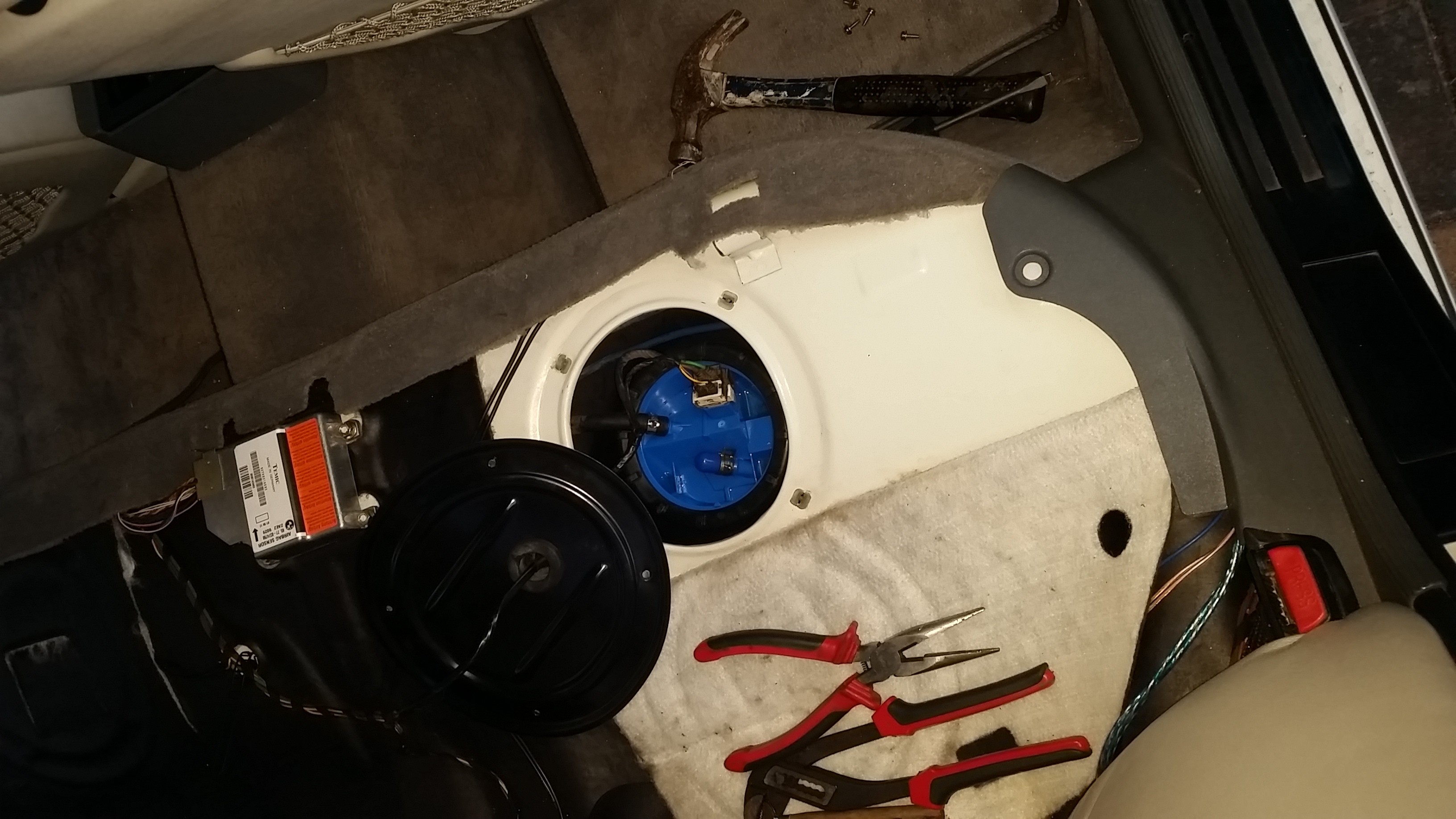

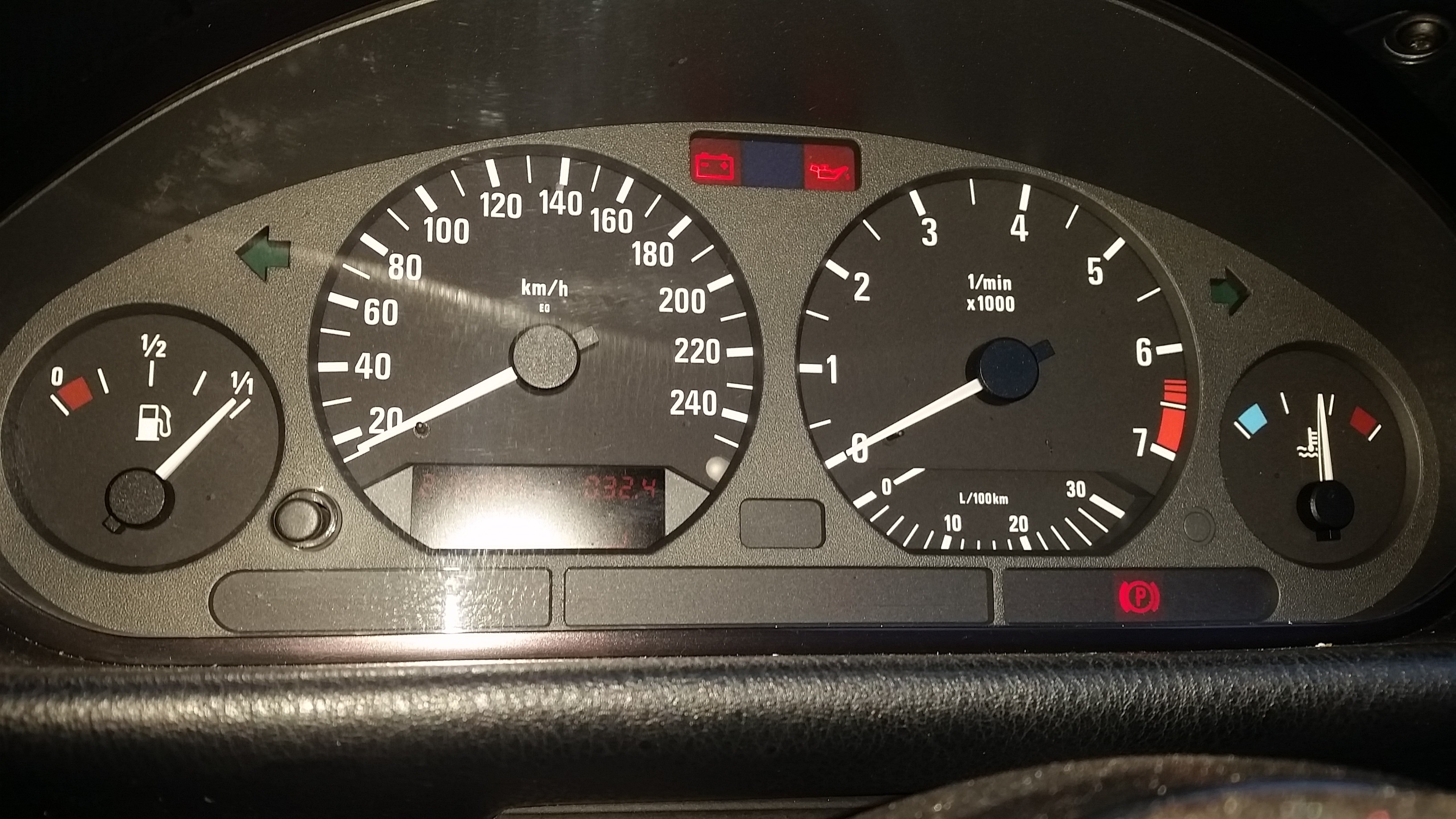

So its been a while since the last update, the car had a faulty fuel gauge and a slight misfire at low rpm so Karsh bit the bullet and got a new pump which I installed a week or so ago :rollsmile:
Clean and sealed :=):
Yay working fuel Gauge:rollsmile:

So the new fuel pump made a massive difference to performance and the car no longer has a misfire, it is also happier to rev :rollsmile:

oh and if you plan on replacing the fuel pump please don't fill up the tank or you will get high as f#$%^ on the fumes

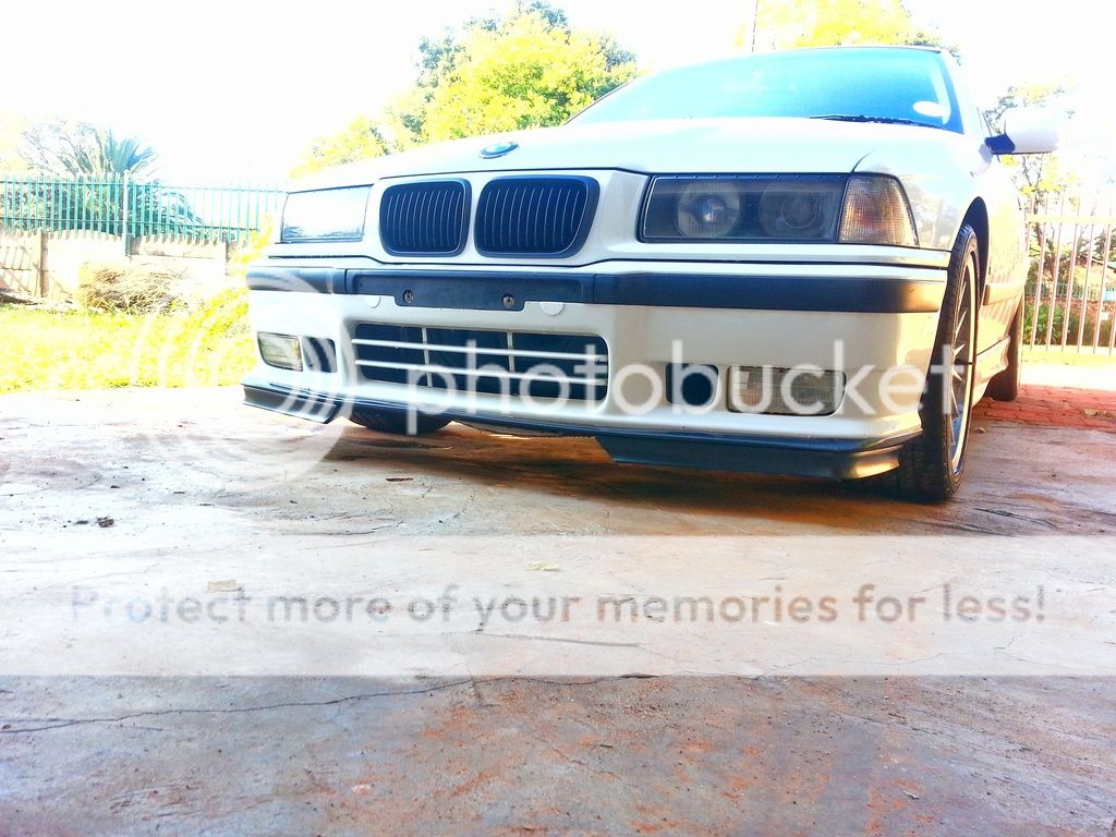

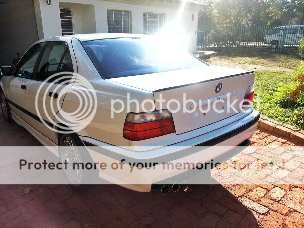

So i plasti dipped the kidney grills.
Added plastic GT splitters and a slim line rubber bootspoiler :rollsmile:
