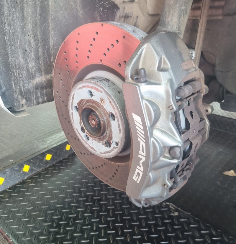

Unfortunately, the rep at Mercedes ordered the incorrect pads which resulted in a 2 week delay to get the parts. I had the disks replaced in the interim as they were in dire need of replacing and got the old pads cleaned up and put back on. In the 2 weeks of waiting, the new disks developed a lip around them and I wasn't too happy about that. I knew it would happen but I had no other option at the time.

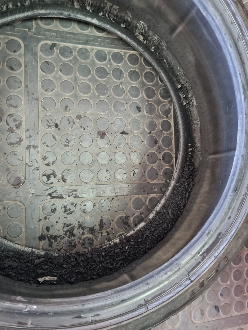

It's very likely that I did drive around with a low tyre for quite a bit and that the rim is the cause.Very strange failure that. I suppose you rode on the low tyre for a while, which resulted in the the rubbing (evidenced by particles) and de-lamination?
It does seem that that specific rim is the most likely cause, IMO.
The issue I'm having is, if the rim is undercut, can it still be repaired?

Next up was the recurring low tyre pressure warning light. Took the car to Tiger Wheel & Tyre, Berea, East London to get it checked out. They informed me that the front left tyre was incorrectly fitted, so they took the wheel off and installed the tyre correctly and sent me on my way.
A few days later, the light came back on. I checked the tyre pressure and it was low. So I pumped it up and drove around for a bit. The car was fine for a day or so until I started noticing that something was very wrong. The ride was bumpy and unstable. Took the car straight back to Tiger Wheel and Tyre to get it checked out and this is what we found...
The front left tyre was completely shot! This was extremely concerning as they were brand new Falken tires. The gents at TWT suggested that I send the rim in for testing as they had been refurbished in the past. The results came back and as expected they were slightly undercut however it wasn't causing the tyre to leak.
As replacements for the front two tyres, I decided to go with Michelin Pilot Sport 4S's. Sourced them from Alpha Tyres & 4x4 and got them fitted by TWT.
I've been monitoring the tyre pressure since fitting the new front tyres and all seems well. But I think the rim situation will need to be addressed. Any advice regarding this from your guys experience? Send the rims in to someone experienced or get a new set one time?
