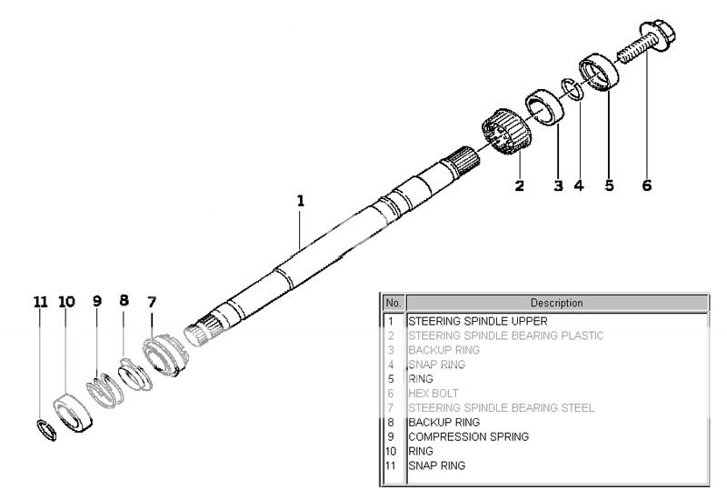

will q20 do a good job? or is there there something better i should use?
And are you guys talking abt these two 'couplings'?
part 3 and 5
you should be able to get to it by just removing the plastic cover over the column. If the sound is still there after you lube then its coming from lower down the column. I wud use bearing grease though it may last longer.

Part number 2 is most probably your culprit, common failure point on the steering column as the plastic degrades over the years and begins to fail.
If its your slip ring then take the steering wheel off and move the slip ring by hand to see if its the culprit.
I sprayed number 2 and 7. After sprayed well (Half the can lol) take it for a short drive and after a while i promise you it will be silky smooth with zero squeal. At first just after spraying i turned the steering from side to side in my garage and thought it didnt work :argh: then went to the shop to get a few things and :rollsmile: good as new.
No that's the lower steering column.

Thanks guys sprayed abt half a can and the noise is gone!:joy: but i didnt take the steering wheel off just the the column covers and sprayed from the bonet side aswell
