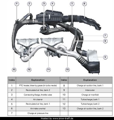

See restrictions on stock pipes
Vargas pipes
