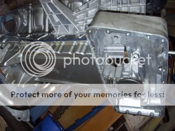

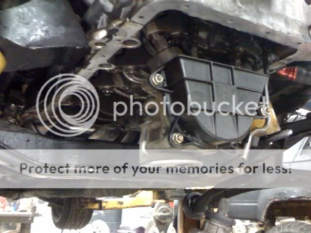

The oil pump and sump on M60 can't be in a worse place....
I'm looking at geting a Moroso dry sump kit to get the engine in my e36....
Budleigh
Yeah, you'd need to fabricate a new sump, but that's what Alpina did for the B8, or whatever it was called, so if you got the specs on that, it might help.
WerriesM5
You have to mod the sump and oil pump....
Alpina used a custom pump and sump (smaller) but also used a custom anti roll bar and steering rack to get the engine as far back as posible.
I want the engine alll the way back but I am not going to mod my steering rack... so I'm moving the whole oil pump to the rear of the engine and new sump.
Or dry sump ang get the engine lower.
Alpina oil pump body is infront of chain
BMW M60/2 oil pump is behind chain
