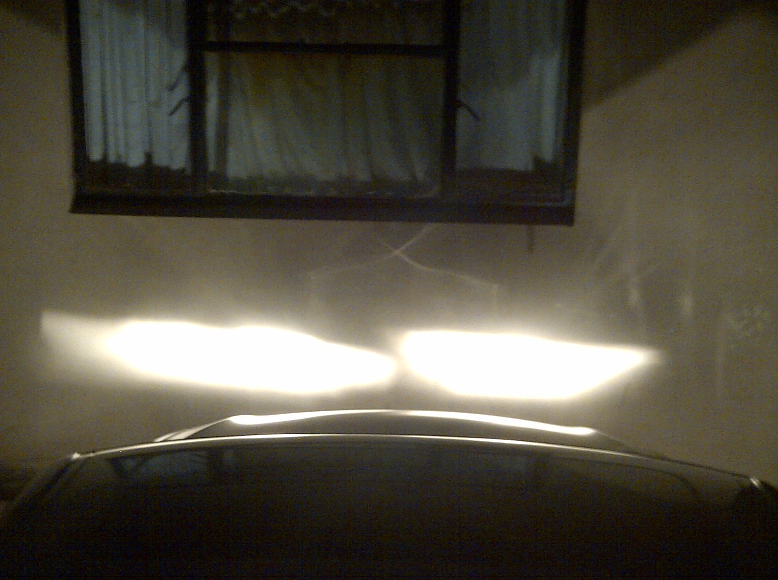

First I need to focus the lights, any idea on cost or can I do it,

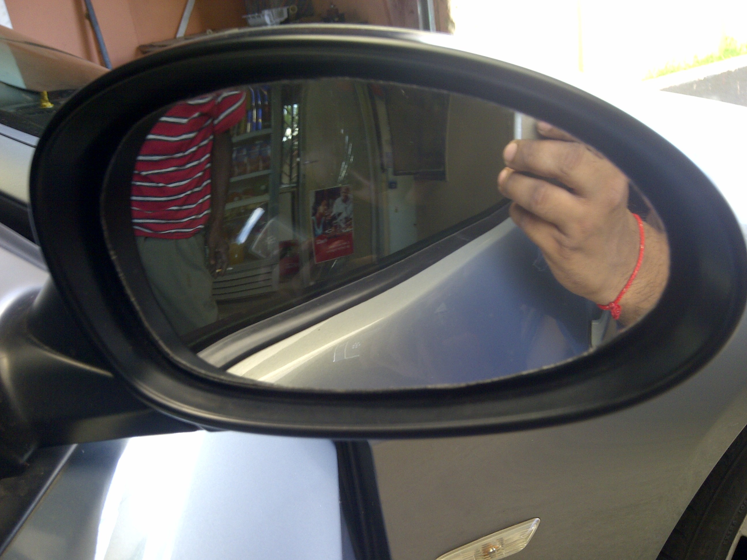

Then my door mirror is cracked, what can I do, was thinking is there like a mirror film that we can stick over the glass,

1) on setting the light focus....I am sure Youtube is your friend, should be a DIY

3) Buy an aftermarket mirror from Midas and stick it over/ontop of the existing cracked one

Lights already busy reading, seems it can be adjusted, I wonder if that idiot first checked the inside switch which controls the lights level. :RedNo:
I wonder how much that mirror cost, I know its abit hard to get as they normally sell the unit.
http://www.autostyle.co.za/car-acce...essories/universal-car-mirror-repair-kit.html
Okay mirror issue sorted hope this works,

I just adjusted the lights, I dont think with the eye it can adjust 100%, but it was way off, so much better now, will call autostyle in the morning for the mirror repair kit,

Is it the glass of the mirror that's cracked? You used to get just the glass from the agents, but that was on my E46. Not sure about E90. I can't remember what I paid, but it wasn't offensive

Mirror sorted , R60, lol, but not good quality, its plastic, but just to pass this stupid rwc,
See pic of lights and let me know if its adjusted ok,

Dont know if that plastic mirror is going to pass the test, maybe check out a scrap yard, you should be able to pick up one fairly cheap.
Forgot to mention, the 1 series from the same generation used the same mirror - i know because i got my mirror from a scrapped 1 series. :coolShake:
