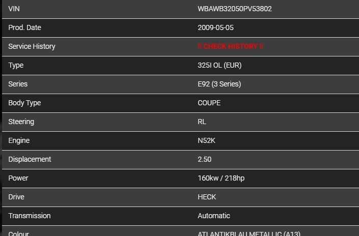

Hi guys need some help from the N52 gurus.
What are the common causes on a wobbly / dip in the revs on idle?
Can be felt sometimes when driving off as well - ill try and upload a video.
Aslo what are the normal revs at Idle on these motors?
