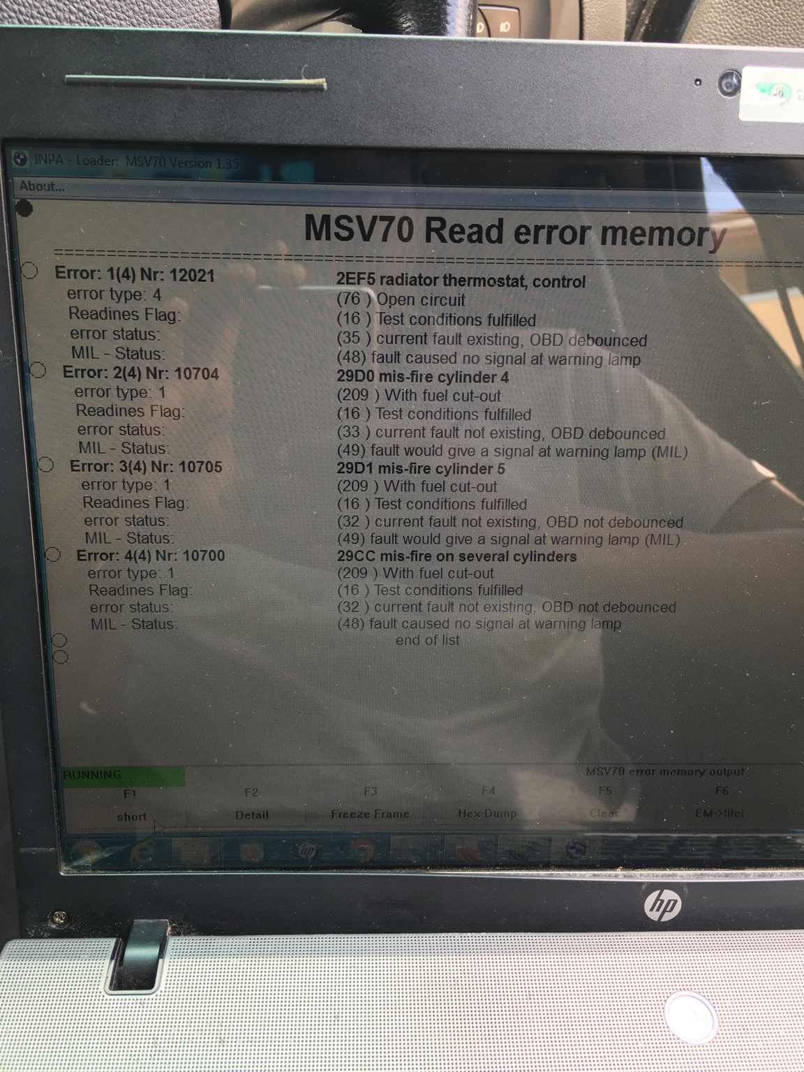

I just check for codes and this is what i got first.
Changed swapped ignition coil with cylinder 1 and took the car for a drive,ran diagnostics again and now i get this,

Im in Cape Town bud,see the pics i attached.

Do you have the DIS software aswell? If you do, run it with that and see what it gives you, will be the same codes but there it will give you guidelines as to how to troubleshoot these problems.
Try that and let us know
Oh and when you changed the coil back to its original location / cylinder did error 29D1 and 29CC come back?

When i changed the coil to number 1,the error did not follow as its still number 4 misfiring and now number 5 and all it say miss fire on multiple cylinders 29CC.
Would all the coils or plugs fail at once?
I am going to try put the coil back on number 4 where it was and see what happens.
