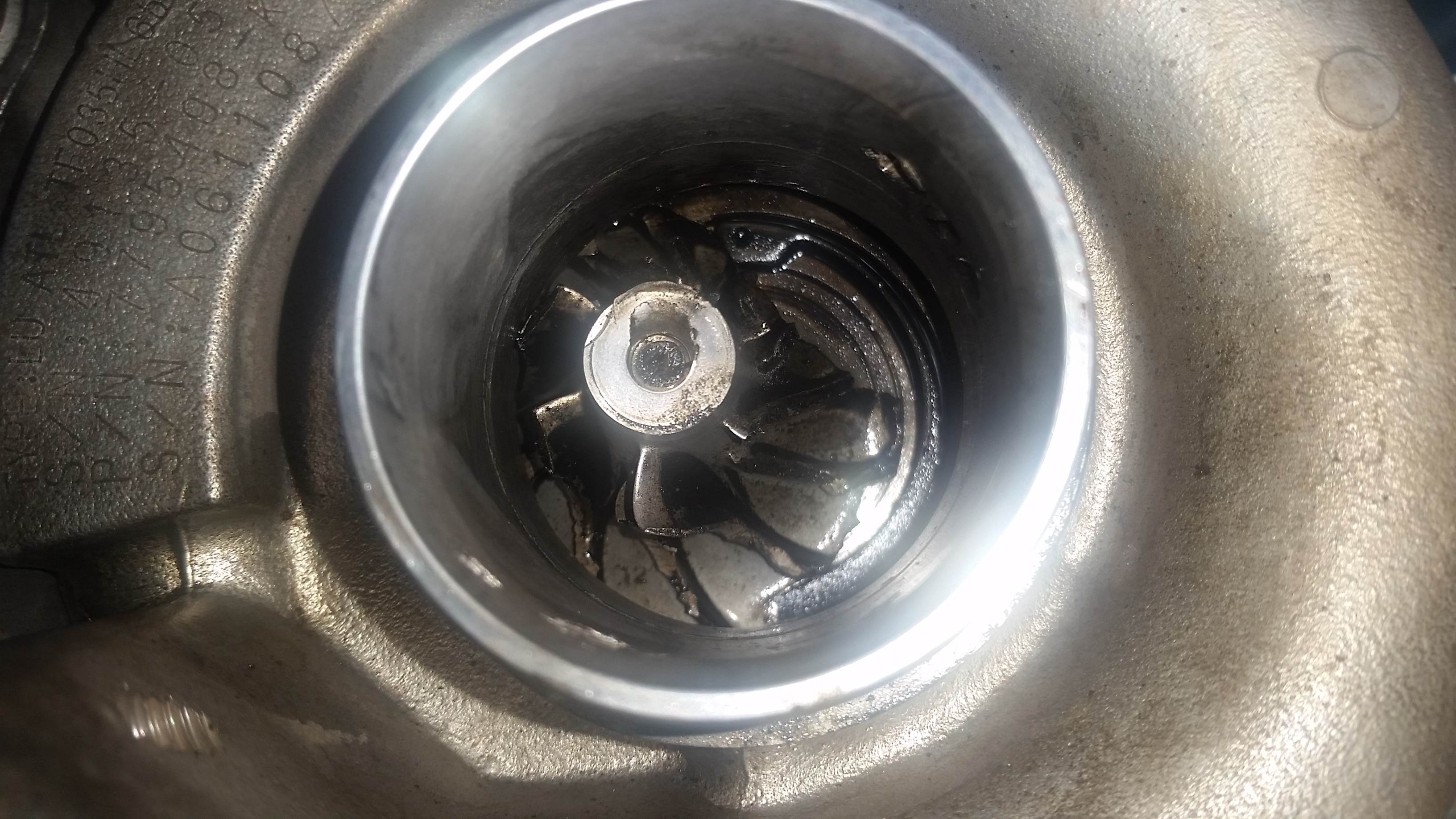

Regarding your turbo, my friend's 320D turbo also went a few months ago and we looked at all the options. Here are the shocker facts:
1. New turbo from BMW - no go as you said, offer a arm and the leg and you sorted.
2. Recon the turbo as these guys offer us the places, just remember that it will be if I remember correctly in the range of R14K http://www.bmwfanatics.co.za/showthread.php?tid=65619
3. Buy a used turbo from the scrapyard in a good condition
We did option 3, from German spares somewhere in Johannesburg. Removed the turbo Friday night, bought 2nd hand turbo, ensured the turbine is running freely without any marks or noise, installed it back the Saturday night and were driving again the Sunday. Cost us R4500 for it.
But good luck in that, if you do choose option 3 please remember that the scrapyards very from R4500 to like R7000 so be prepared to phone a bunch of them for a good deal.
Oh, and then you need to ensure that no metal has entered the head. Go and take of the vacuum boot from the release valve on the head and inspect it for any metal pieces, if nothing there then you should be ok just to replace the turbo but will need to strip the turbo vacuum parts of the car to ensure no metal pieces are in them too.

This was the first time for us to actually replace the turbo as we didn't know what to do, no MP for us and car was sitting on 200 000+ km. I suppose that you could just swap it out with another one, just that the swapping out was the easy part (NOT), the really bad part was starting the car back up without damaging the replacement turbo as somewhere I read that if a turbo runs for seconds without oil, it would compare a motor to years of driving without oil. That was the only crucial parts we had to do and was the most difficult as well , ensuring the turbo has oil before starting it up.
To your question, not sure but a direct swap should be the same method. Just make sure to check realoem.com prior to buying the replacement turbo, ensure the part number is compatible with your car.

We removed the rear seat and disconnected the fuel pump wires, then cranked her and disconnected and reconnected some pipe in the front. Lets put it this way, it took us an hour to do the checking of oil everywhere prior to actually starting her up
