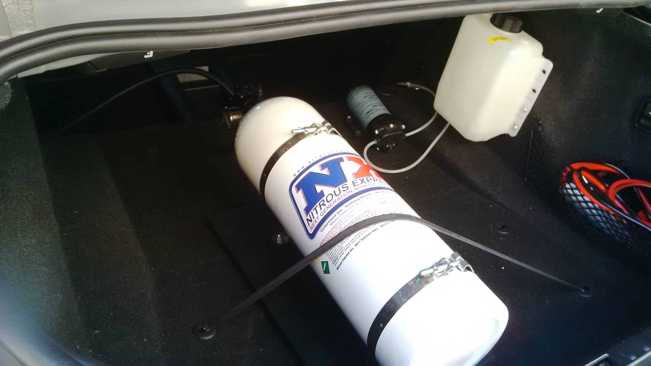

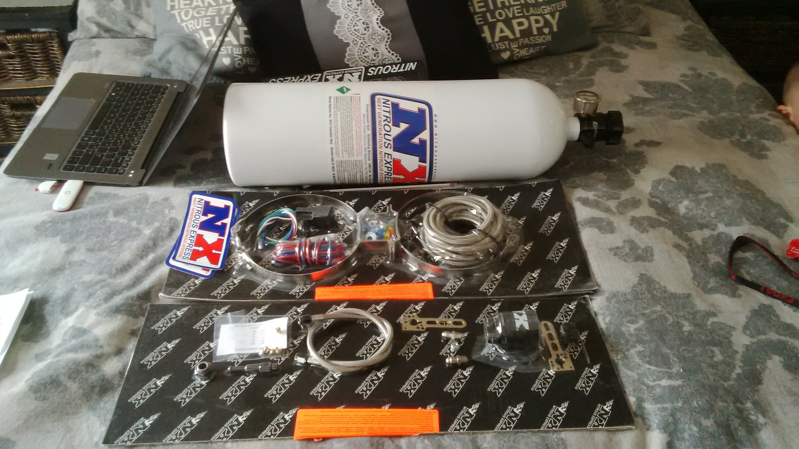

Just adding this build to give all a heads up. As all can remember I have the 135 n55 fbo with vargas stage 1. Me and Srspeedworx have decided to go the NOS route. NX Express kit. Install will happen next week. Will keep u all posted. Here are some tease pics.

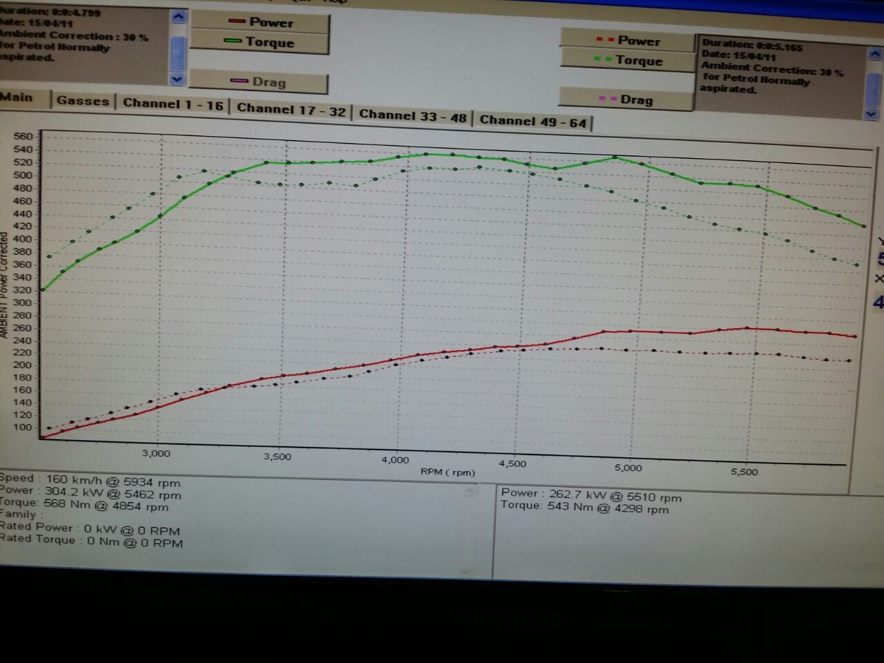

Nos installed but couldnt get the jb4 to activate the solinoid. We had the 50hp jet in and and after my car being heat soaked it made this figure after manually earthing the solinoid. Nos was activated manualy at 4500 rpm. We will tune the car better once Nos can be activated through JB4. We hoping to get 330wkw.

Please dont take this wrong way. But what should a fully modded N55 make without NOS.
All my experience is with a N54.
To OP hope you get issues sorted with NOS.
BMW135FREAK
Hi no problem. My car without NOS up here in JHB makes 275 wkw. Then in Durban I make 310 wkw. No changes. Im also using only 50hp shot. That figures were after my car was run about 13 times on dyno.
