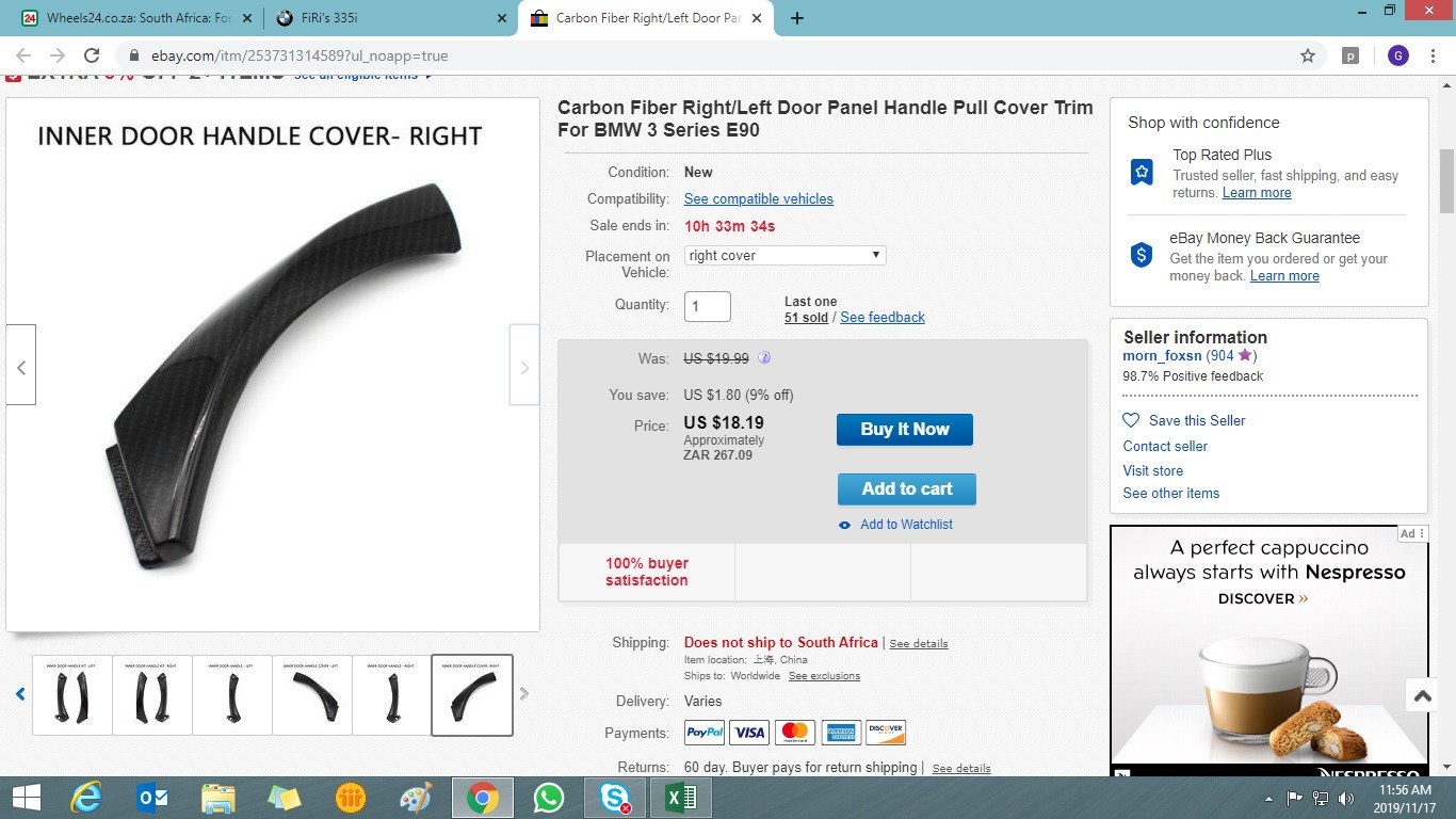

do you perhaps have the ebay link?
my Old E90 is now in my bro's ownership and also needs a change.
Gordvisr
those new handles looks much better.
one question, how did you go about shipping ? It says not shipping to S.A.
FiRi@Rennzport
I use a company called MYUS.com that Kish introduced me to im 2015. So the items get shipped to them and then to you. They are able to consolidate items and send it all to you in one parcel. Very convenient if you gettinf things from multiple places.
Gordvisr
thank you, saw the MYUS on FB, was thinking of using it but no one so far could tell me how good or bad they are, glad to know it is legit so i will try it, sometimes come across some hotwheels and other stuff i would like to get shipped here.
