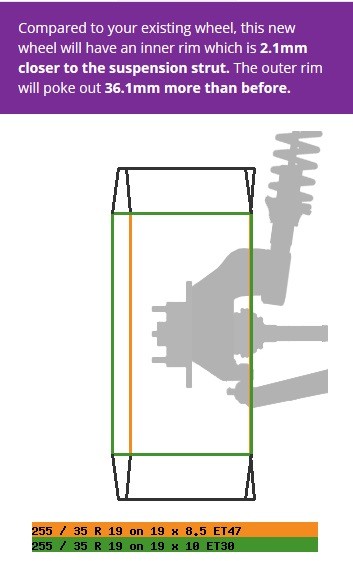

For reference, here's the results from willtheyfit...

There is considerably more width in the rear, with 2.1mm movement towards the suspension and 36.1 mm movement toward the fender.
Rear
There will be some stretch on the tyre, that will be up to your personal taste. I would prefer a 245/35 on a 9in and 275/30 on a 10in wheel
