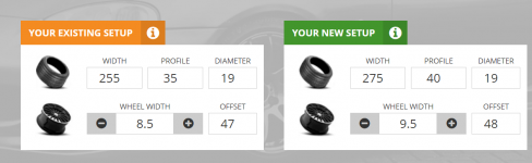

https://www.willtheyfit.com/
use the link above, punch in your existing set up values and your new.
its pretty accurate and helpful, look at the diagram it generates to see how off you might be.
quick check on the rears , they seem to be a bit aggressive, id say test fit first.

the width and offsets seems ok but with the current tyre profiles of the X3 my guess is the sidewall is too high and might cause rubbing on the F30 arches.
worth a try though, share some pics when you do
