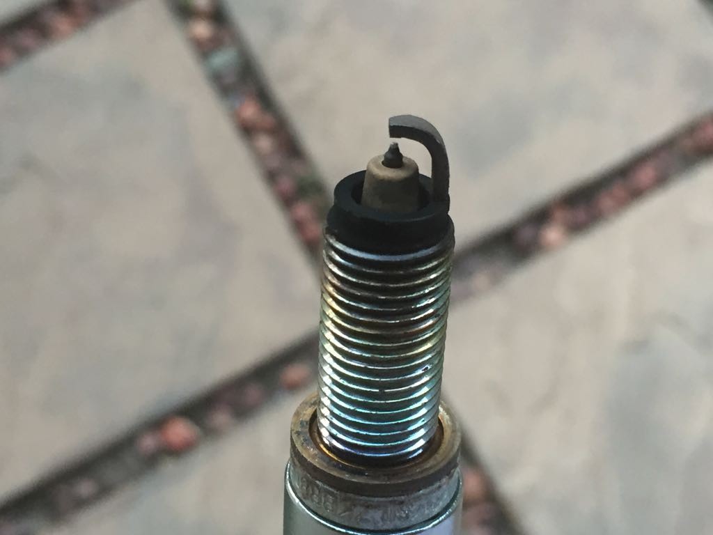

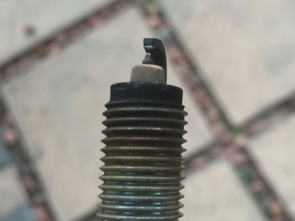

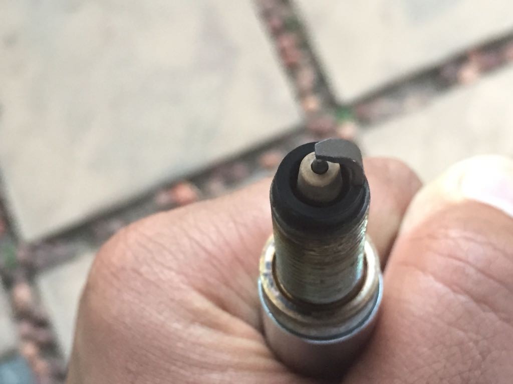

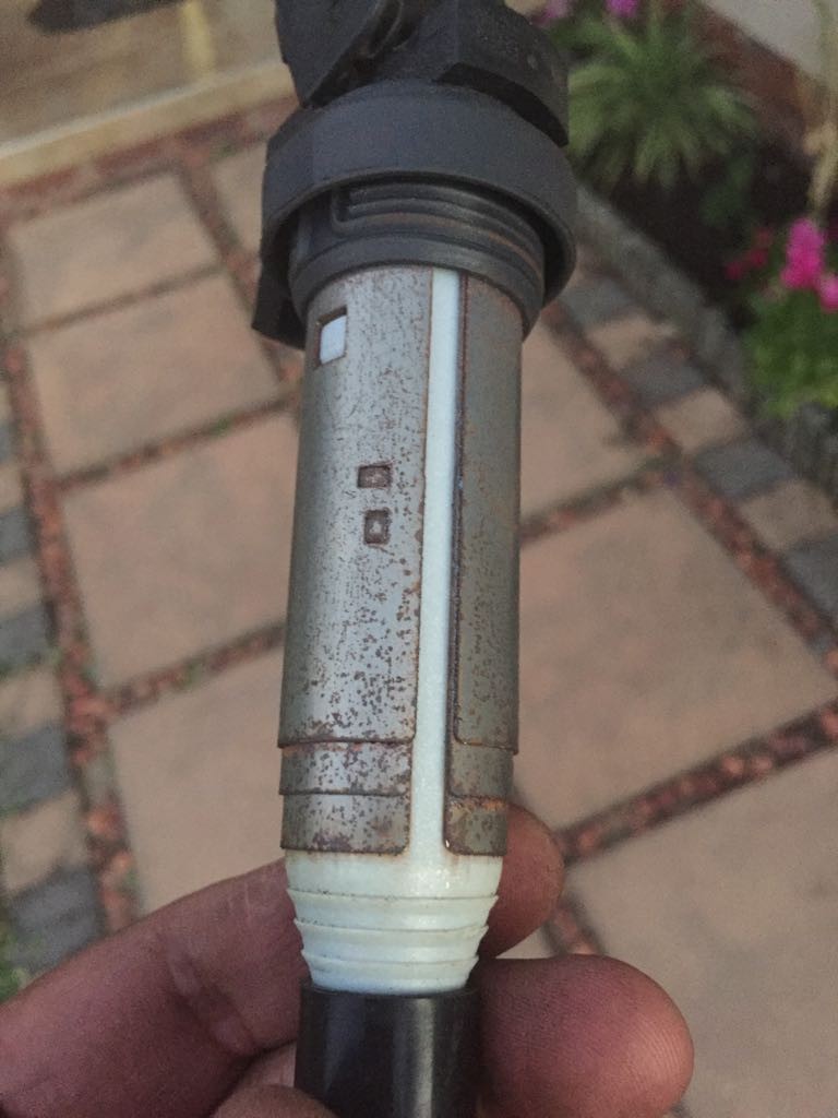

Decided to source a thin wall sparkplug socket & inspect the plugs. Please see below picks & please advise if they look bad. Also found the first coil had a bit of surface rust, not sure if this is a problem.
Also wanted to know are these Delphi coils standard oem parts, heard a story where bmw coils were stolen out of a car at the dealership & replaced with aftermarket.

zippy320 said:
Does it have a BMW part number on it?
Can't remember seeing a part no., will have to check again. Has clear DELPHI branding on the black plastic located on the top

SubLoaded
Resident Derailer
Ever considered checking your vanos solenoids? Not very clued up with the N20 but I had pinging on load around the same rpm with the 323i and the vanos solenoid was the issue. I also had an issue with the oxygen sensor which was changed around the same time.
Check the usuals as well. Plugs, coilpacks etc...
