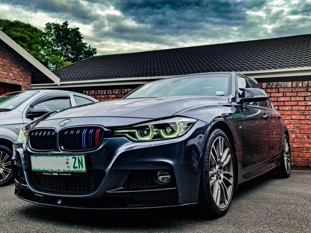

Hi Guys,
The time has come to do a few mods on my car.
Planning to keep it for a while as I quite enjoy it the car
I want to do the Downpipe and Tuning. Not too stressed about fuel economy. I like the feeling of the torque too much to worry about fuel consumption much.
I do not want a full exhaust so the DP and DPF removal is a better option for me.
I called ACE in Durban to do the Downpipe. they have a special currently for Stainless Steel, Mandril Bends, Argon Welded DP for R1900. I am not too familiar with exhausts so some feedback on whether this is a good type of DP will be cool.
I have heard lots of good feedback about RK Motion & Xceed Performance and have started chatting to the guys there to get an idea of what they can offer me.
Would like to know your thoughts on the path I want to take.
