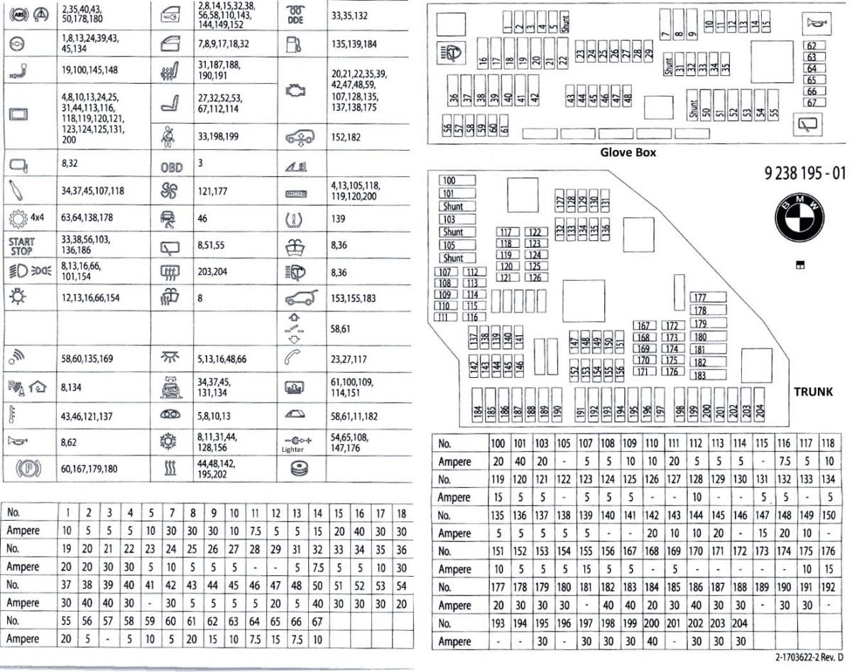

Need some help. I have F10 2011 520D. The cigarette lighter in cup holder and inside the arm rest does not work. I opened the fuse box panel in the glovebox and closed it again. Have no idea which fuses to go for. Where can I find this info please.
Ricky318i
It's behind the glovebox. Open the little hatch at the back of glovebox and with a long nose pliers, remove fuse 54 or 65 or both.
Keep the following document in your car as well. Fuse locations:

@riki318i thanks a lot. I will have a look again tonight as the ones on youtube seems to have a slightly different version than mine.
