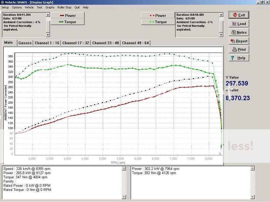

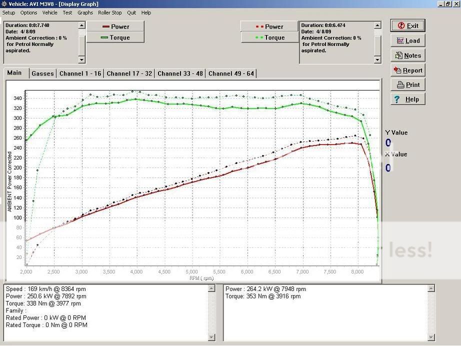

We have done over 10 E9X M3's and the minimun gain with software only is around 10 kw on the wheels. I doubt you can squeeze much more out with software only.
Here is a graph of s/w only:
And here is s/w with decatt:
Bear in mind that we remapped the car to with a much more aggressive file to take advantage of this breathing mod. The decatt alone made around 8kw on the wheels.
