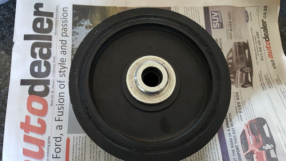

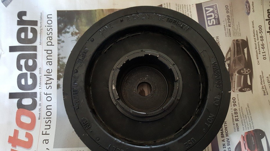

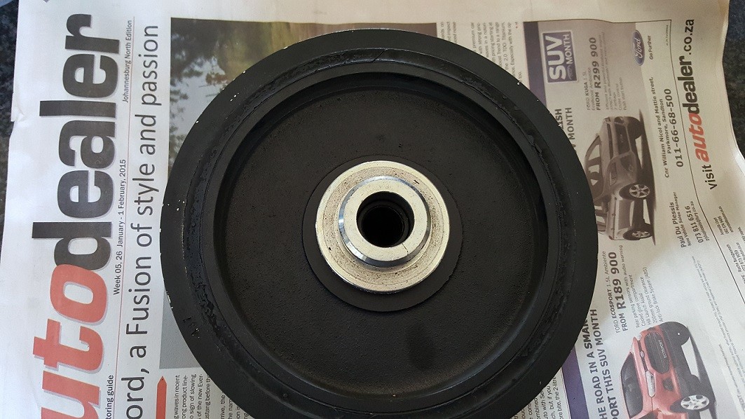

Attached are some pics of the faulty vibration damper.
