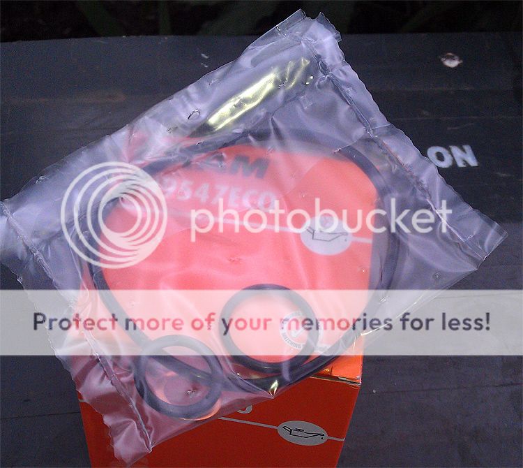

E90 Engine oil filter with seals
O ring (Part number 11667509080)

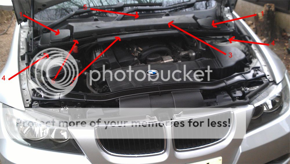

1> Remove the two plastic covers at the far side of the cabin micro filter housing
2> Unclip and remove the cable carrier
3> Remove the 7 x 8mm bolts holding the cabin microfilter housing in place and then remove the housing
4> Once the above is removed you can remove the two strut barces. Torx bolts hold the far ends on place. The centre bolt is found under a plastic circular cover (5). Pop it out with a screw driver and remove the bolt. The strut braces then slide straight out.
6> Remove the cabin micro filter under tray.
You now have fairly good access to the engine but the Vacuum Pump is still not visible. To access the Vacuum Pump remove the plastic cover from the top of the engine. Just lift up and pull, it comes away easily.

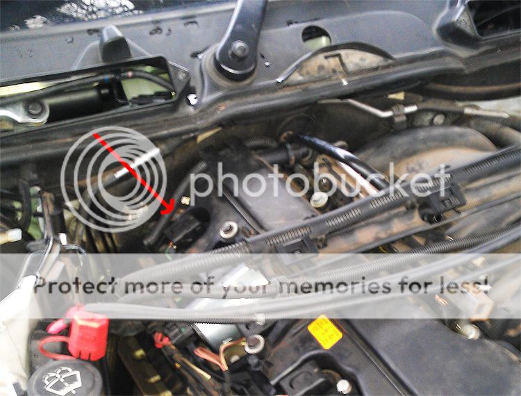

The vacuum pump will then slide straight out. Just as it pulls out, take a photograph of the locator position, this is the part of the pump which connects to the cam driver insert inside the engine and has to go back in this exact position.

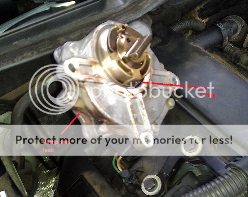

With the pump out you can see where the oil was leaking, both from the O ring and also the pump seal itself.

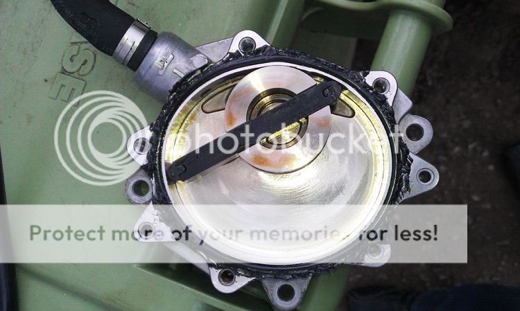

Dismantle the pump by removing the five torx bolts at the rear. You can now remove the back. Its difficult to see from the photo but the seal is completely recessed which explains the leak. These seals are well known for compressing like this and the lack of pressure against the back plate results in leaks.
Clean the vacuum pump up with some degunk spray to remove all oil from the seal recess.
After speaking with a friend who is an ex Sytner mechanic he explained the only way you can fix these permenantly is by installing a more subtantial and appropriate seal and he found out quite by chance the perfect replacement is the seal which is supplied with a standard E90 engine oil filter! Its a fraction thicker than the origional and provides an absolutely perfect tight seal.
I then placed a small smear of gasket sealer in the seal recess. This is actualy more to hold the new seal in place whilst re-assembling as the seal has to be stretched a little to fit in and tends to spring out if theres no sealer to help keep it held down.
Once the new seal was installed....
...I placed a small amount of gasket sealer around the outer circumference of the seal.
This is not an essential step as the new seal is more tha sufficient but I just wanted to go the belt and braces route! I used the recomended heat resistant up to 230oc gasket sealer.
All done, clamp it back together with the torx bolts nice and tight, wipe any excess gasket sealer away, install the new O ring (Part no. 11667509080) and re-install.
Installation is every bit as awkward as removal, with the added complexity of lining the cam connector up. You can feel the position of the connector insert if you run your finger over it inside the rear of the cylinder head, theres no easy way unfortunately just keep rotating the pump connector a tiny amount each time until it finaly slides in.
