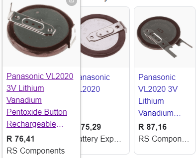

nazzeem
I have been doing much research about this. Yes all the stealers are expensive. Yesterday the key & numberplate place told me they sell the VL2020 battery for R690, They do not use the customers key as they don't open it and glue it shut again. They make a new key. Total cost is R1740. In the mean time I see the battery cost about R76
