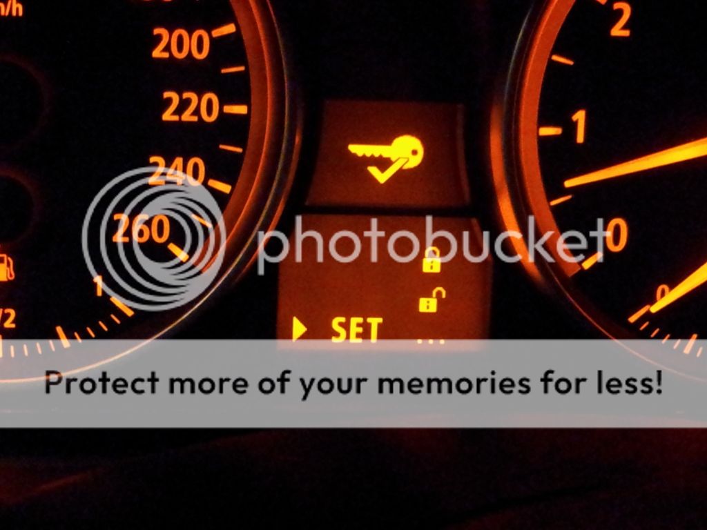

Ok so here it is...
left stalk as you check for oil etc... NB... car needs to be started to see this...
The first screen you need to see for the settings look like this...
When you get to this one press little button on the side in to access this menu.

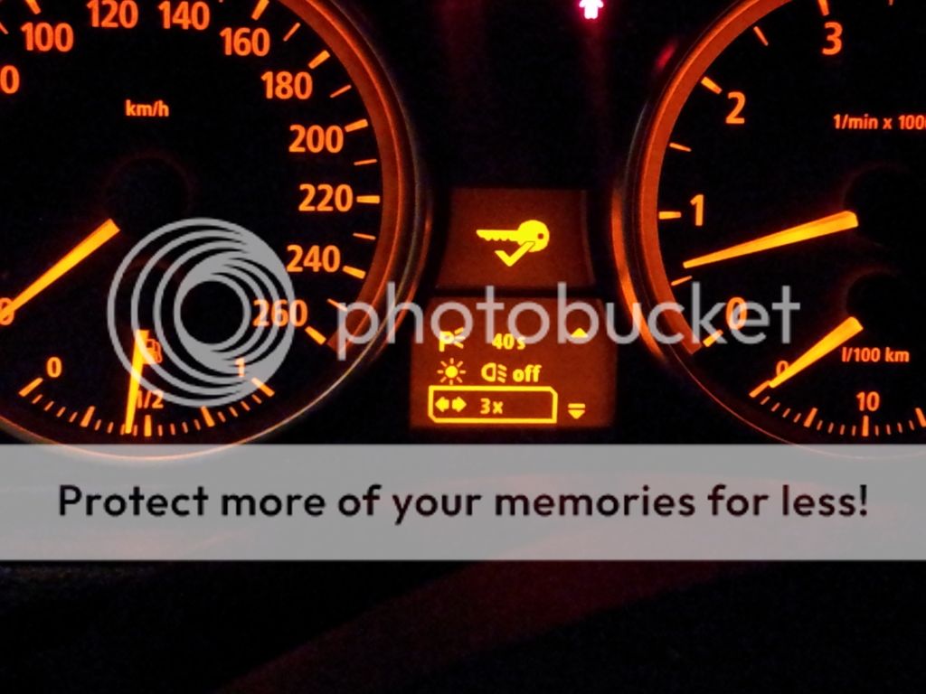

One you've done this then scroll all the way down.. yours probably shows a 1 where mine shows 3.
Again press button at the end of the stalk in and scroll down you only have 1 or 3. select three and press button again
to accept the setting. go out of all your menu's and test.
should be all happiness now.
