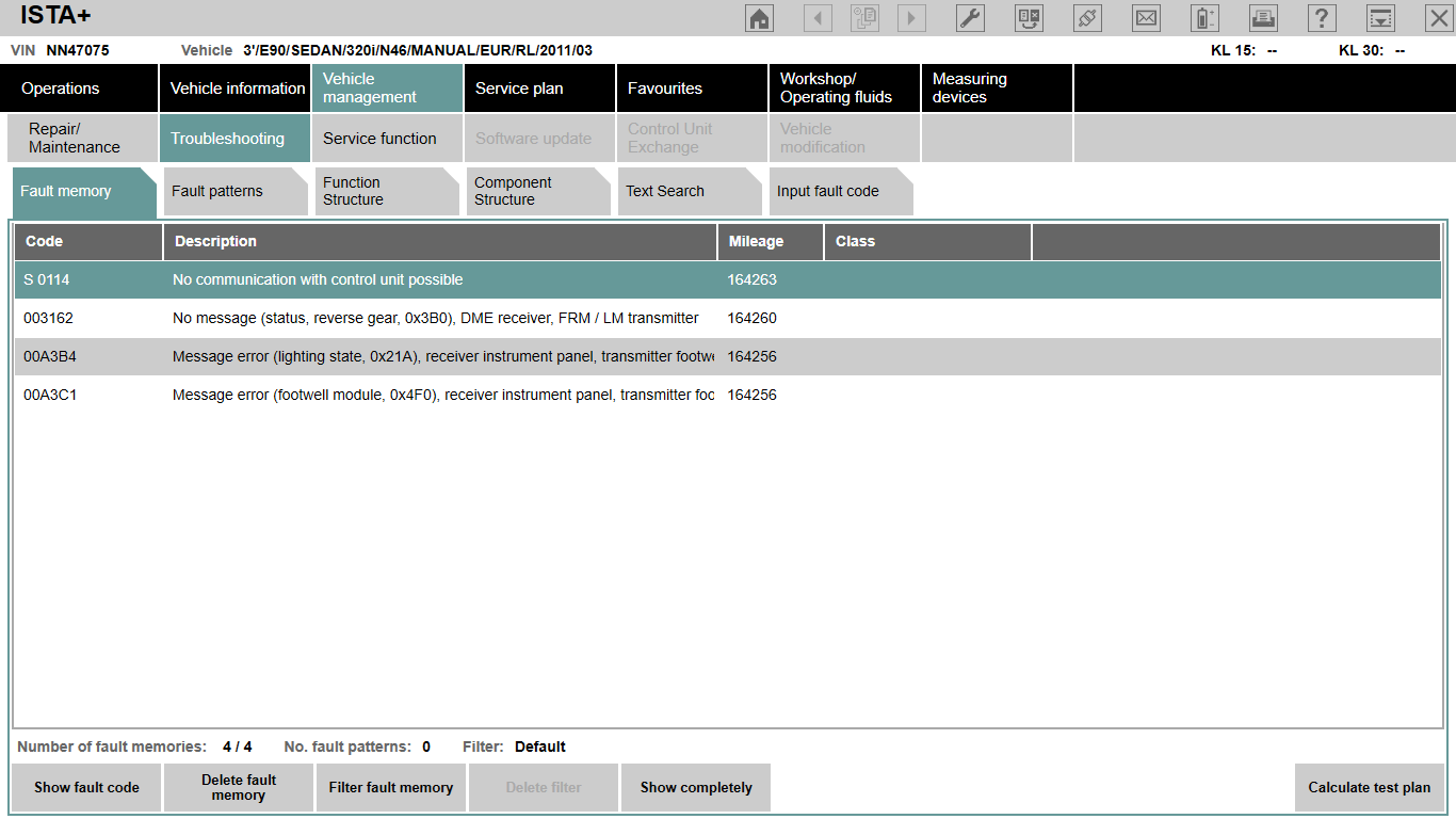

:cry: Hey guys. I had a O2 sensor replaced a week ago before going to the coast. Got back today and threw Rheingold on just to see what errors my baby threw out after her 1st long trip. Now all of a sudden I'm getting comms error on the FRM module CC ID 231. No lights, No indicators... Complete light system failure, and I have one angry wife as she needs the car to go work tomorrow. Please, any ideas. I have disconnected the battery to see what happens.

You've had the classic FRM failure bud. And I'm pretty sure you had jump started the car recently because of a failing battery. Which is most likely the OEM battery the car left the factory with.
I do repair these, send me a PM after you asked BMW for the price of a new one.

Thanks for your reply. I'm in a panic. I have never jumped the car, but when the o2 sensor was replaced, so was the voltage regulator. I was told the car over charging at 15.2V. Could that be the cause?

The FRMs break due to voltage fluctuations and spikes. So if you were having issues with the alternator this could also cause the problem yes.
