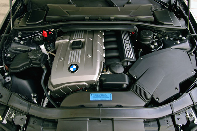

maybe some one with an e90 can look under the bonnet...
the air box with the 'cone' has screws on top to open the air box and opens upwards...
the other has an air box that opens towards the front bumper...

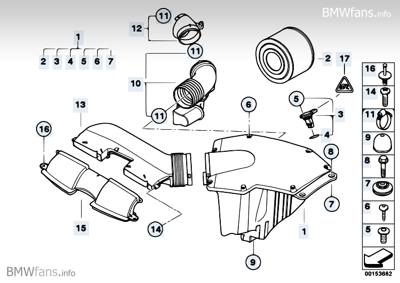

here is a pic of the cone type air box:

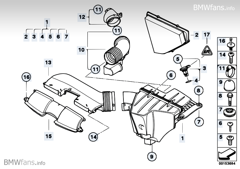

this is the panel type air box:

On our 323i we have the cone filter, i have the old filter somewhere and will take a pic and post it later.
Our engine bay filter box looks like the one in the first pick with the screws on the sides.
Its a 2007 e90 323i sports pack
