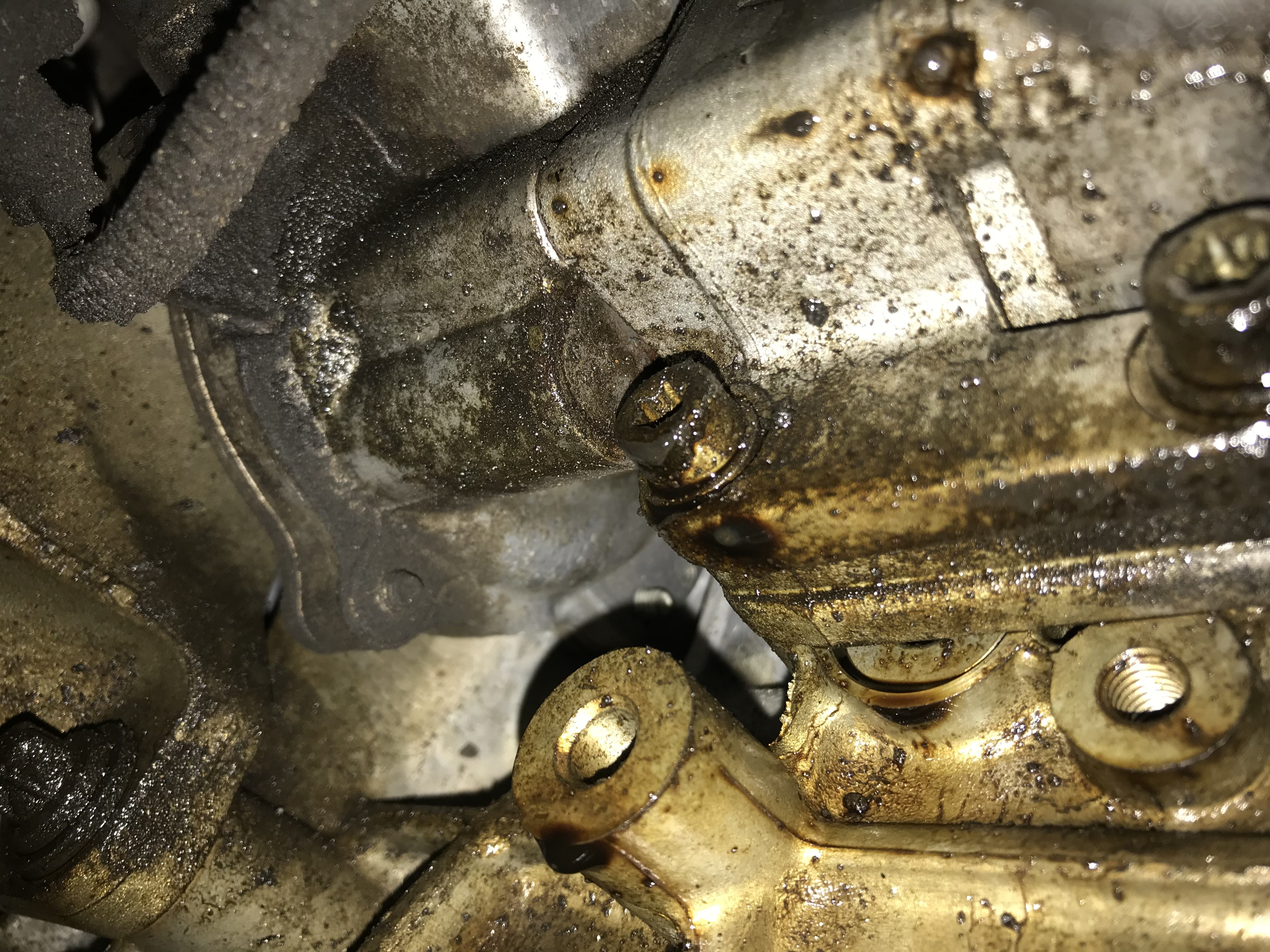

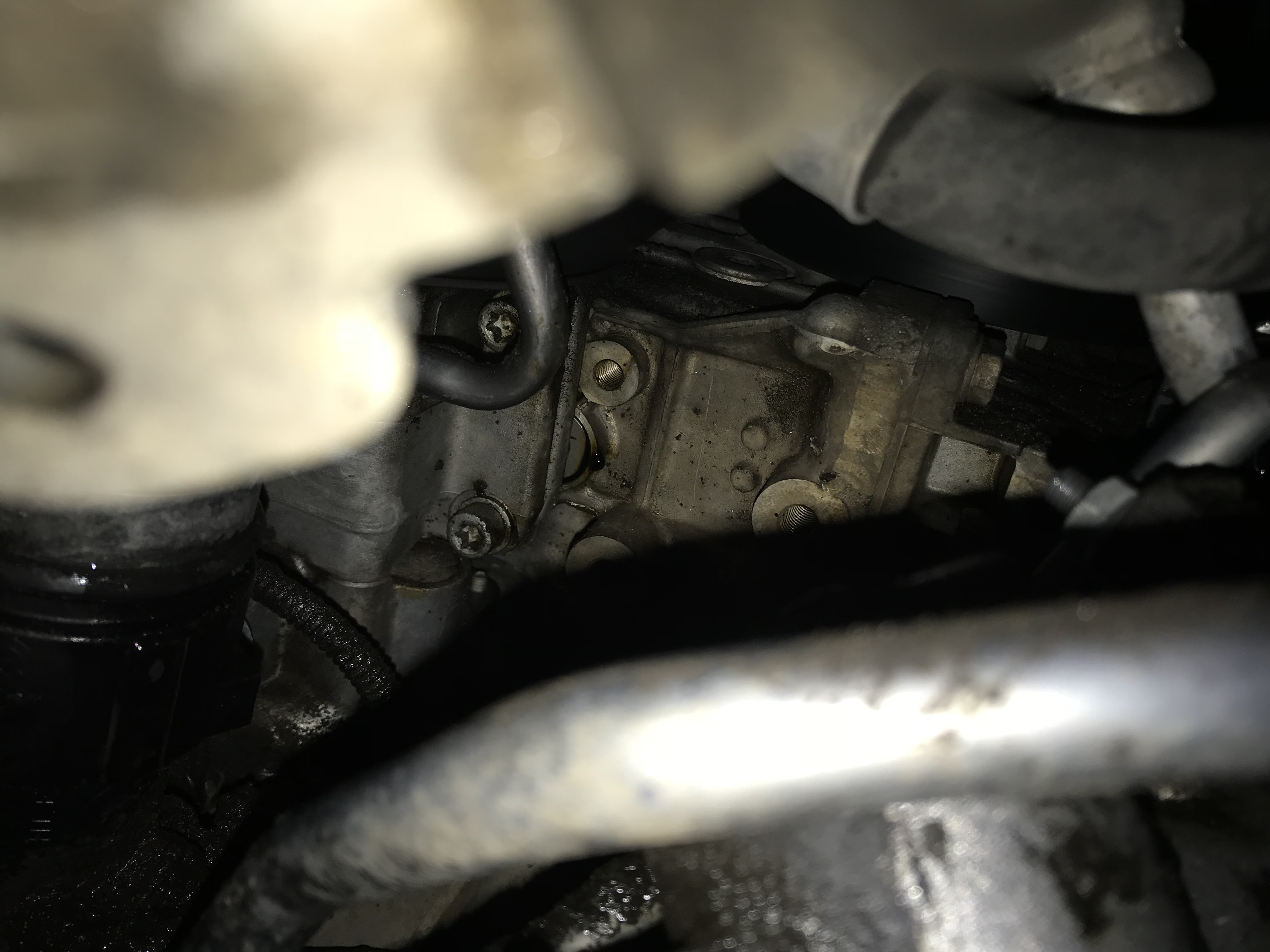

The link attached. What part is leaking here. Thank you in advance

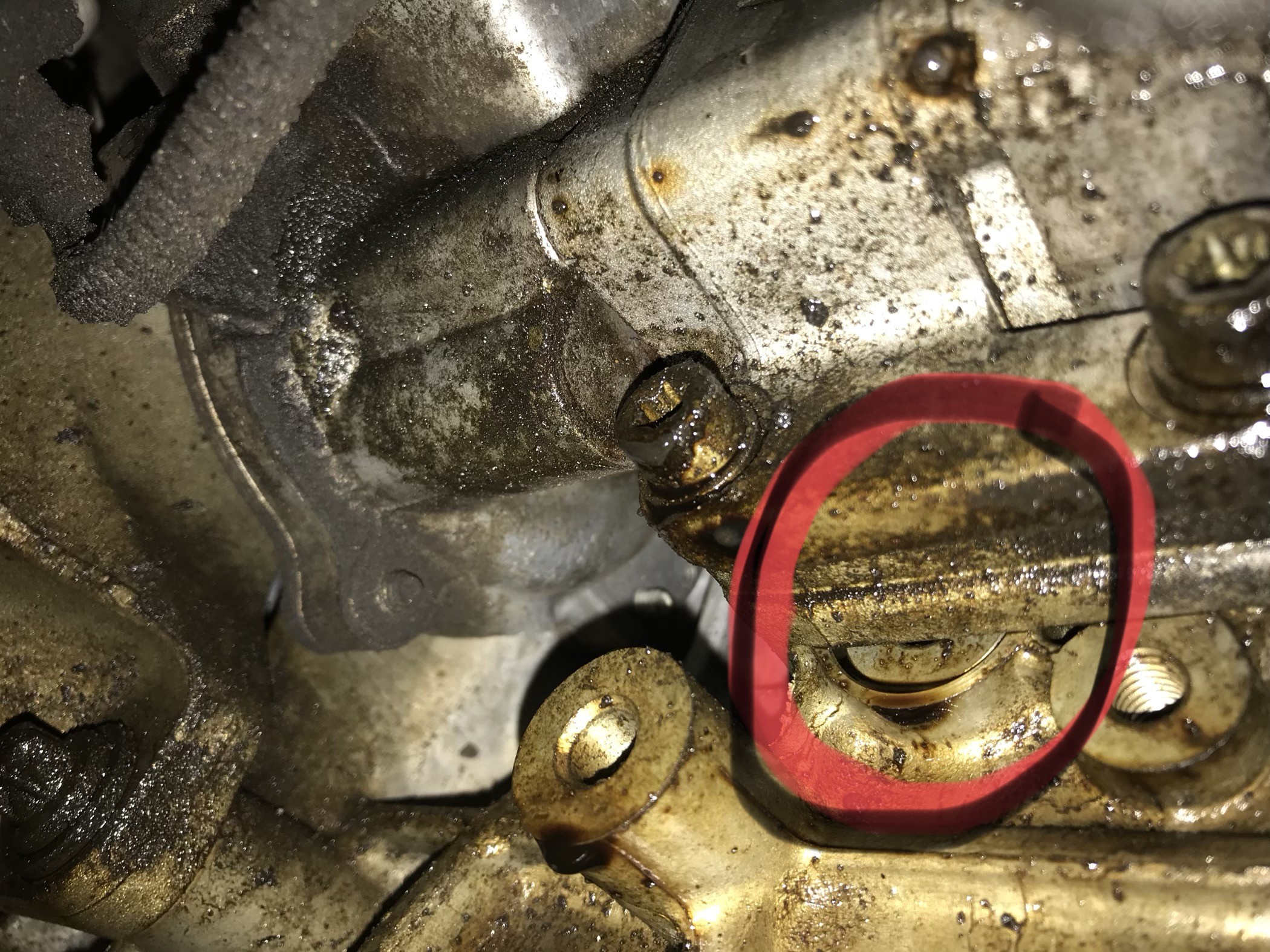

It looks like a screw. The one i circled. It sits behind the power steering pump. When the car is running it drips out

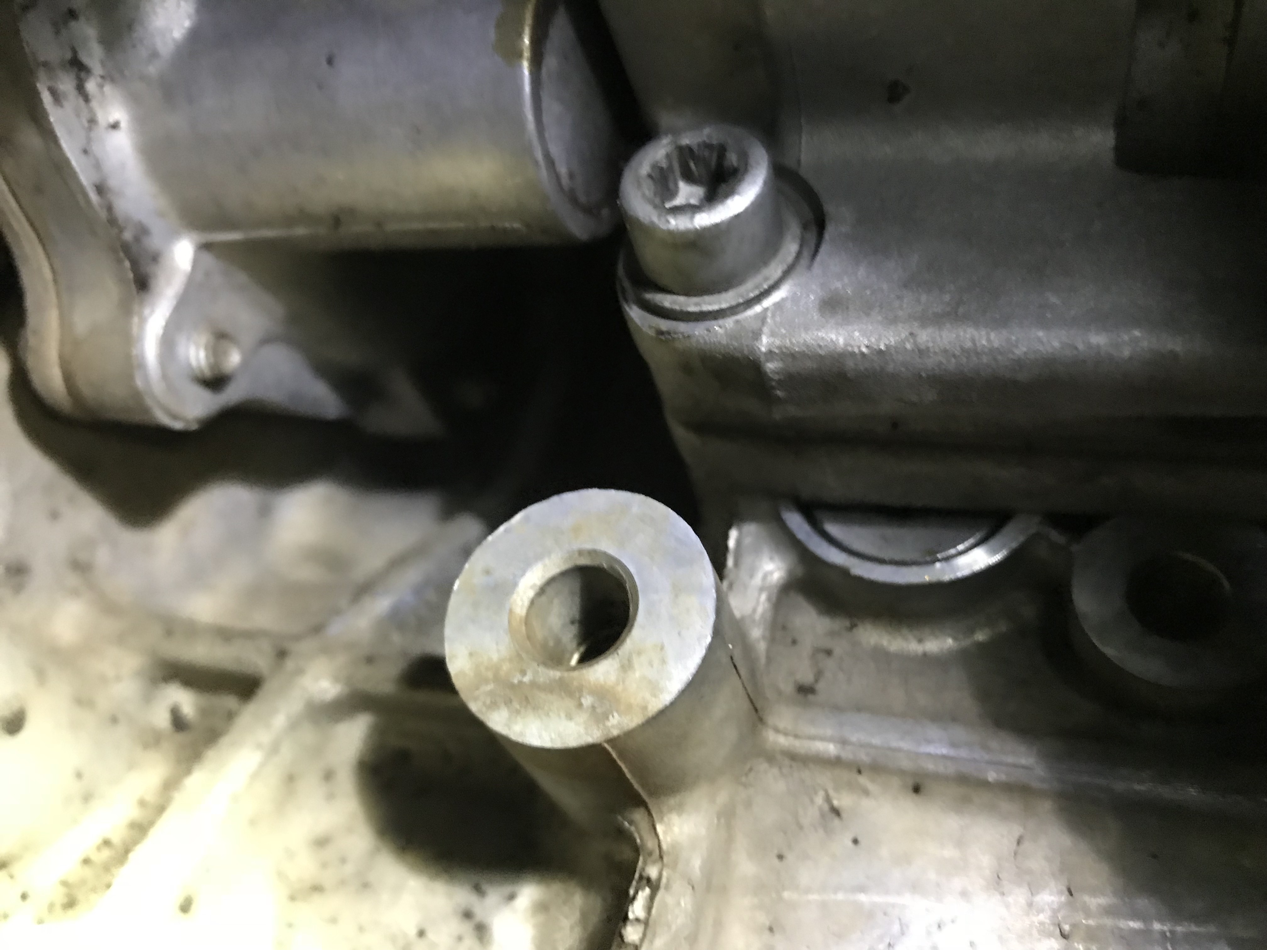

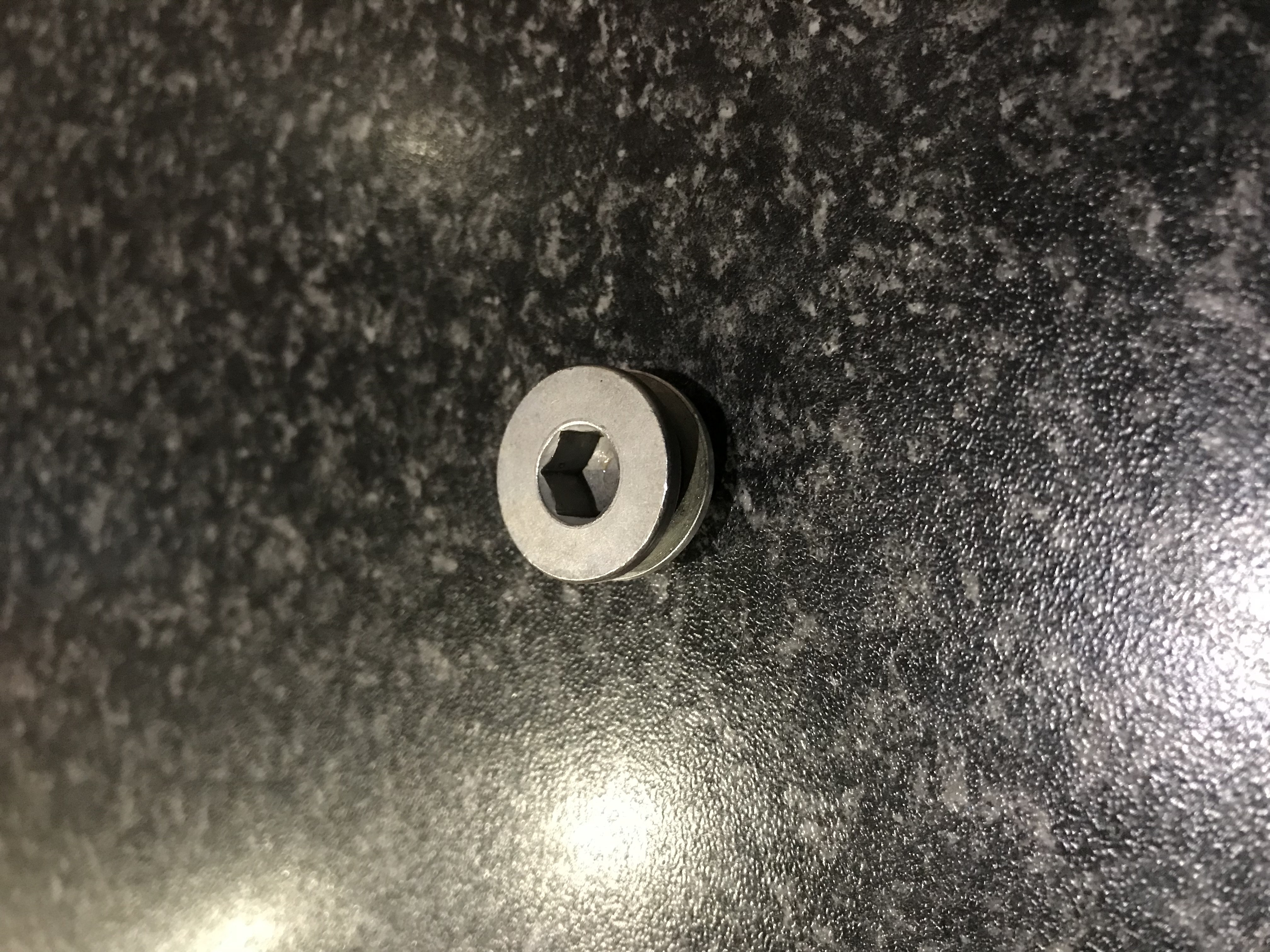

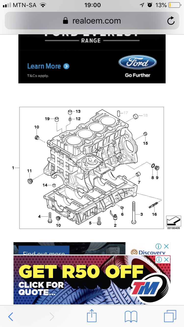

Hi gents. Thank you for the replies. It ended up being the #10 screw on picture
Its a diy repair. Just remove the belt and power steering pulley. Then unscrew the 4 torq bolt securing the power steering pump. Pull the power steering pump away from the engin. Water will run out fro the water pump. Then its a 8 allen key to remove and replace with new screw. Then reverse all the steps.
Then fill the water bottle and bleed the system. Run motor for a few km’s to check for leakes and hopefully it will look like this
