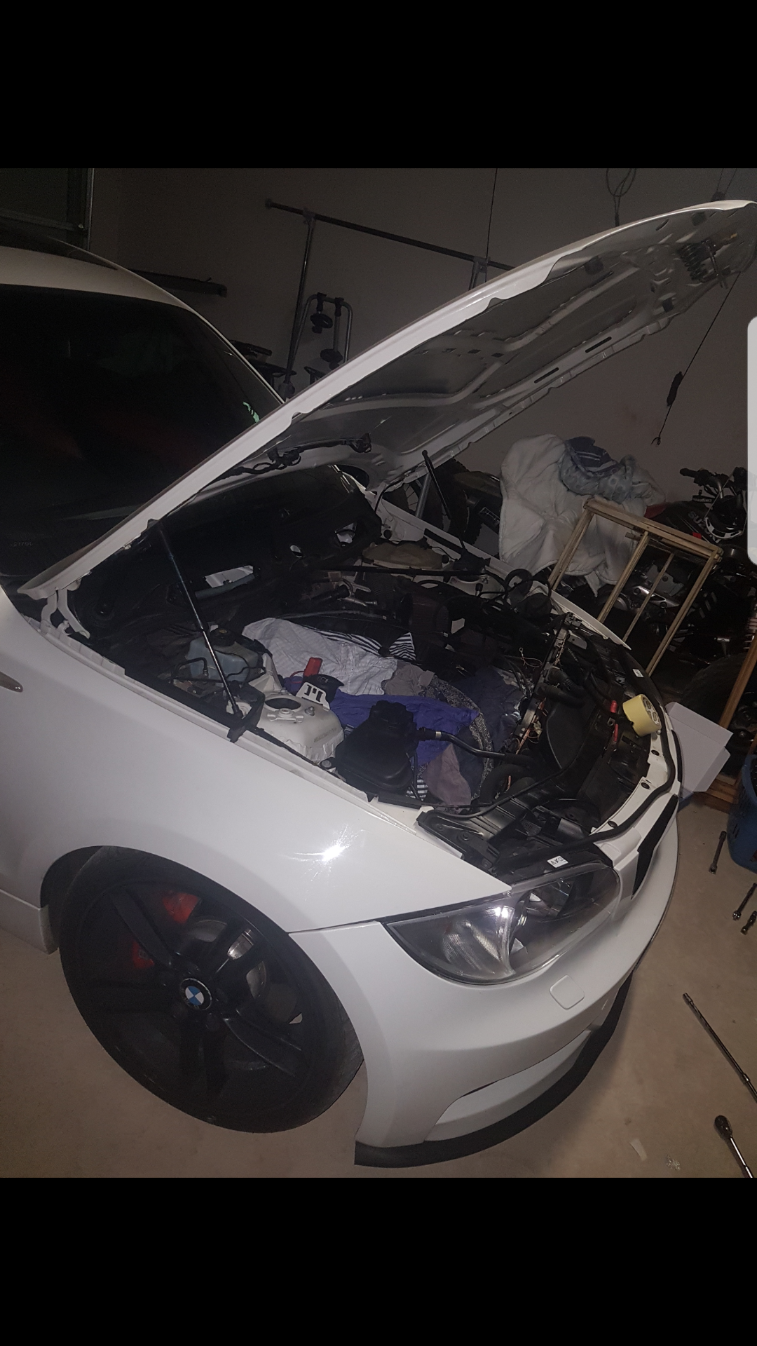

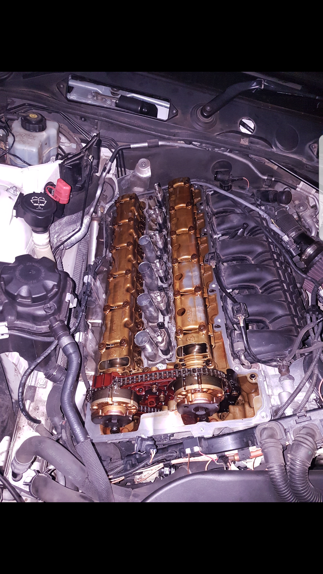

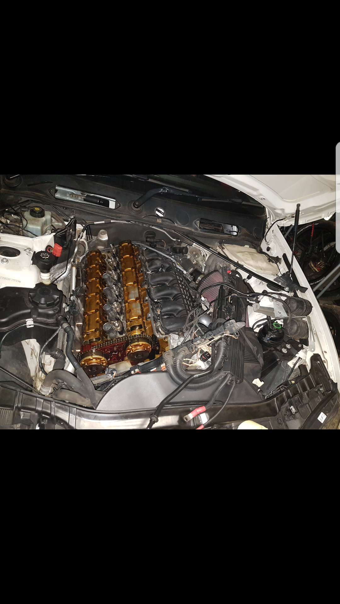

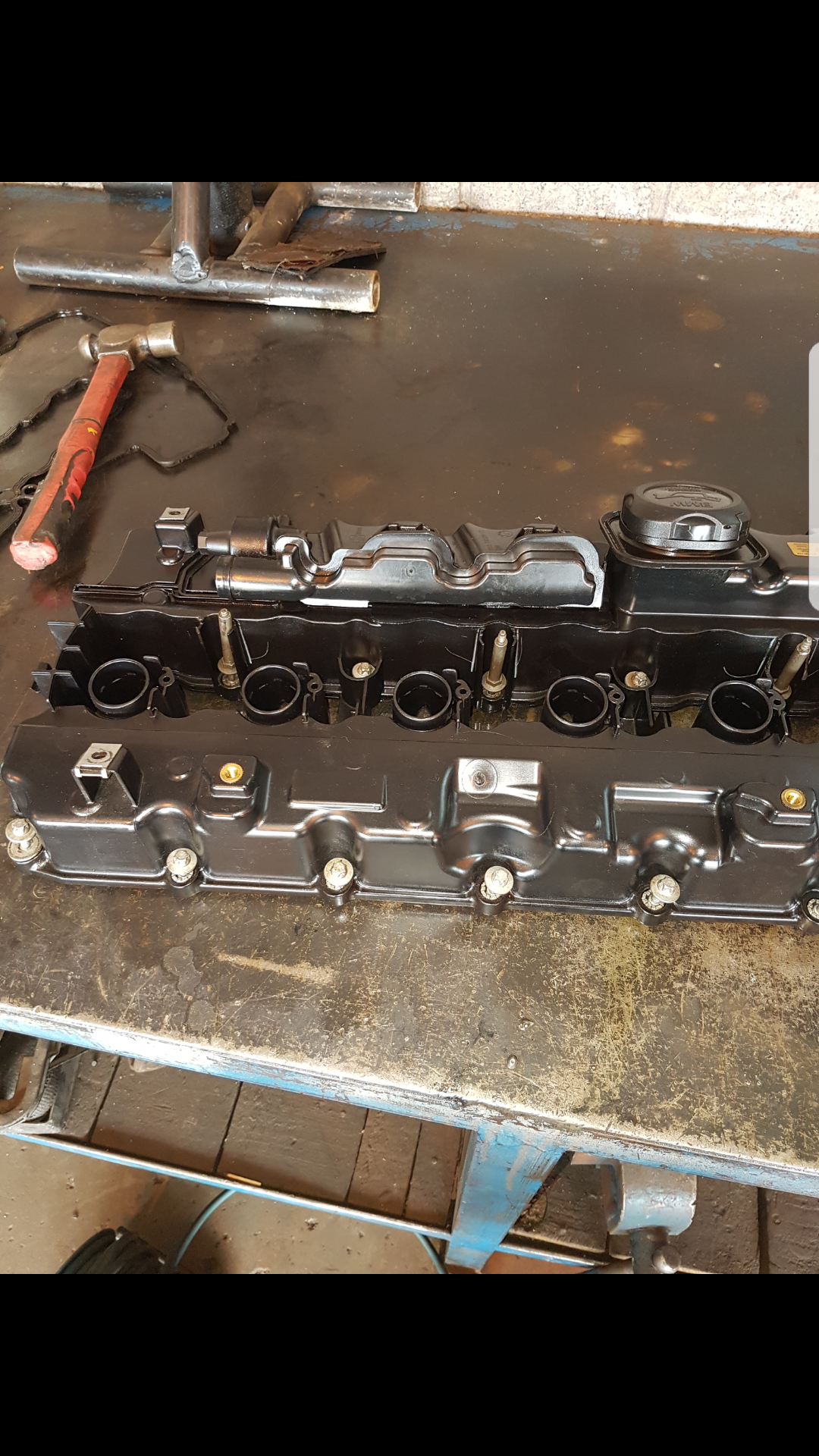

Managed to source a replacement Tappet cover ..when I upgraded my pcv valve I found the crack..
Followed a couple online DIY threads and took about 2 hours to remove the tappet cover ..

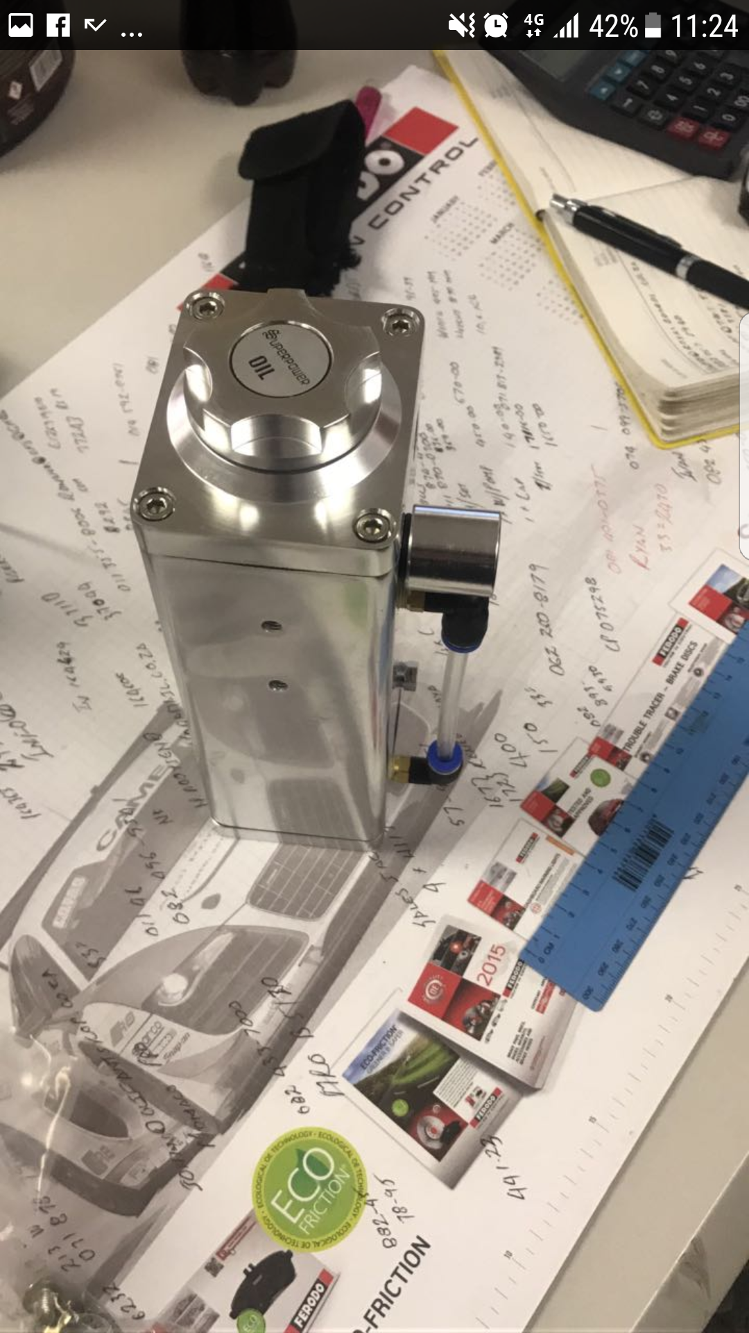

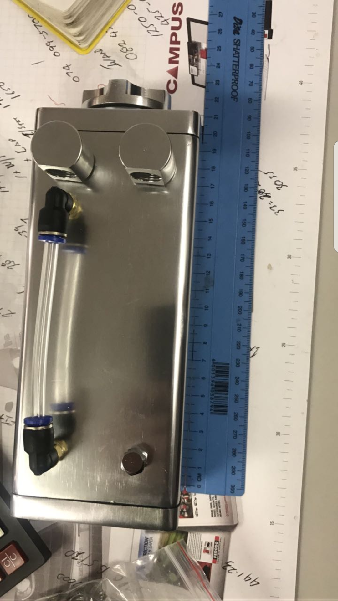

Have decided while the car is standing to replace all the vacuum lines aswell as fit a oil catch can from Ats...
Will update as I progress..
osiris
Really keen to see this oil catch can install, looks like a really well made oil catch can. Pretty cool that it has that indicator.

Update
Got the replacement tappet cover cleaned up and checked for cracks.Bought a new gasket from bmw.

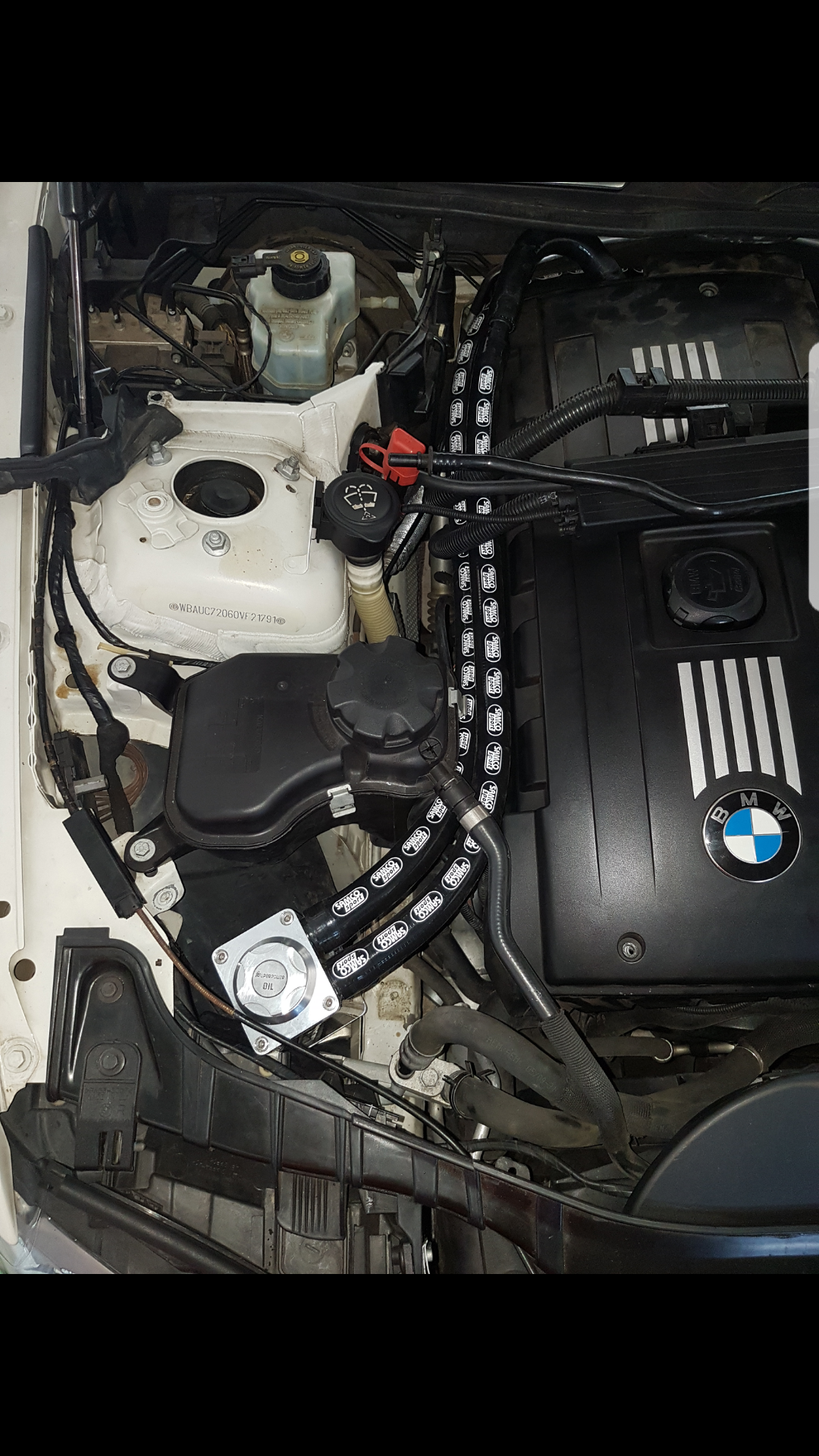

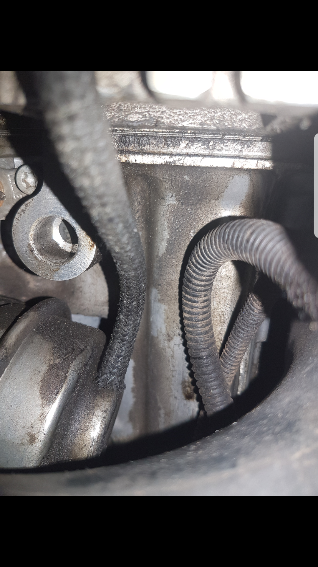

Took my time to replace the vacuum lines and moved the canisters from the left headlight to the right so that I could route the catch can .
Rob was kind enough to help and we use his 30 year old torque wrench ..
Torque was 8nm..
Took allot of patience to torque slowly ..

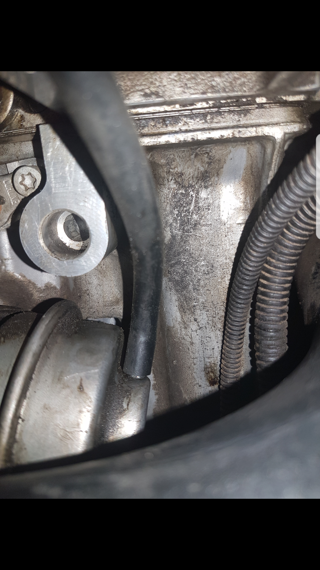

Front waste gate vacuum line was a bitch ...only line I could not change was the rear waste gate hose..i will change it when I do downpipes..
Fitting the catch can was simple jus to get the correct hoses and fittings was a pain but worked out pretty sweet..

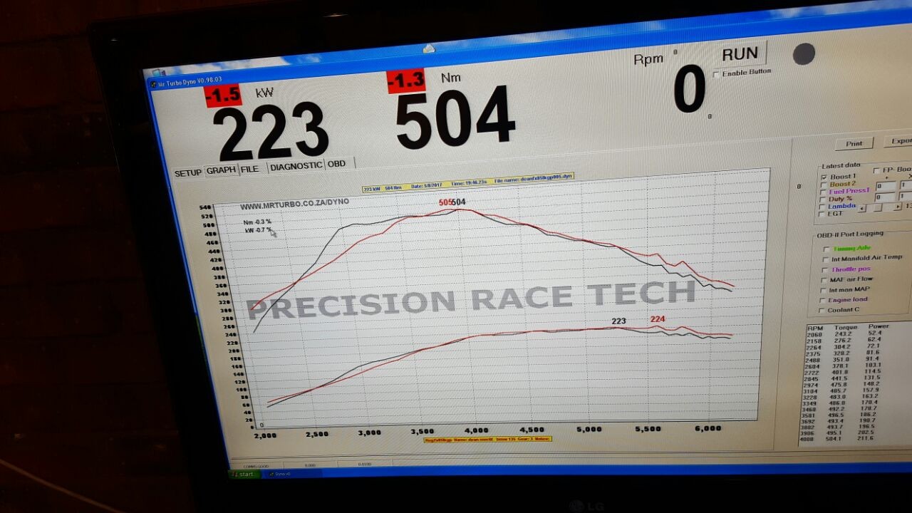

Dynod the car Saturday evening to see all was in order ..
The car made a tad more could be temps etc or maybe the valve cover and and vacuum line change but negligle ..
Atleast all seems healthy
