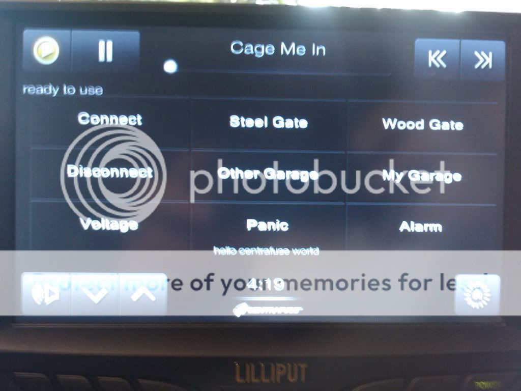

Gate Plugin I wrote to control my gates and garages.

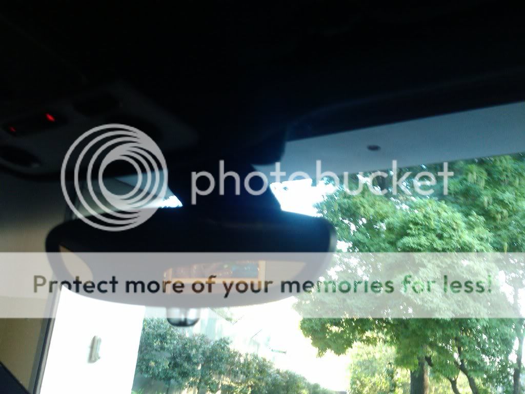

Front Camera for recording breakfast runs ? :) lol

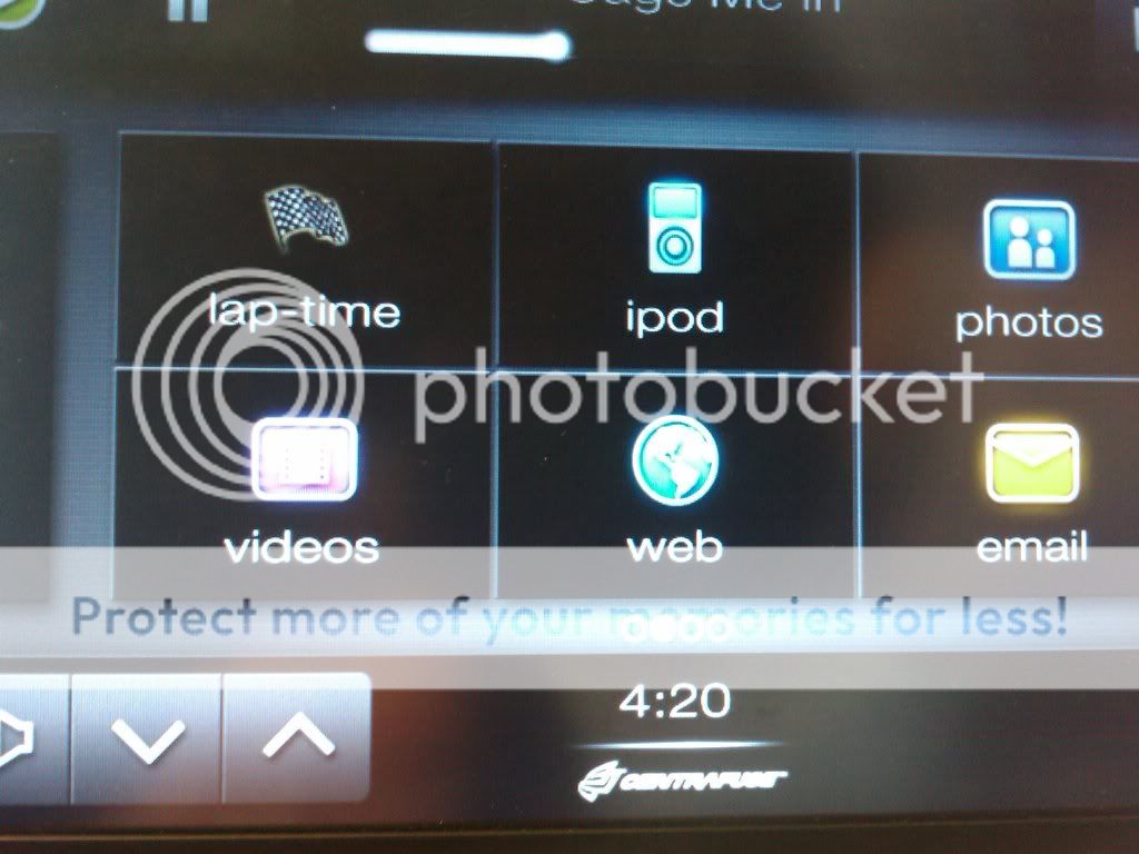

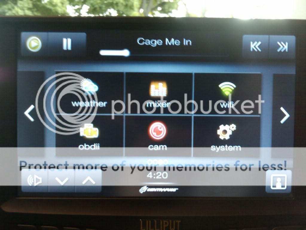

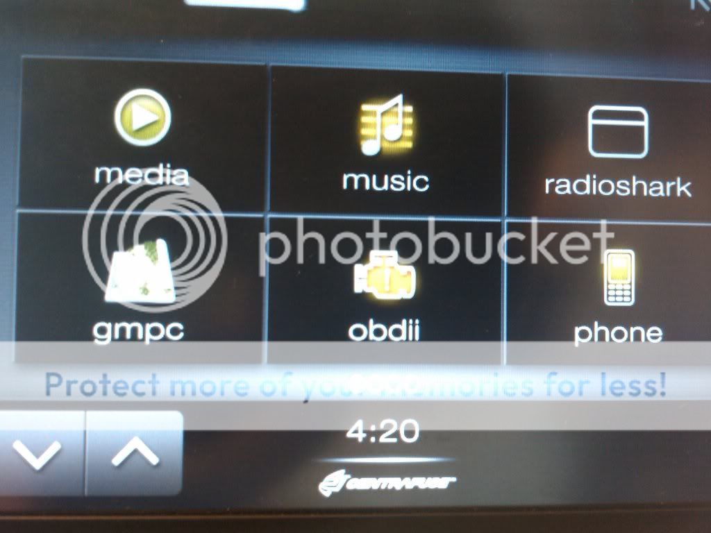

Main Page of front end.
2nd Page of front end
3rd Page of front end

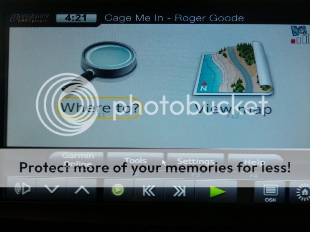

Garmin Mobile PC for navigation.

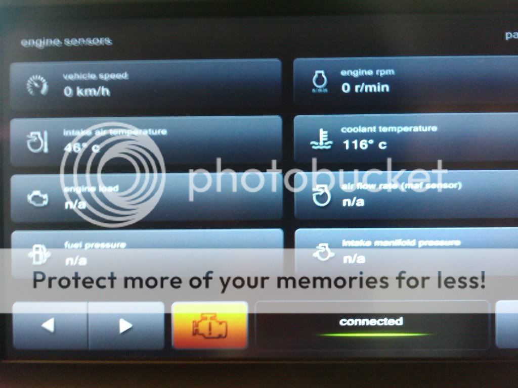

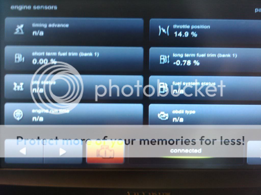

OBDll Reader

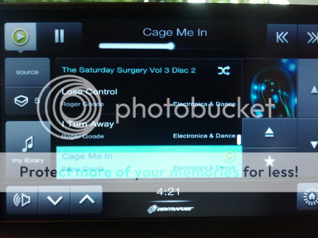

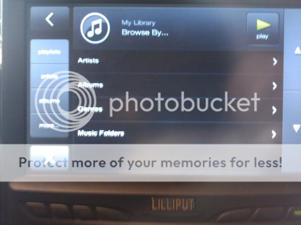

Music Library
Music Player

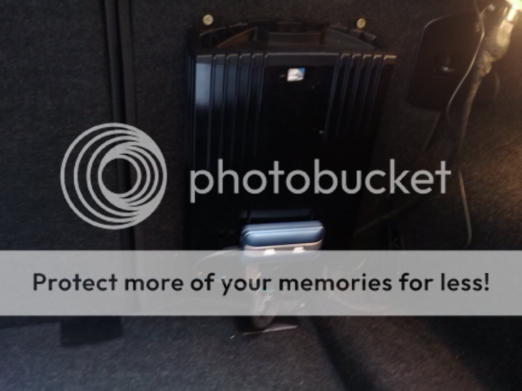

Computer in the boot, still need to make it look neater.

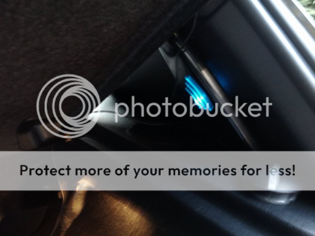

RadioShark and GPS receiver.
Still testing RadioShark, hence why wire is not under the trim and its light is on.

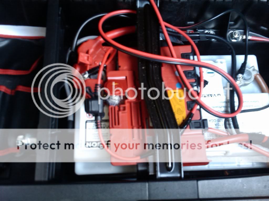

Battery Wiring

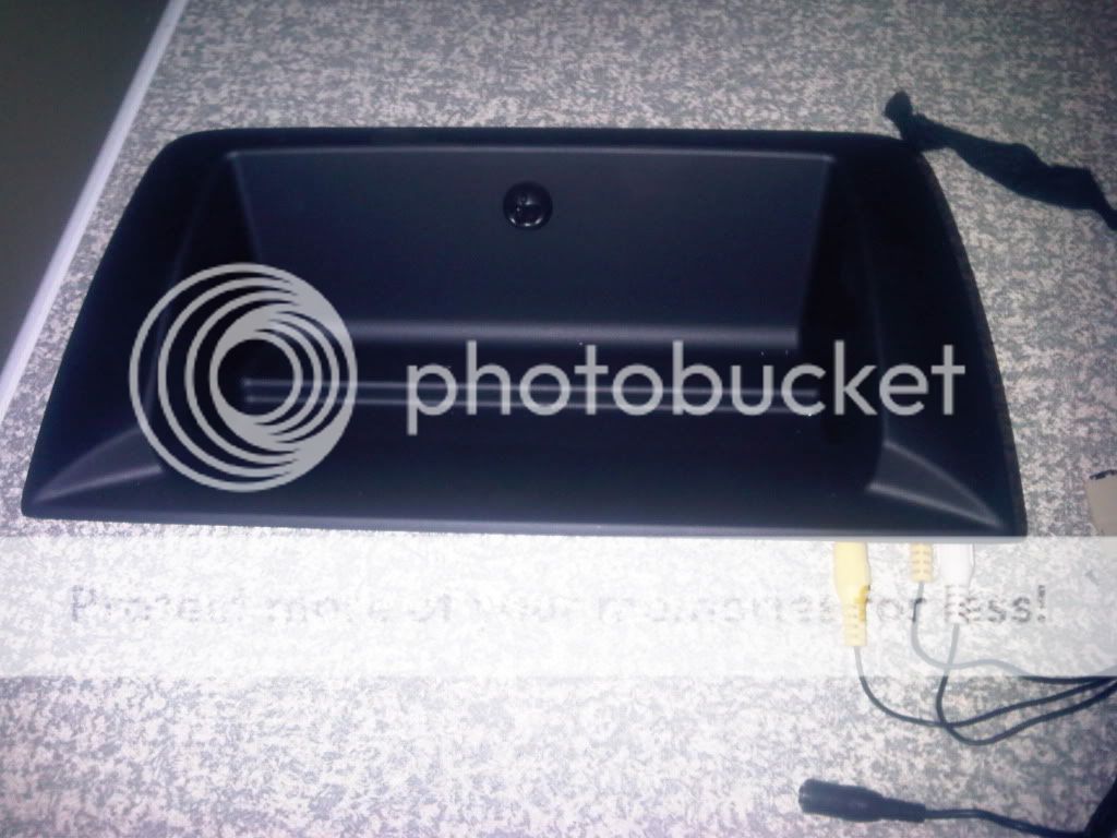

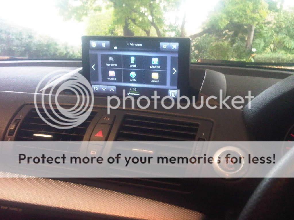

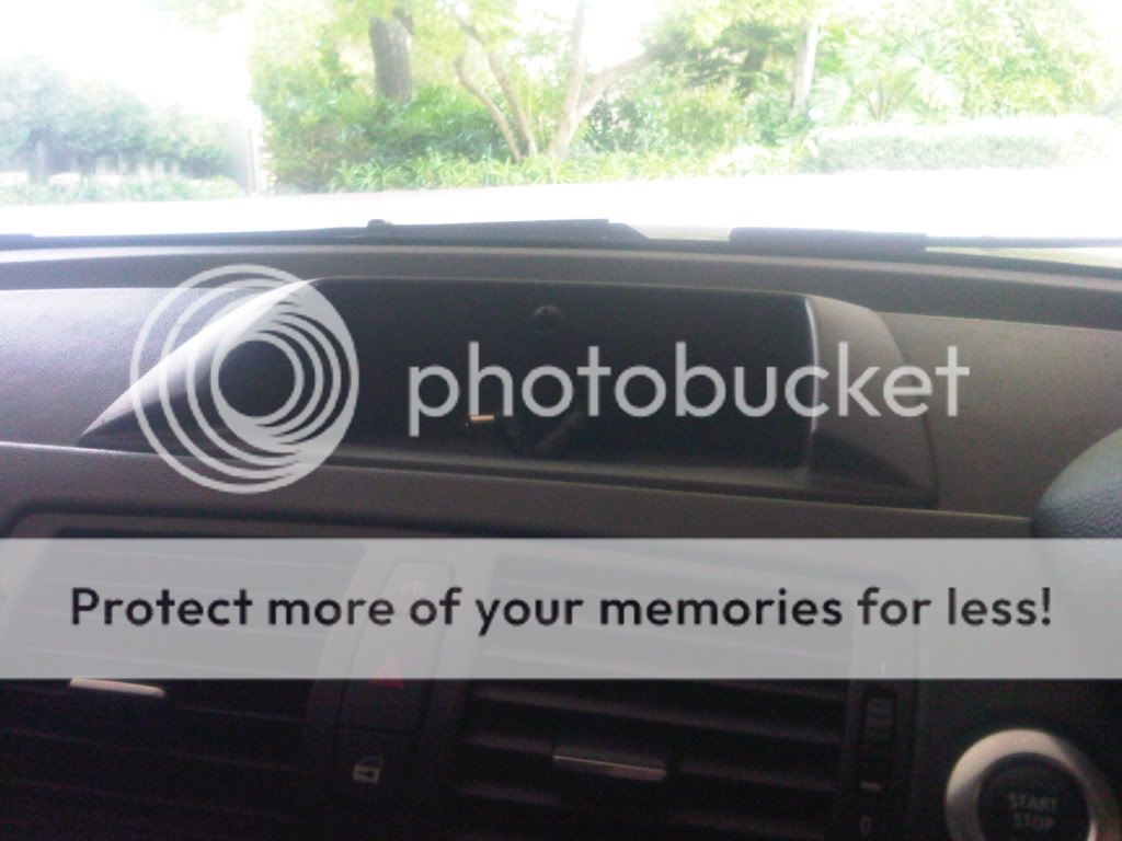

Finally, got my brackt. Not the CID, gave up on waiting for that.
Brackt is quite nice, still planning on how to integrate, maybe also putting laser detector with it....here are some pics
Soooo....Just went to Durban this weekends, carpc worked like a charm. Navigation, Camera warnings, music, bluetooth, camera...everything working really well.
But well I came to eventually be true to myself and admit that because of where the screen is, user input is rather difficult.
So I have now decided to change the screen position.

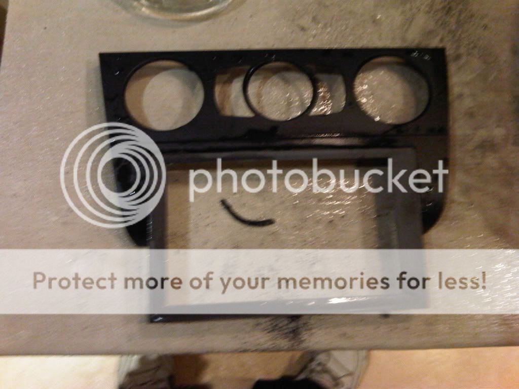

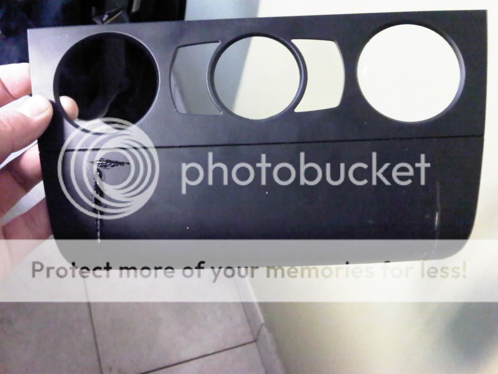

The plan is to remove the GPS holder from center dash, replace with the original center dash compartment.
Now I need a place for the screen.
Look at part number 9 in the following diagram
http://www.realoem.com/bmw/showparts.do?model=UA32&mospid=50328&btnr=51_6713&hg=51&fg=30

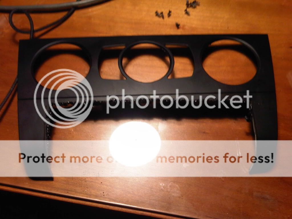

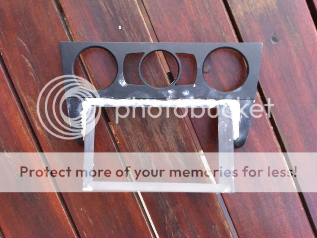

The plan is to order a new one, then use then bottom part of it, under the AC controls to cut a place where the screen will fit (half of it).
Obviusly I will fill it up with fiberglass or putty, sand it down and spray it again....
Then it should look something like this:
This should cover the ashtray whick will stay under so that i can remove the screen and the car will be back to stock.
Also I plan to fill the sides (so i dont have holes between middle dash and ashtray) and it all looks like one solid piece. Also probably put a couple of usb port on the sides or somewhere near.
What you guys think? Need ideas.....
Started working on it.
