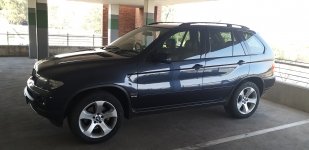

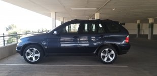

Took the ol gal for a bit of a long drive this week down to Clarens and back.
Driving down we averaged 8l/100km using the cruise control about 90% of the time set at between 5-10km higher than the speed limit (just to compensate of calibration error and drag :smilebounce: )
Maximum range indicated 1150km (999 + 150 on the odo).
The 19's with their higher profile made the journey really comfortable. Only changed out the 20's last week coz of a crack that had been covered up by a shittu repair job prior to me buying em:rage:... anyhow- good thing it showed up last week and not halfway in the middle of nowhere.
Driving back yesterday we opted for the more scenic route thru the golden gates national park, then to sterkfontein dam ( still cant get over the vastness of it) and then to harrismith. The drive up to jhb saw me avg 9.4l/100km due to 30minutes in traffic coz of an accident, then using an alternate route and then a little spirited driving in order to make it home and then off to work a night shift:thumbdo:
All in all, it was a nice trip... next up we need a good infotainment system and speaker upgrade.

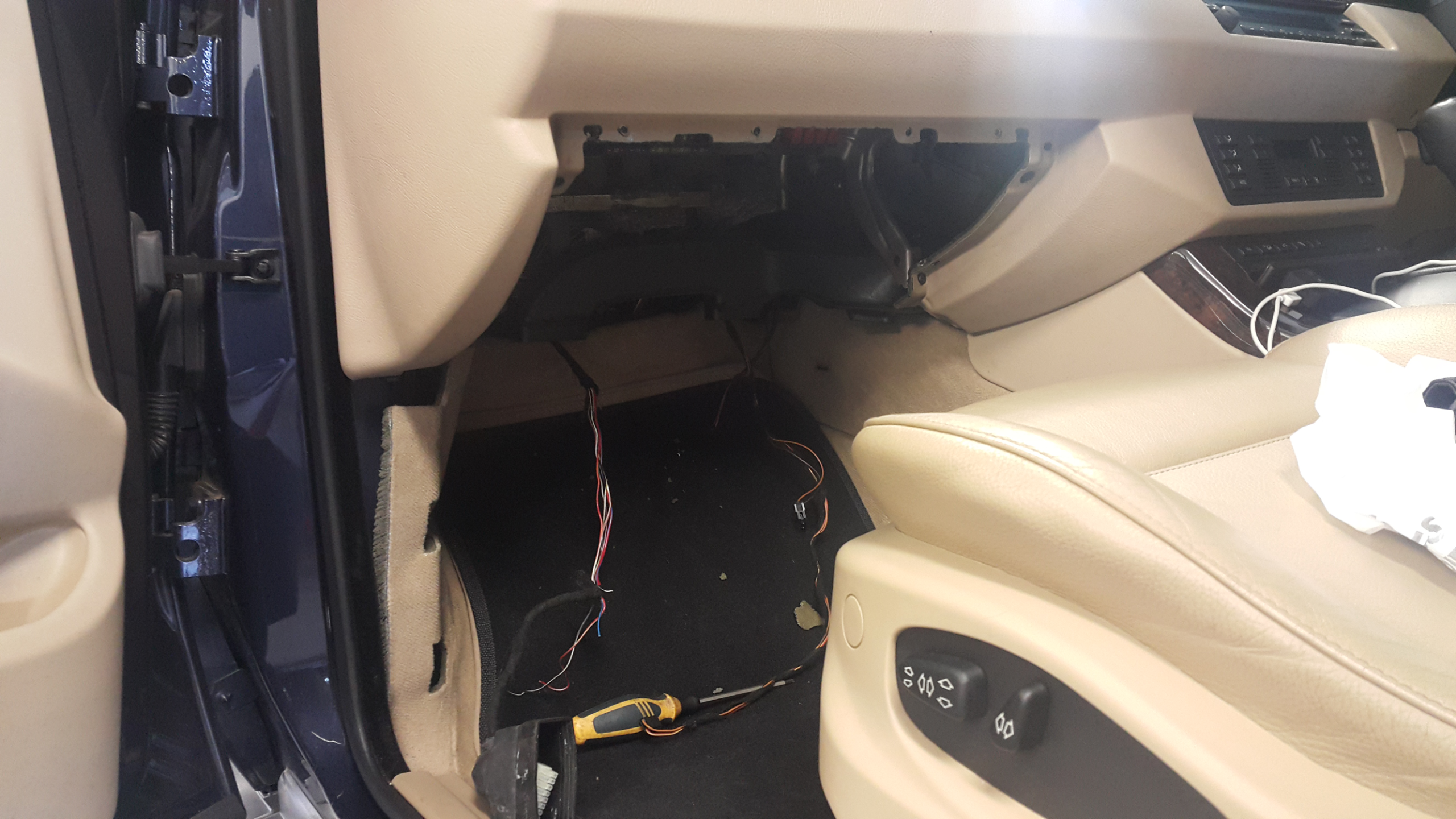

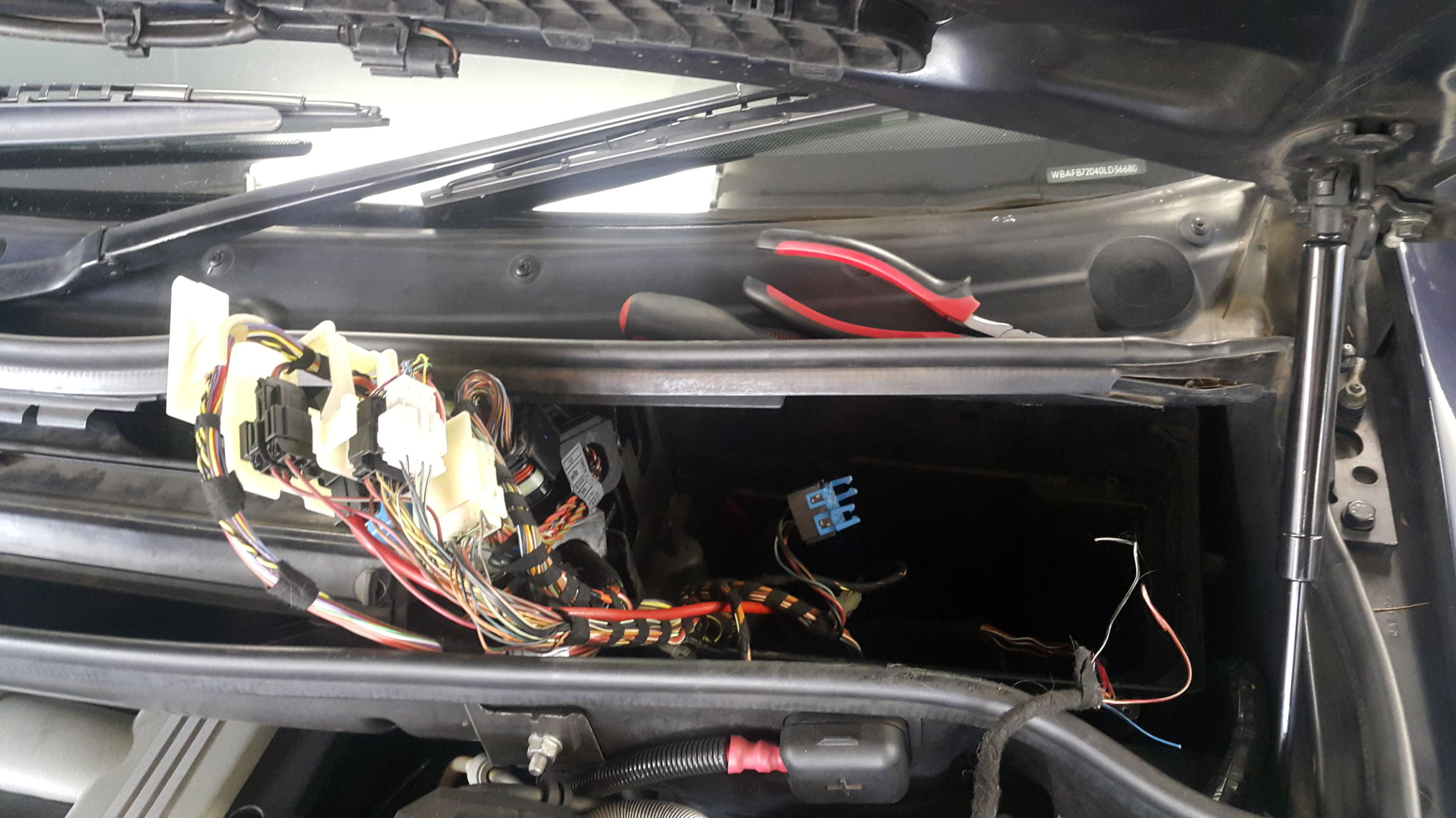

Today i had a chance to get the X to GaragE46 and let Warren work abit of magic.
It started off as pretty much a general look about pointing me in the correct direction and prioritising which maintenance to embark on 1st.

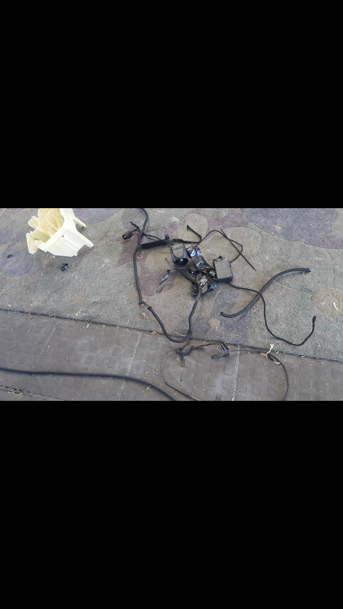

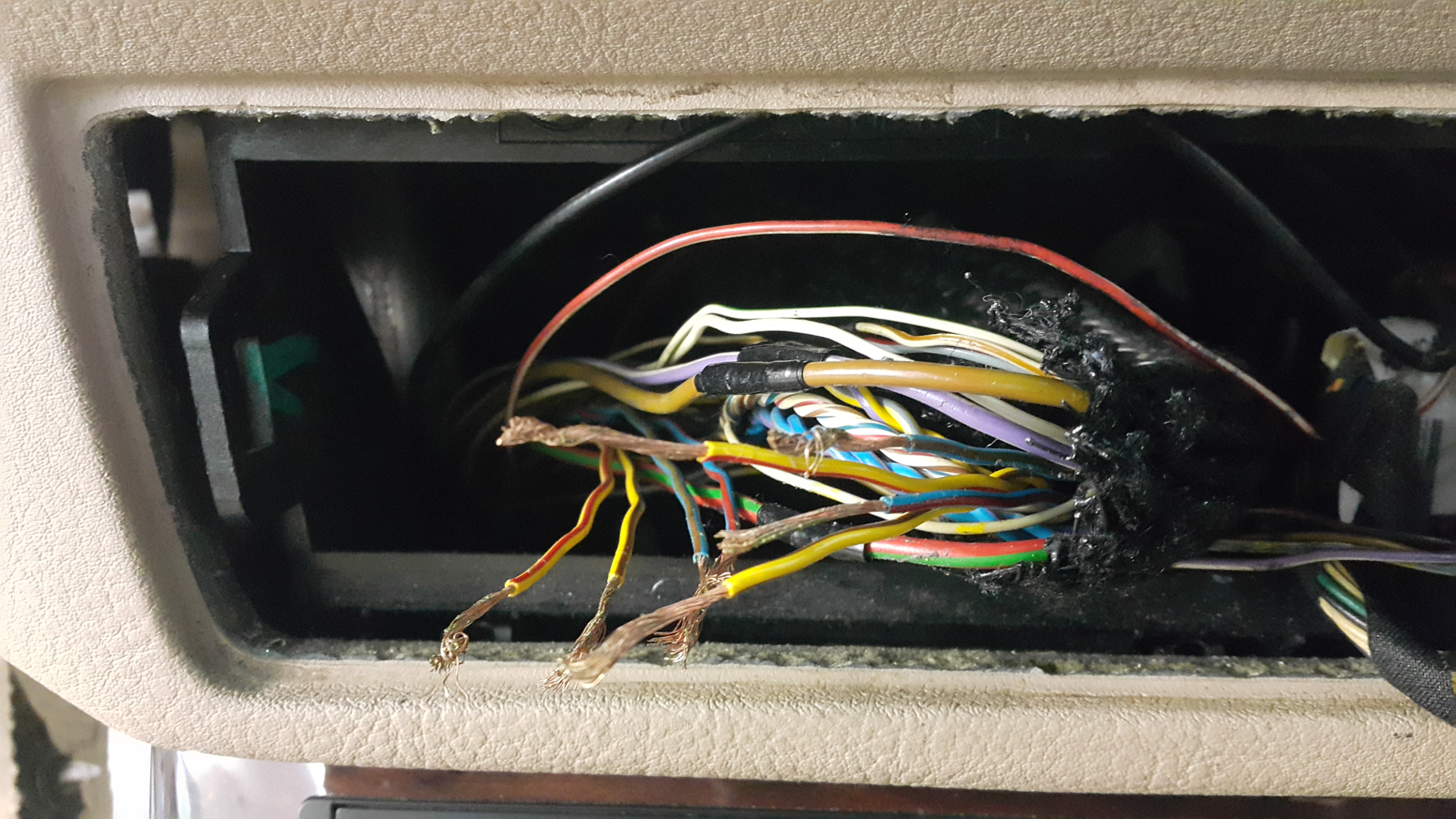

Whilst in that process he noticed whole bunch of hidden wires. Some linked to a tracking unit that wasn't removed correctly, an aftermarket alarm linked to the tracking unit, and an aftermarket Bluetooth unit.
All these were contributing towards the battery drain, so naturally they had to go.
Given the way this battery drain has been an on going headache- electrical work was in order.
Also noticed that the blower fan behind the ecu was broken (tracking unit and harness fitment was the cause), so that was now fixed and working well to keep the important stuff cool.
I was shocked to see how much of invasive wiring gets done for a tracking unit installation. Im just glad its all out now.
The Bluetooth unit was prehistoric and the wiring there was far below sub-standard. Once this was out Warren went on to solder it all back together and have all looking nice and neat.
He also replaced screws and clips that had been broken or gone missing as well as made sure all the earth points were 100%.

Ya, im glad the electricals are now back to oem
The early morning start was sooooo much better today.
Not the sluggish half dying type that had been driving me crazy.
Also the radio used to to cut out for a second every couple of minutes- i just thought old radio- we'll live with it. Thats now gone totally. The red LED under the rearview used to flash quickly for a few seconds after locking- i put it down to a faulty sensor- then when unlocking the alarm would trigger regularly. That too has disappeared. :smilebounce:
I learnt now to never underestimate the amount of damage an aftermarket installation of any sort can have on a car. Just gota be so careful these days coz so many people out there take shortcuts

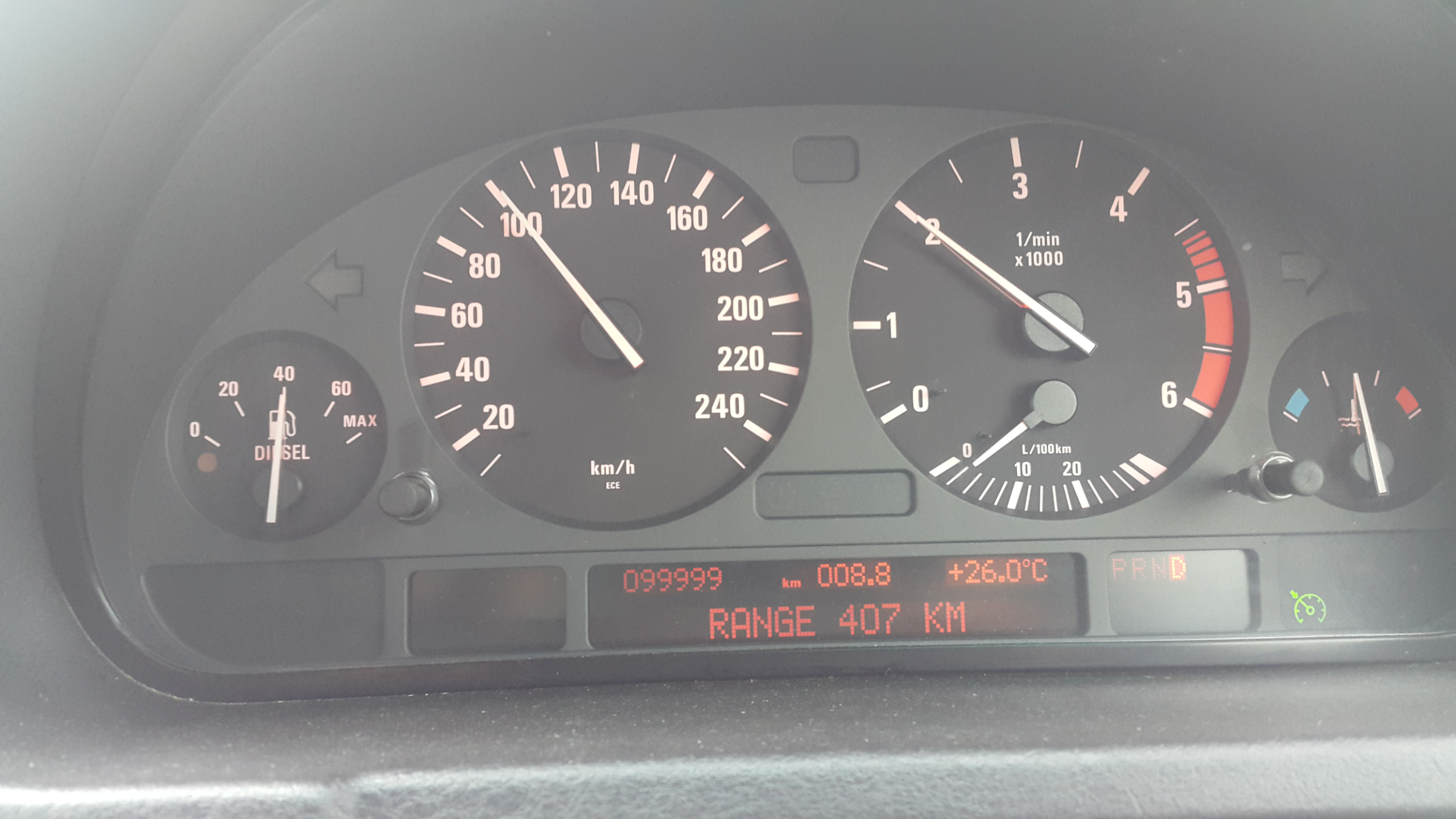

Been a while since i updated this thread...

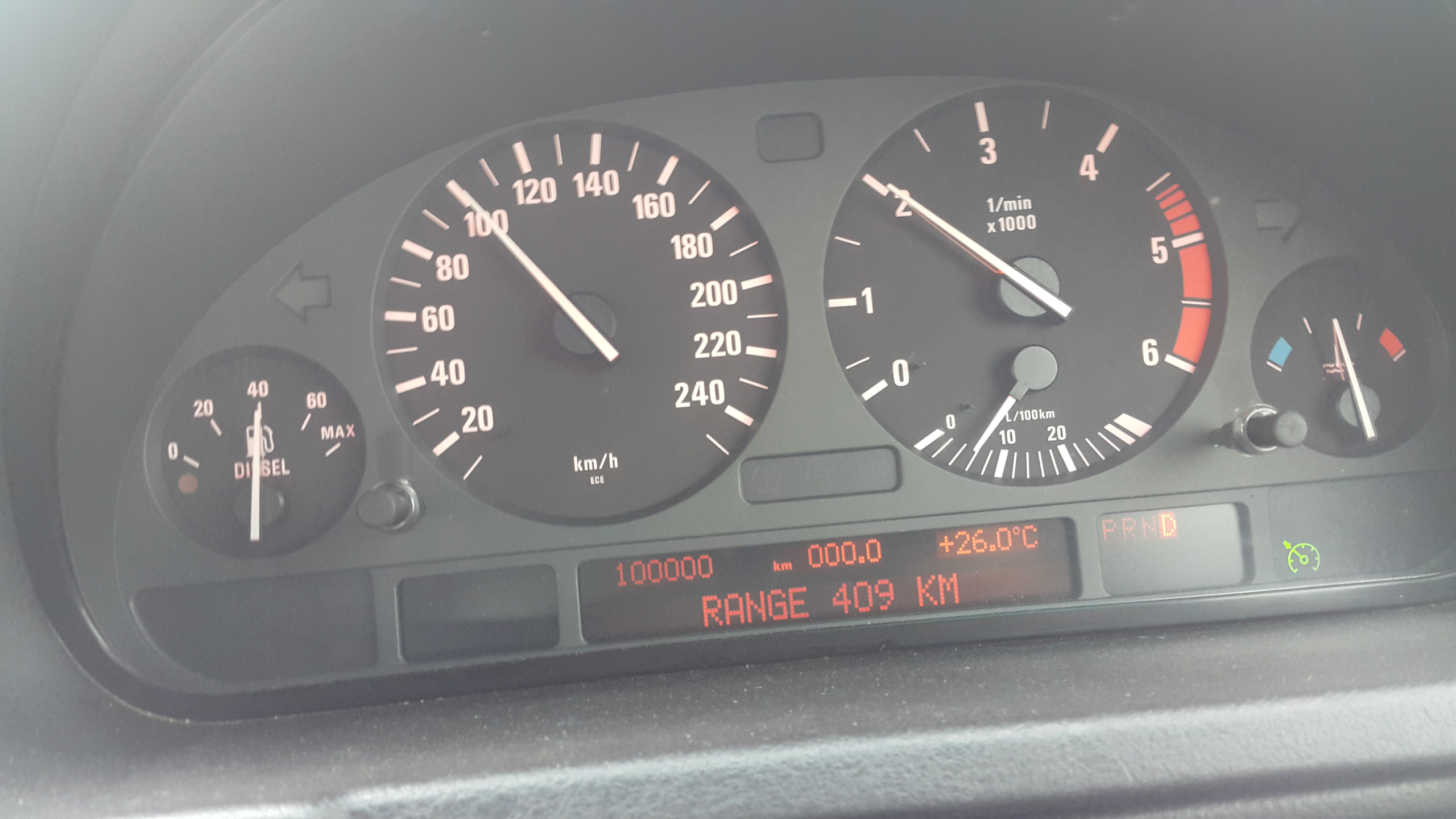

This weekend marked a milage milestone for the X...
Followed by...
